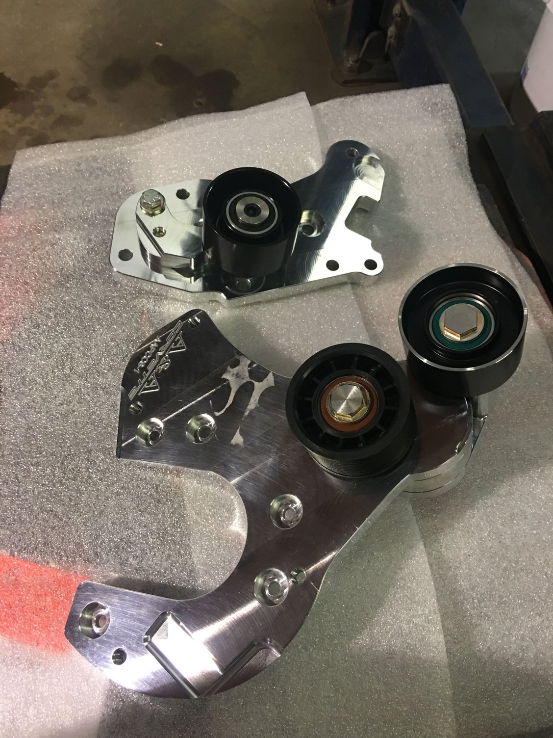

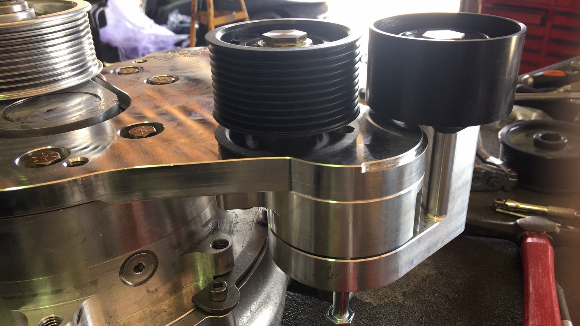

The newer A&A tensioner is really good, you tighten the belt and the release the tensioner. Running a flip drive and 10 rib here and had no belt slip issues, not sure on the boost but maxed out a ZR1 map
Who....your pics do it way more justice then the A&A ones....makes me feel better about paying $1k for it should I go that route.

It makes for easy setup having all of the pulleys on one bracket. I had to mill the back of the blower pulley to get it to line up with the others on the bracket. As with any other bracket belt alignment is key, it may be a pain taking the blower on and off but at the end of the day it's worth it.
