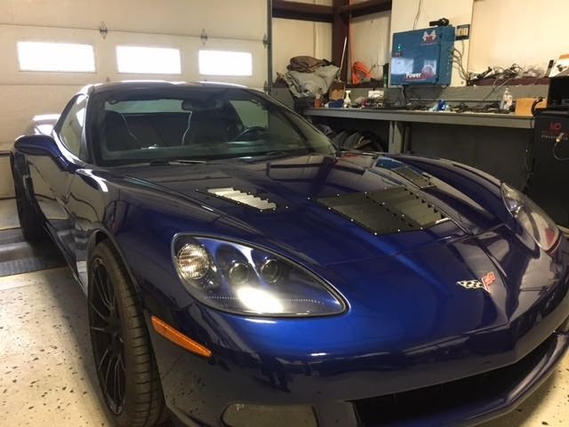

Default My hood vents
Old Apr 7, 2018 | 07:43 PM
itomh's Avatar
itomh
Joined: Dec 2016
Posts: 626
Likes: 118
From: Indianapolis
Originally Posted by BigV
Who did the installation? How long did it take? I live near Chicago so it's no problem for me to drive to Indianapolis get this installed on my Z06
I did the install, not sure if I would be willing to cut someone else’s hood. The center hood vent only takes about 15 minutes to cut, took about 30 minutes to sand and clean cut edges. The side vents took longer as I cut openings smaller and sanded to fit, so may 45 minutes per side vent.
Thanks for the info. I know that I'm not comfortable doing any cutting. Your hood looks great.
Old Apr 16, 2018 | 11:29 AM
itomh's Avatar
itomh
Joined: Dec 2016
Posts: 626
Likes: 118
From: Indianapolis
The center hood vent is real easy and the cuts are very forgiving, I have no doubt that you can do that all day without problems. The side vents were a bit nerving as it allowed as the outer lip had very little wiggle room for errors, the sides have little less then 1/4" to work with. one twitch of the wrist and I would have screwed my hood up. I made my cut on the side vents smaller and did quite a bit of sanding for a tight fit, however, I did have a backup plan. I found another set of side vents that were a little more forgiving as they had a larger lip. They are a smaller version of the Mustang side vents. Personally, I prefer these side vents over the Mustang vents in conjunction with the Camaro hood vent as their shape is close to what I have installed already.

From: Denver Colorado
Originally Posted by high9s
I like the location of the TrackSpec vents. Did you install them yourself? Do you have some pics of the underhood that you could post?
Old Apr 28, 2018 | 02:51 AM
yip's Avatar
yip
Joined: Nov 2016
Posts: 214
Likes: 46
I have the TrackSpec vents combined with shrouding that forces air through the stack. I have an A&A kit that we significantly modified so the intercooler is up against the bumper mesh grill in front of the bumper support. We were having overheating issues in anything above mid 80's but now I've been in 90+ degree weather and the highest temp I've seen is 220 even running it hard for extended periods of time. No more pulling timing or break up at higher temps.
The TrackSpec vents absolutely help but if you have the ability you should shroud around the bumper intake areas and make sure to seal off any open spaces for air to escape and make sure it has to flow through the stack and out the hood.
