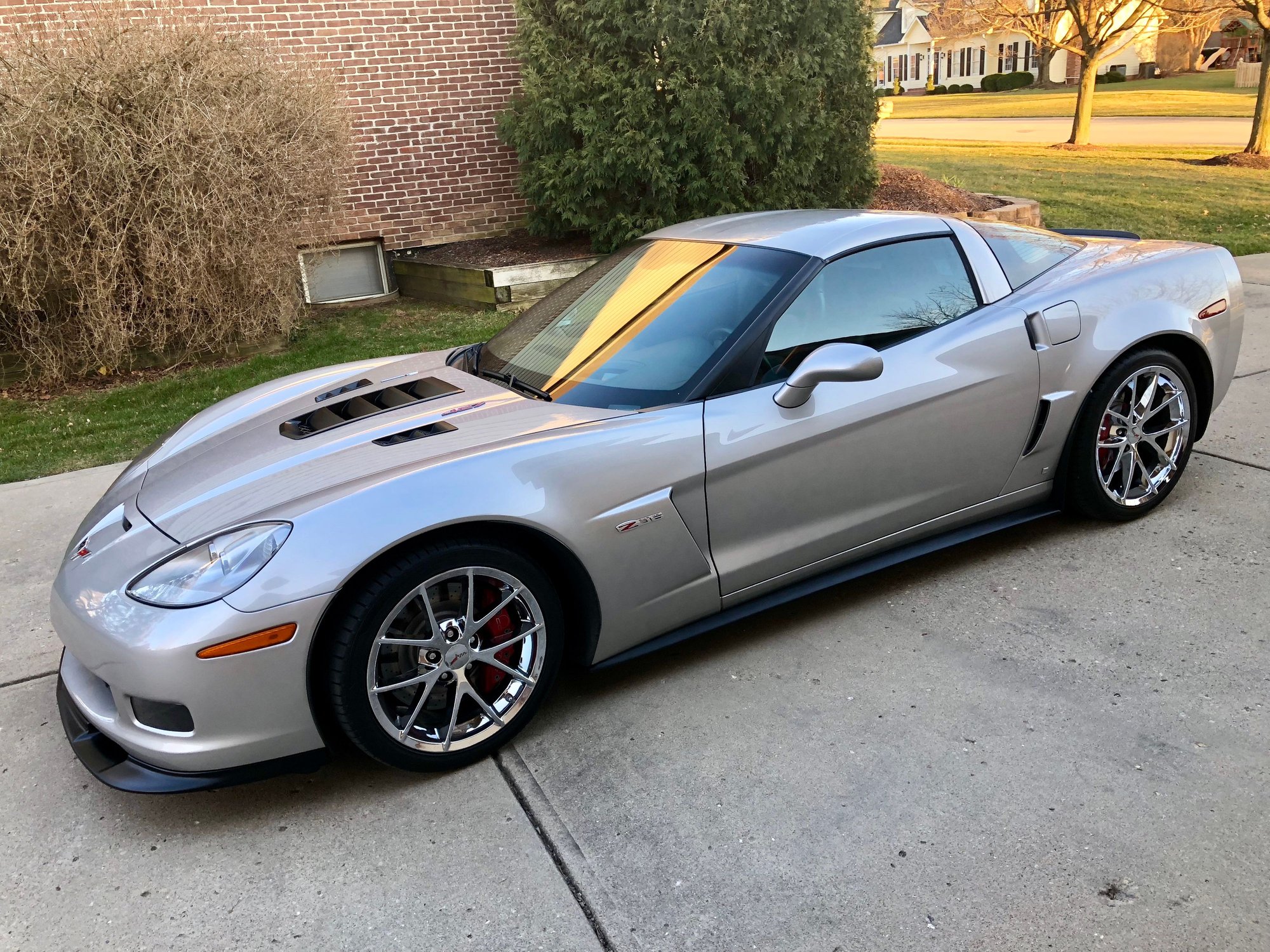

Originally Posted by Sergio7
Woah! Where did you get those side vents!?
Everything you need to know about where I got them, brackets, mounting with plenty of pictures is in the below link.
https://www.corvetteforum.com/forums...placement.html

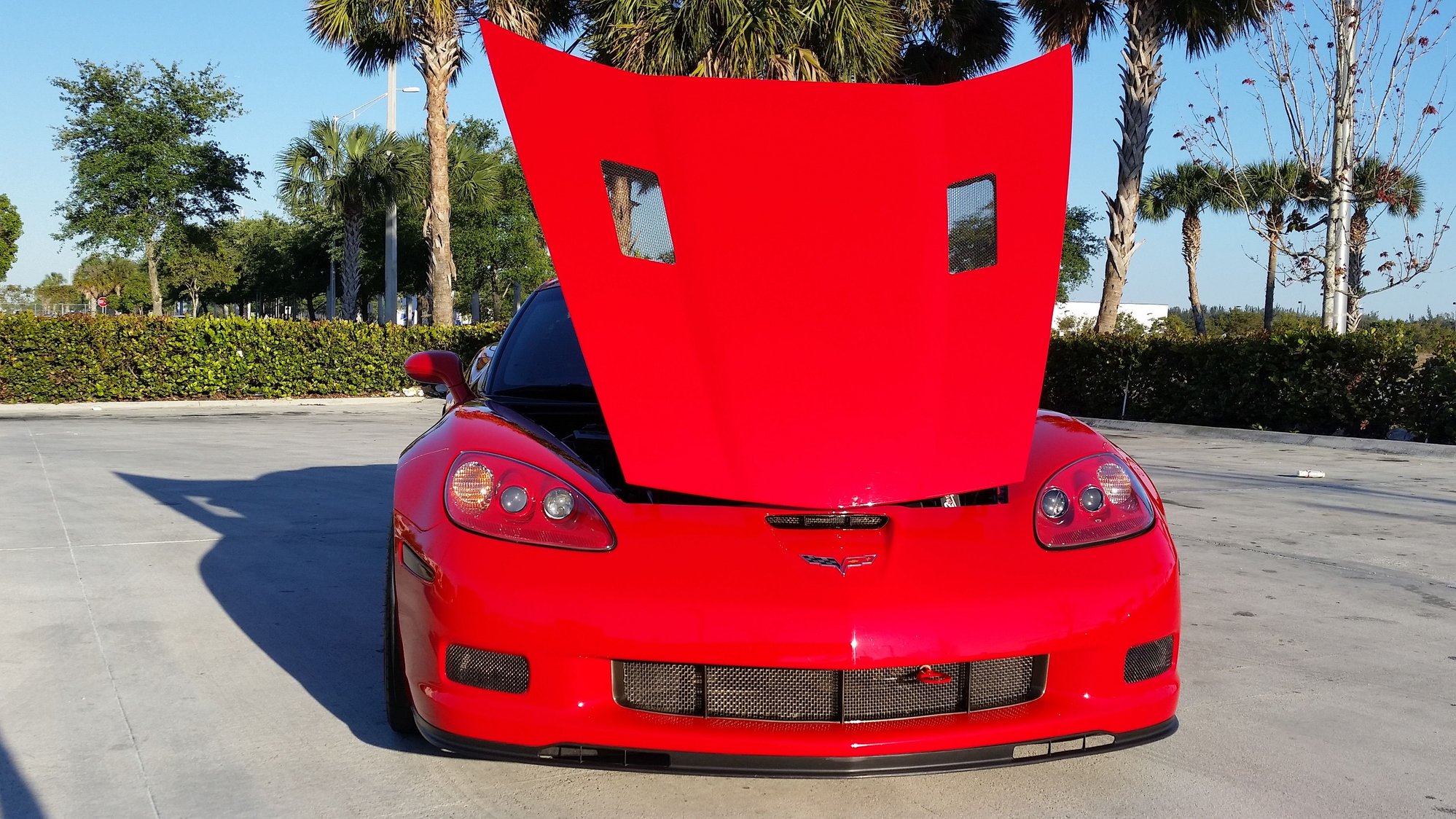

Why not both meth and vents
Square stainless aircraft mesh painted transparent black approx 4 3/4 x 10 1/4 long openings.

Originally Posted by itomh
id like to see this in person, maybe we can meet up this summer once weather breaks
looks great!!
looks great!!
Are you near Indianapolis area? I will be going to the Bloomington Gold Corvette show this this spring.

That was the easy part I used fiber glass resin sense is transparent so it don't even show is there, ones I got the mesh to seat flat all around and marked the boundaries I applied the resin to both the mesh and the hood laid it on there and used deep 1/2 sockets for weights till it dries.
I have sense started using a transparent two parts epoxy which is easier to apply and less **** to run or as bridle I get it at Loews hardware or harbor flake.
https://www.harborfreight.com/super-...oxy-92665.html
