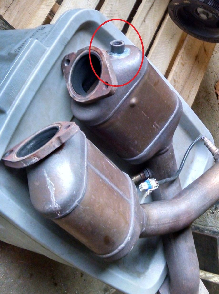

What are there any other options to hookup a temporary wideband to the stock exhaust besides dropping the passengers side cat and weld a bung.......the reason I asking is because I will have the header set in tomorrow and trying to avoid as much abuse to my body before I get surgery lol ....thanks

You could pull one of the front O2 sensors out and replace it with the wideband temporarily and run the car in open loop. Not ideal but I'm sure worse has been done. The correct way would be like you said, to add another bung pre-cat and use that for the wideband

I was afraid you would say that....weld the bung it is then lol.... I will weld in this location

Yeah, that's where I added one on mine
On the LS7 manifolds I was able to get an exhaust shop to do it in like 30 minutes without removing anything from the car. $25 later I was glad I didn't try to do it myself
I have a feeling it might not be doable on the LS2/3 stuff though, I can't remember exactly how it looks assembled. It's worth a look though to see if it's a possibility before pulling it apart IMO

That section on the ls3 is towards the rear under neat everything so it must be dropped. Oh well someone has to do it.....poor me lol
