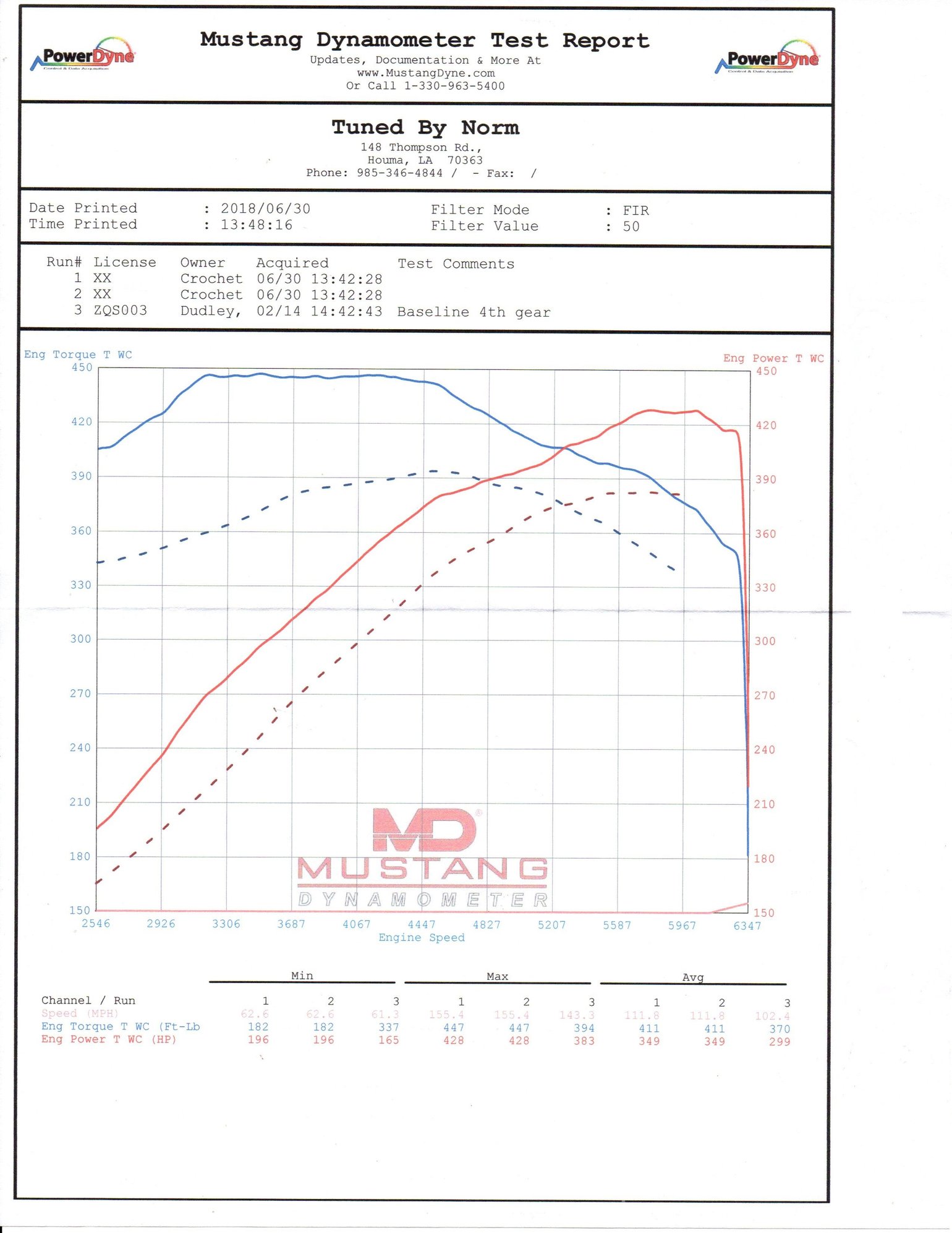

E-force install with disappointing results, I installed the 1590 kit canned tune on a 2011 ls3 auto about 3 months ago and posted in a few threads that I was not impressed with the system with the few spins I have done with it. I had ordered the 3.50 pulley at the same time knowing I would upgrade to the z06 fuel pump and do the pulley swap. I have completed the z06 fuel pump and did the pulley swap and then the same results (disappointing). I may have driven the car a 100 miles or so since the install then decided to find out if I was correct on the low output. I booked a dyno day with no A/F pulls from a local tuner who I know very little about but it would confirm my suspicion that it would be low and it did. Having said that now I am searching to find out where the problem is. I contacted Edelbrock today to verify I was sent the correct tune and we are in the process of doing that but may be delayed till after the holiday because according to Edelbrock they must send the files to SCT to decode the tune to a format that Edelbrock can read. The tech asked if I changed the belt to a Continental Elite 4061020 1" smaller as he think that it maybe belt slippage. I remember reading post on the forum that the smaller belt was only needed when dropping down below a 3.5 pulley. I did check that the bypass was not dumping under throttle and seems to be working from a visible inspection. The turner said it may be clogged cats or knock pulling timing but there are no codes and fresh 93 from the pump swap so I am kinda lost on this one, It looks like there are no belts in my area so I will have to purchase one online. Next I will data log using the SCT-4X programmer that may help. Any diagnostic suggestions appreciated.

You are correct KR will not throw a code and just pull timing. I have a hp tuner pro and a AEM 30-4100 but I am waiting on Edelbrock to confirm the calibration that was sent to me was correct. When I was speaking to the calibration tech about the process used to load the file he stopped me and said I should not have needed to go through all the steps I did. I was telling him I had to input corvette ls3, axle ratio 2:73 and auto so he was confused as to why I need to do the extra steps. I then sent him the original calibration emailed to me and the three files saved on the SCT after I loaded and flashed the ecm. Next if the calibration comes back ok them I will log using the hp tuner and wideband. The canned tune was to hold me over till I get everything I want done like swap injectors, cam and headers. So first I need to find the source of the problem I have now.

Yeah, something is definitely wrong there. But the only how anyone could do anything more than guess at what the problem is would be if you did a datalog, including an AFR reading with your wideband. Without knowing what your boost curve looks like, it would be next to impossible to know whether your belt is slipping. Same goes for KR - you need a datalog to know if and to what extent it’s pulling timing, although if your car was getting significant knock, you should hear it. If your cats were clogged, you would typically have an unusually high boost reading. I would bet it’s pig rich and has low ignition timing, but again, that’s just a guess.

Myself and the Edelbrock tech are curious if the correct tune was sent to me. If I compare it to the stock 12 gs I have the 11 gs e-force has a bit more grunt off the line from the added torque but from 2nd to 3rd I am beginning to wonder if the stock gs will pull away from there. lol
