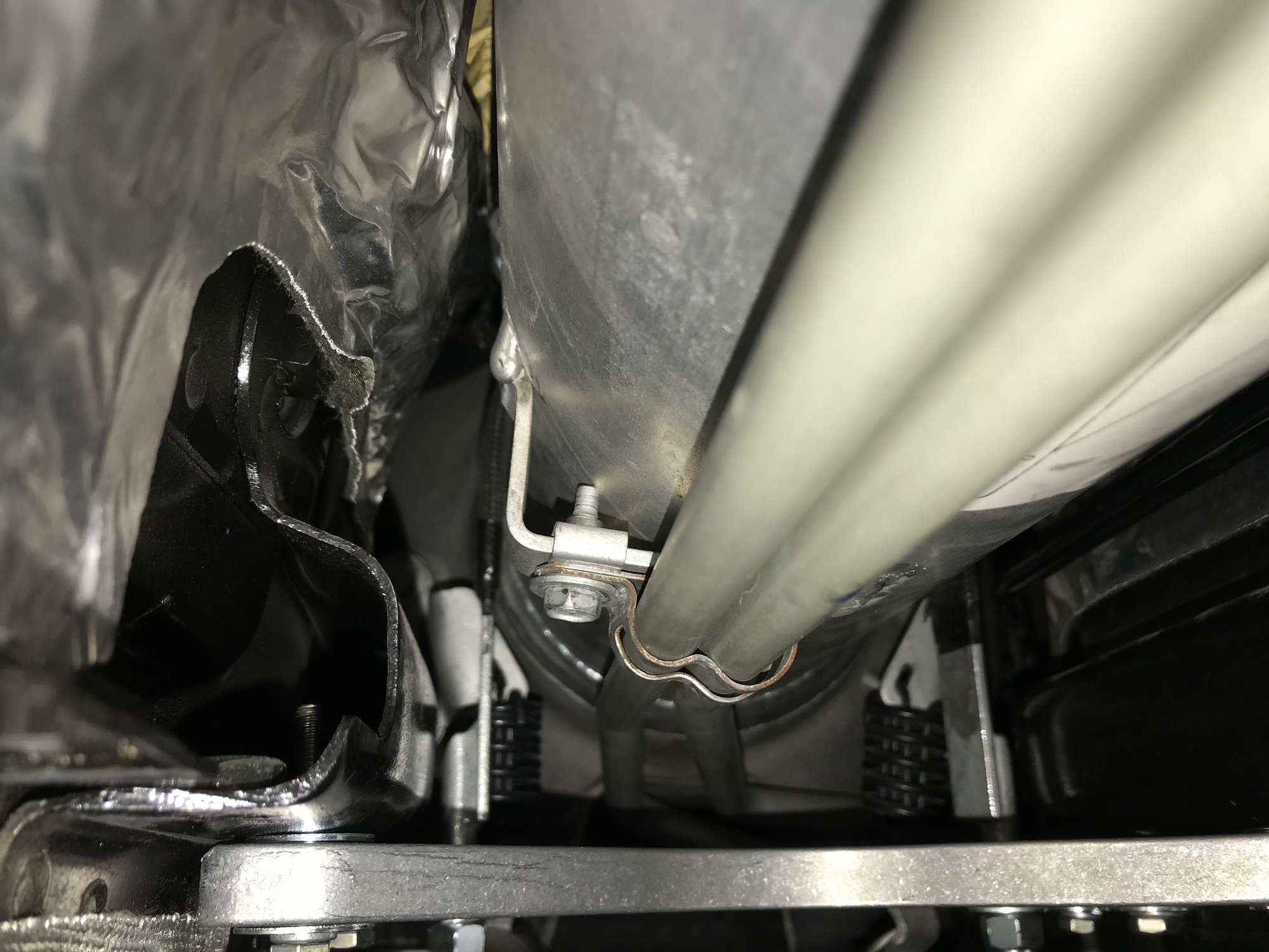

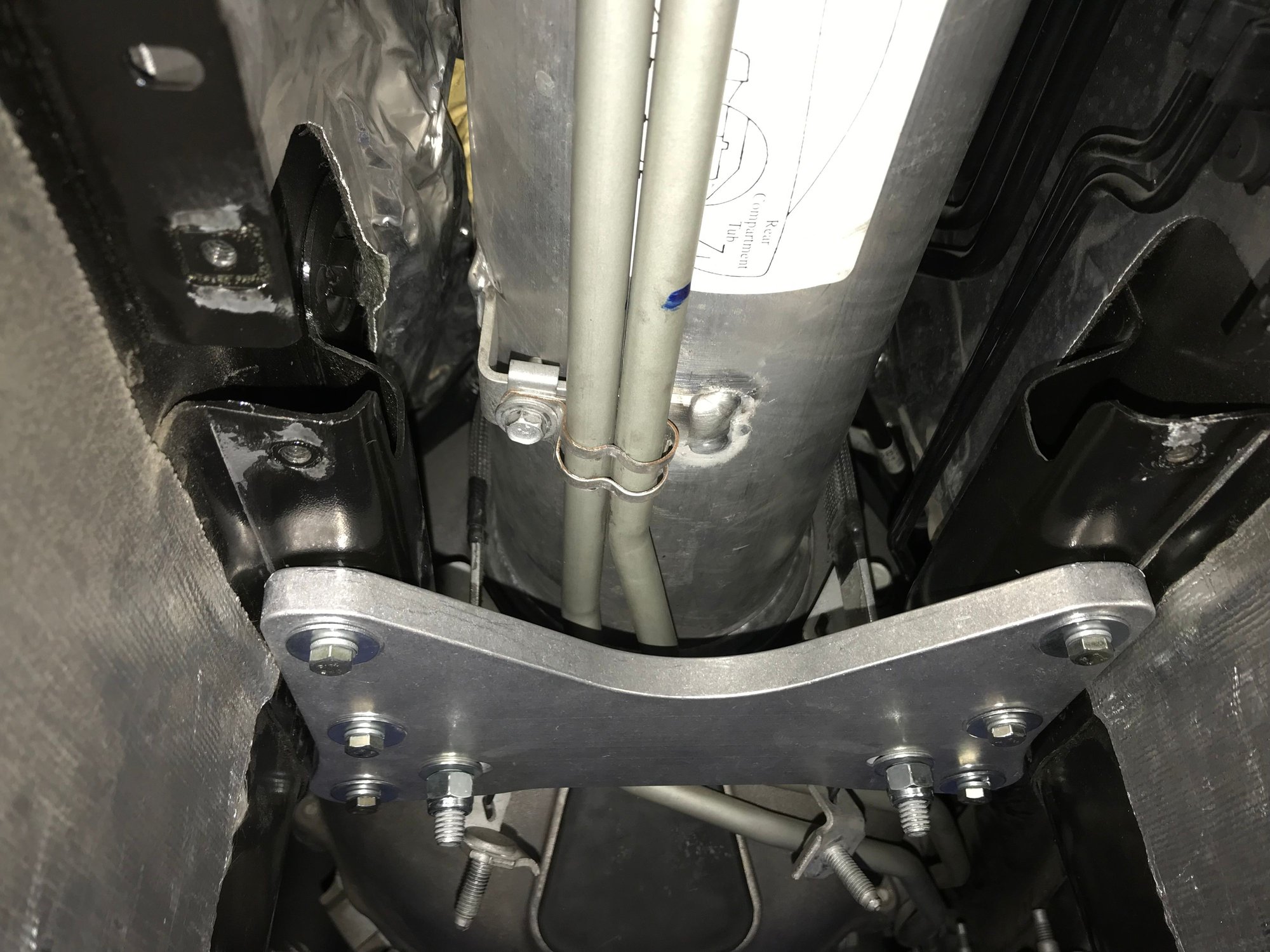

Some pictures of where I had to cut and it re-installed. Mine is installed ON TOP of the existing tunnel plate per ECS direction and uses longer bolts and some (3) washers between the tamer bracket and the newly added river nuts that I drilled and put into the tunnel lip, also per ECS direction. All looks and feels solid. Still had to shave the top corners of the tamer plate to avoid interference with the tunnel part of the car, but it's solid. The self locking nuts are barely on to the Teflon, but should be ok... hoping Doug or someone can chime in on that. I did not want to over tighten. Between the added spaces from the camper tape for the strap and the mounting on top of the stock tunnel plate, the threads really should be another 1/2" longer.

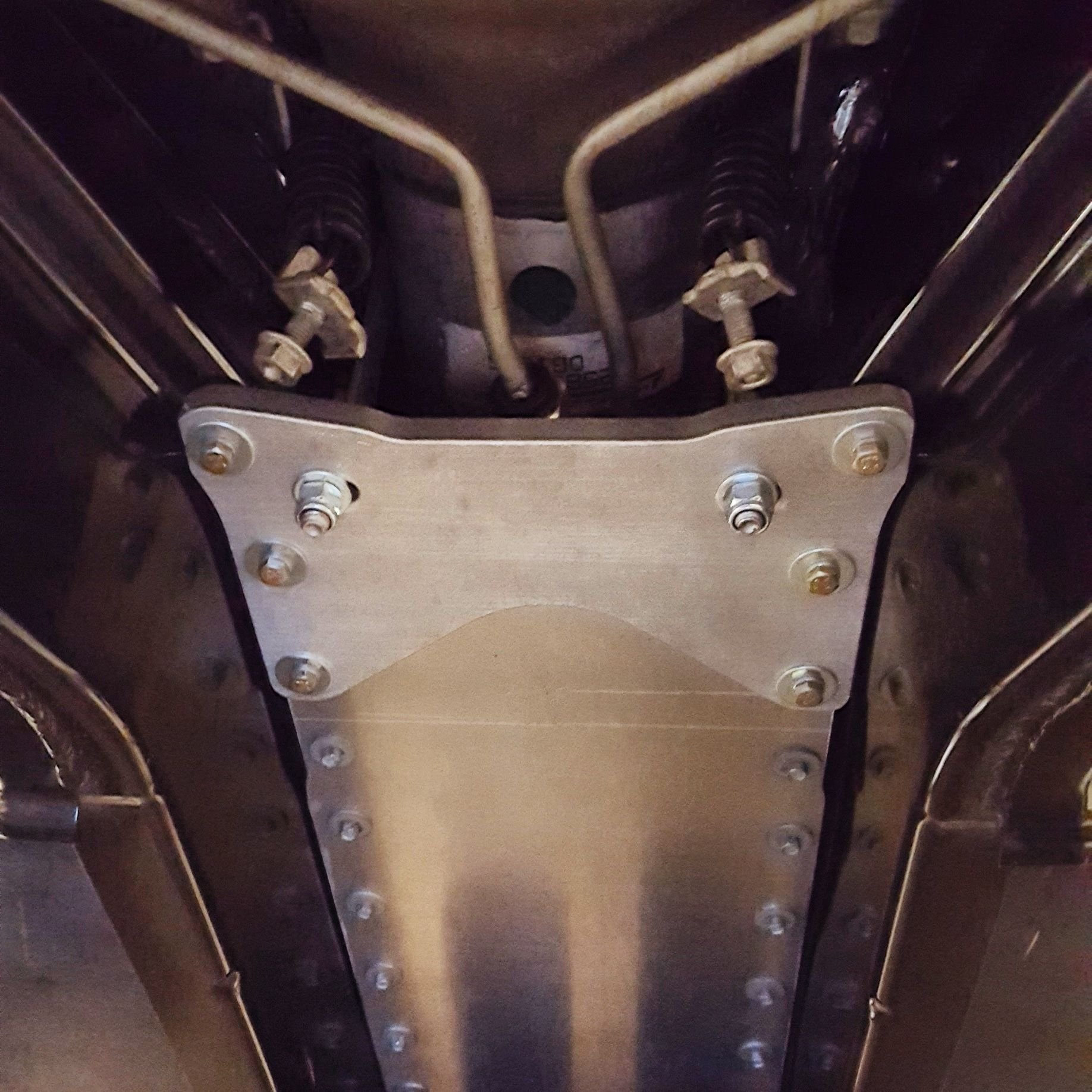

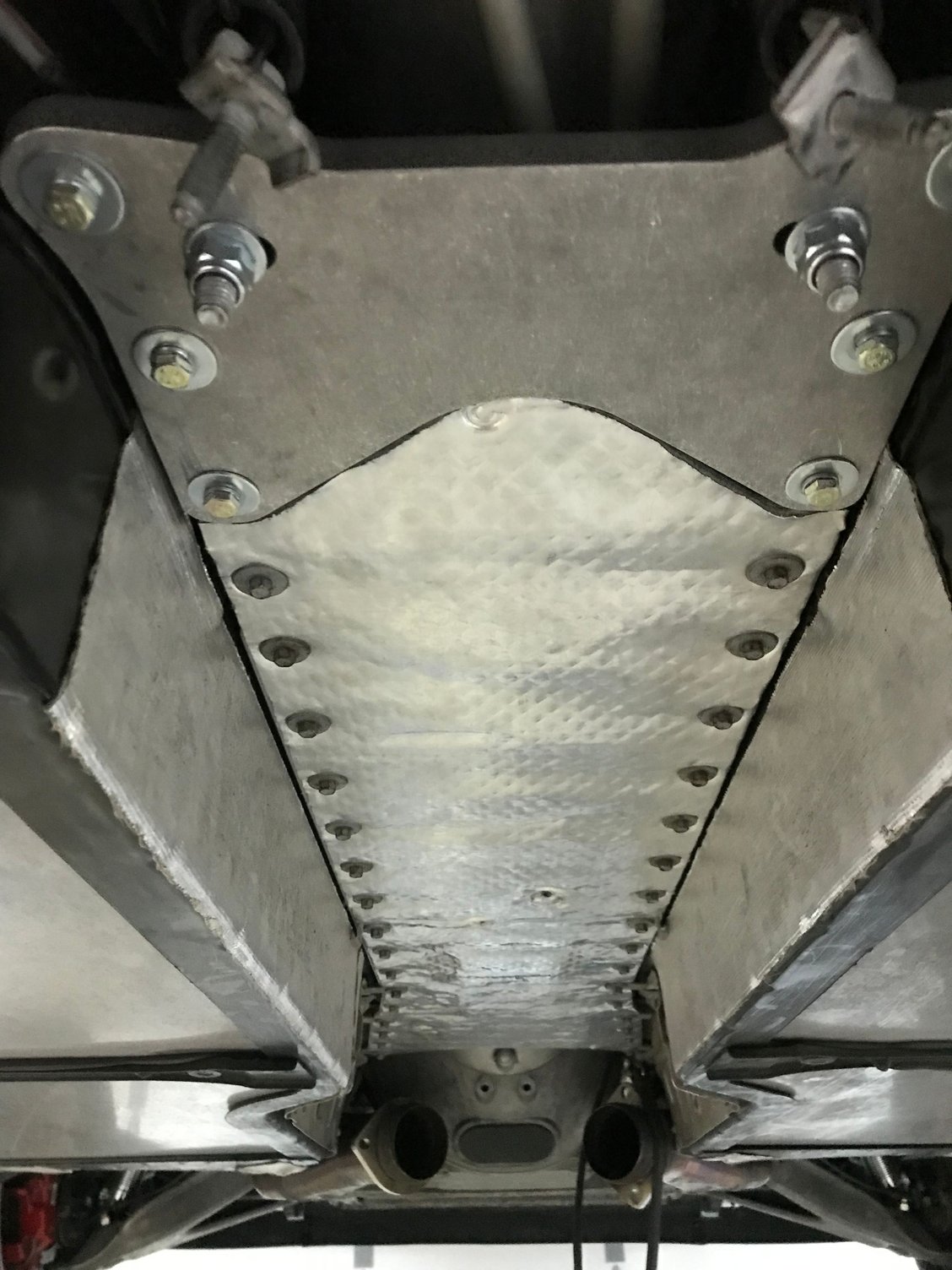

Finally got my torque tamer from UPS on Friday. It appears to be the same older version as the others posted on here.
It wasn’t as straightforward as I would’ve liked it, and even though it fit decently into the frame on my car, I still had to chamfer the corners on the top side to get it to sit as flat as possible on the frame of the car.

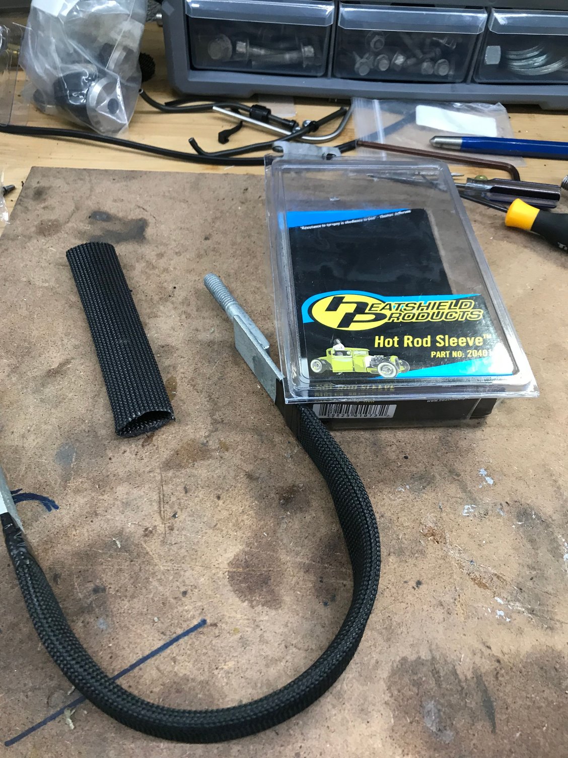

I wanted to insulate the strap from the tube to cut down on some of the noise being transmitted into the car, but after trying to glue a strip of rubber to the inside of the strap and making a total mess, I abandoned that and instead used some some high abrasion thermal insulation sleeve I slipped that over the strap and used electrical tape to secure it in place. Hopefully that holds up. I simply snugged the strap down onto the torque tube and then backed each bolt off about a 1/4 turn.
Below are some pictures of the install. Got it all buttoned up tonight and everything fits without any interference with the exhaust hangers etc.
Here’s the kit. There were no instructions with it, so I just used the ones off the ECS website.
Here’s what I used as a form of insulation between the strap and the torque tube. This stuff is pretty abrasion resistant and should cut down slightly on noise being transmitted, hopefully.
VERY IMPORTANT: On the A6 cars, the transmission harness is clipped onto the top of the torque tube and is barely visible. I simply slid the harness up and out of the clip and rotated the strap up and around the tube underneath the harness. You have to do this or the strap will go over the harness and when you tighten it down, it will bear down on the harness and mash it against the tube. No bueno.
Here’s the chamfer that I put on my plate to get it to sit flatter. This is necessary because the corner of the frame that the plate sits into is rounded.
This is after I had drilled the rearmost holes and installed the threaded inserts. In my view, those rearmost holes need to be slightly more outboard so the the holes aren’t so close to the corner/edge of the frame bracket that you have to drill into.
This is after I had reinstalled the exhaust hangers. Removing them is necessary in order to make space to get the strap rotated up and over the torque tube. By doing this, I avoided having to drop the cradle down and just took my time and carefully worked the strap up over the tube at an angle at first and then it literally fell into place.
I used on washer as a shim on each bolt above the plate. It sits perfectly flat and solid like that.
I used the Torque Tamer plate as a template and scribed a line on the backside of the Elite Thermo Abs plate and then used a jigsaw to cut the end of the plate with the same contoured “V” shape as the TT plate, rather than simply cutting 4” off straight across the plate as per ECS; instructions. Looks much better that way and keeps more exhaust heat out of the tunnel too.

It may have also helped that I wrapped the hoop with the Hot Rod Sleeve as well.
