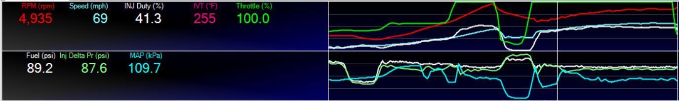

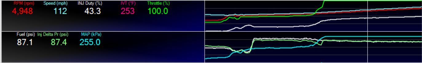

Here is a snip it of a data log. You can see the light blue MAP line not keeping up with the WOT green line. I am not seeing any signs of belt dust so I don't think it is slipping. The belt is new and I am running a Kong HD tensioner.
I checked the tune and P0107 is not disabled and the high voltage test is enabled.
Snip it from a prior log

Originally Posted by Rokket
Snippets dont help, but see what I was saying about hitting the hard top of 255 KPA. You can override the table to say 355KPA plus. I dont think the OP is killing MAP sensors as much as the tune is reaching the top end of its glass top it has pre-set.
Old Sep 28, 2020 | 06:25 PM
Rokket's Avatar
Rokket
Joined: Sep 2012
Posts: 884
Likes: 301
From: KCMO
I posted the snippet to show what the failing(?) map line looked like vs before in case someone else has a datalog showing the same. I was not aware the kpa could be raised passed 255kpa via tweaking HPT. I'll let the tuner (hopefully) fix that once I get it back on the road.
