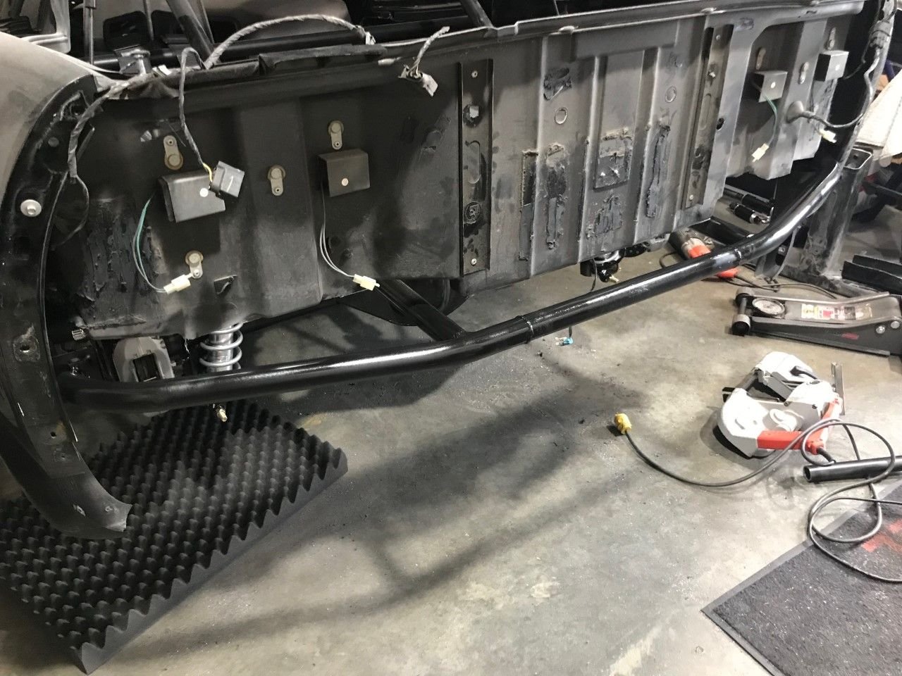

Progress is going to continue to be slow for a while. holidays and such. Got a lot going on right now.
Should be bringing the engine home next week.
It happened Hoping its a good bit lighter now, before this I was at 2,485 after swapping from twins to the single turbo but the 15 gal cell was full.
The frame notches alone came in at 7lbs. The whole rear bar assembly was pretty heavy compared to what I made, plus you add in all the other little stuff that was removed, foam bar, brackets, cubbies, etc. I welded the bumper/quarter support where the rear bumper bolts on straight to my bar vs how its attached stock via another bracket to the tub. Also the last pic doesn't show it, but I made tabs that come up from my bar to the metal strips on the tub to hold it in place.
Oh wow, that's more than i thought you cut out. Definitely some weight there. I plan to run the Nine Lives Racing wing for some traction help so I can't cut that out without fabbing up a different mount and i don't want to do that.
I hope to be in the 24XXlb range all said and done.

I'm not scared of the saw! Just started on the front to make a similiar bar, I want to be under 2,400 with recent mods.
Not sure what nine lives wing is, but no wing needed for traction if you are going 4 link. Maybe an extended drag wing for stability if going near 200, but otherwise its pretty stable. Might need a shock and bar adjustment between street and track for optimal traction but that only takes a minute.

Turns out the weight added up and it's almost a Honda now! I was moving my fuel cell this weekend so I finally had a chance to weigh it without a full tank. She's sitting about 2,200 lbs with a 55/45 split after the front and rear tubular bars, lexan windshield, motor plate, and some other small changes.
I think this is the tipping point where you can either go cray and spend a bunch of money chasing weight, or just leave it alone.
