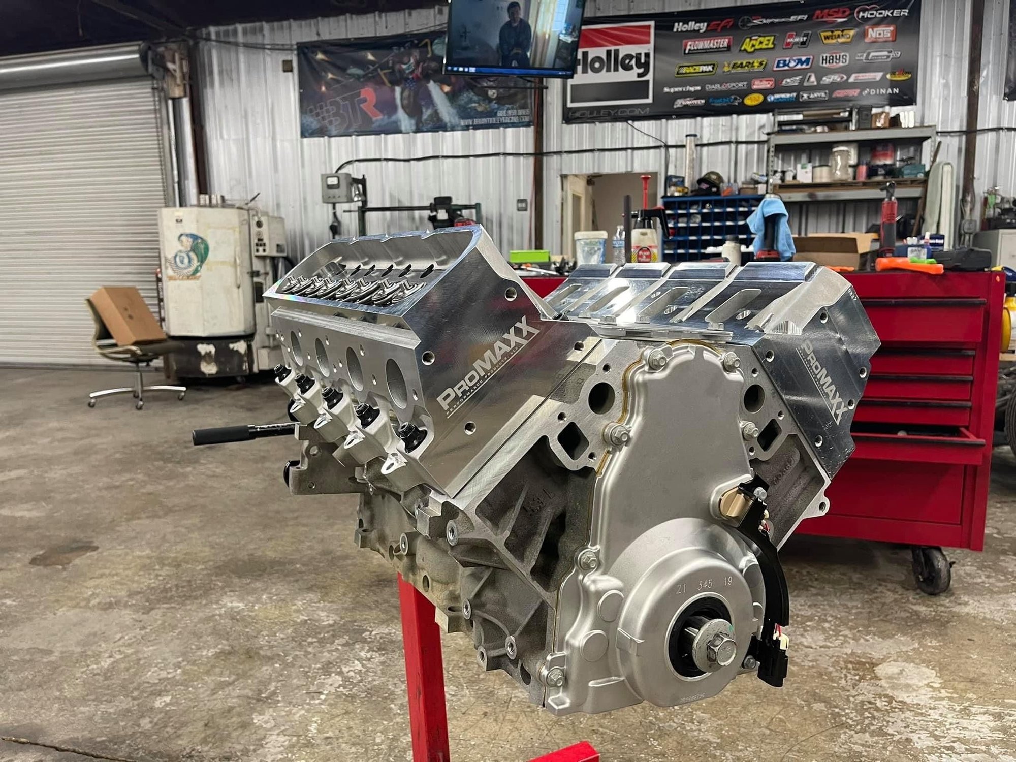

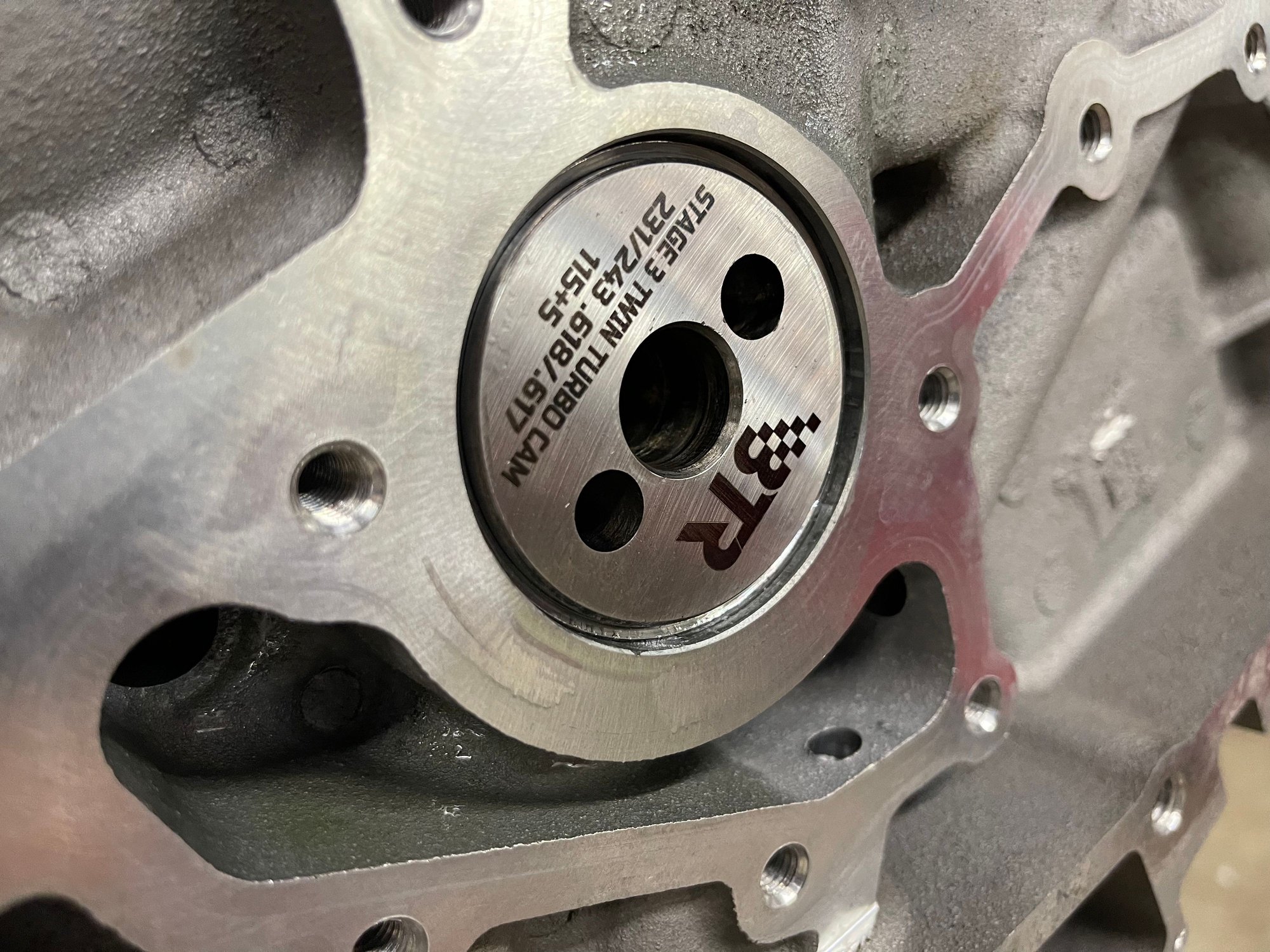

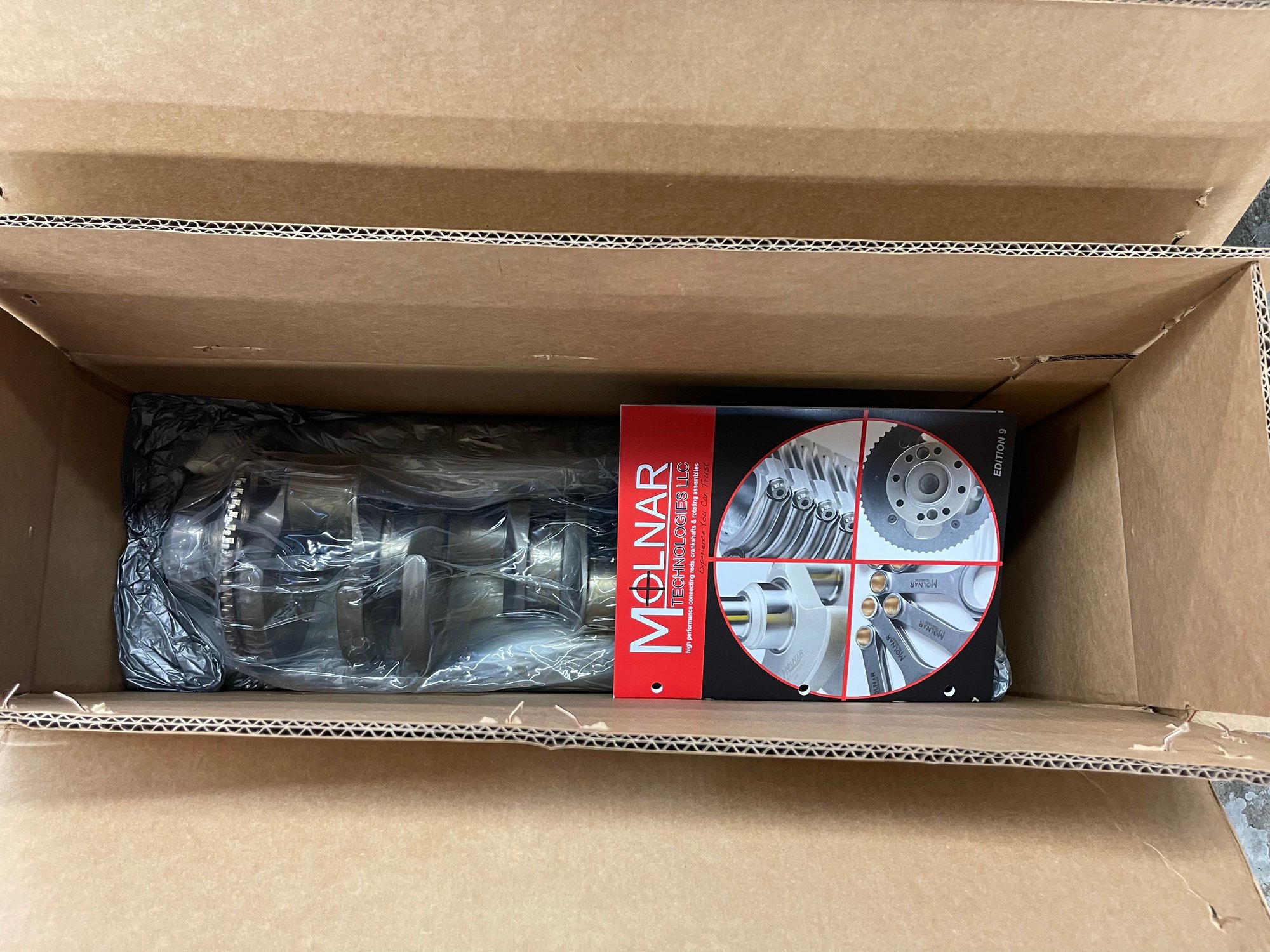

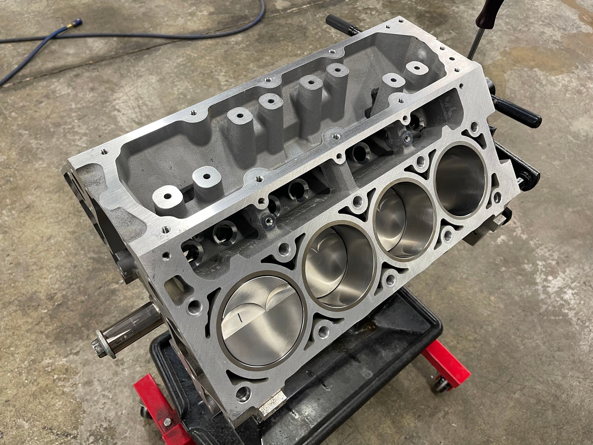

New car. New build. New thread.
Many of you followed my previous journey; transforming my '08 Z06 from a semi-budget SBE 5.3 single turbo car that made 1050whp, to a wild built 5.3 TT animal that made over 1500whp(est).
I ended up parting that build out and selling the roller to take a step back, purchase a house, and pursue other things for a little while....
Wellllll........ That didn't last long. I ended up purchasing an '05 base roller, from a buddy of mine, earlier this year. It sat in storage for a while, waiting until
we finally got moved over to our house. Now that that's out of the way, it's time to start working on this new build.
This one is going to get a little more wild than the last one.
The basic run down is...
Engine:
Aluminum 5.3 - Stock block/sleeves
Molnar crank
3.800" Wiseco pistons
Molnar Power Adder rods
ARP 1/2" studs and main bolts
BTR Stage 3 TT cam
BTR .680 spring kit
Promaxx 240cc rectangular heads
Builder's custom headgaskets
BTR Trinity Intake
Power Adder:
Custom TT kit that I plan to build
Xona Rotor 115-69S turbos
Shrear Fab or NCC A2W intercooler
Other:
Holley Dominator
Holley 7" dash
Engine mounted powerglide with transbrake
8.8 or 9" solid rear axle
Aeromotive 7gpm brushless pump
Definitely a lot of little odds and ends that will be scattered in there. Everything but the engine/engine management is subject to change until it's mounted in it's final resting place.
I won't be doing another build like this, so I plan to go as wild as my wallet will allow me too. I don't have any ultimate power goals. I will run as much as I can, traction willing, depending on what I am doing with the car. Trying to travel to events with the car, maybe a drag week or something. Really, just enjoy it once it's done. Hopefully it doesn't break as much as the last setup.
Sit back and enjoy. Progress won't be very fast. I'm in no rush to complete it but I am shooting for this time next year.

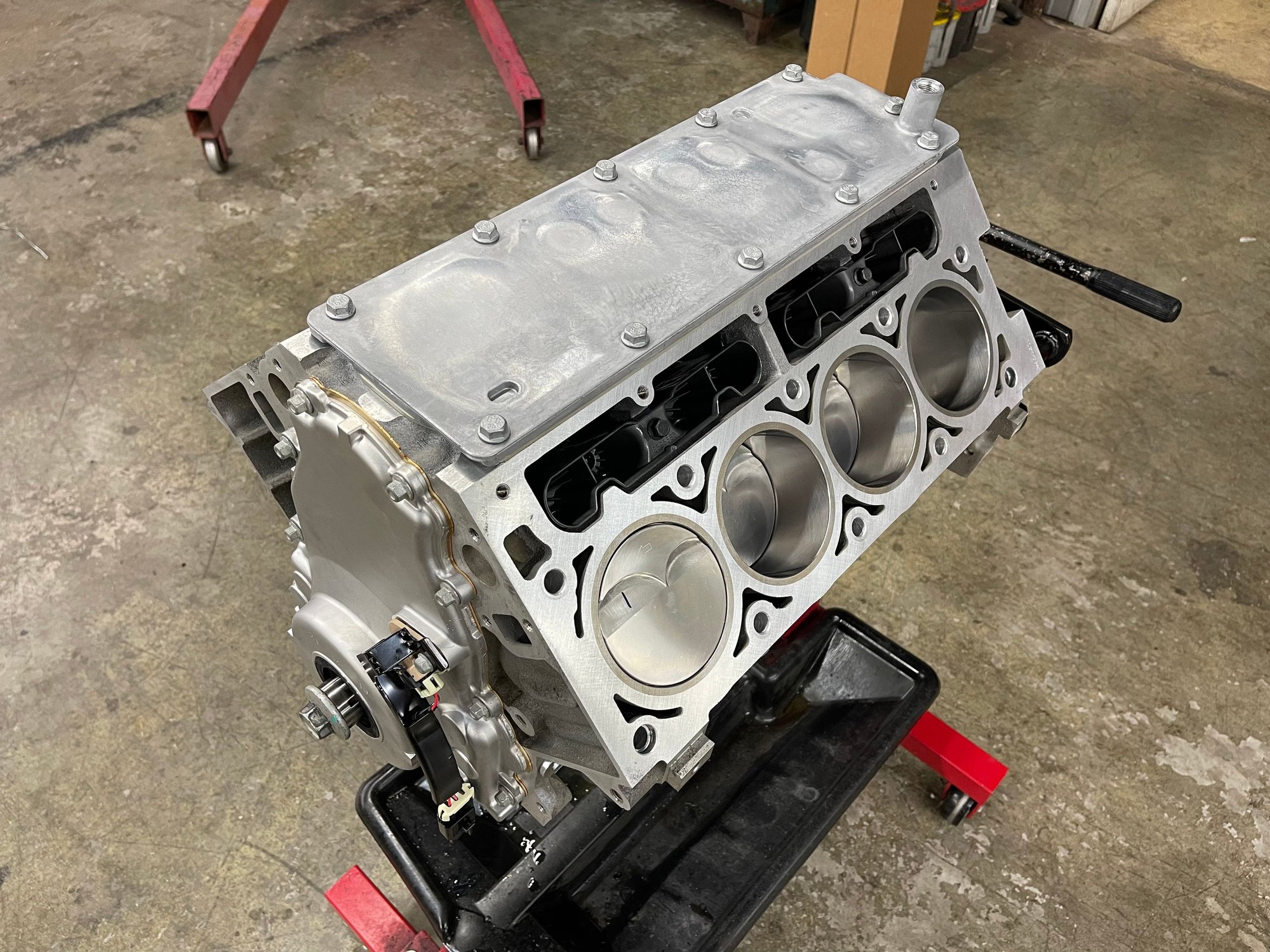

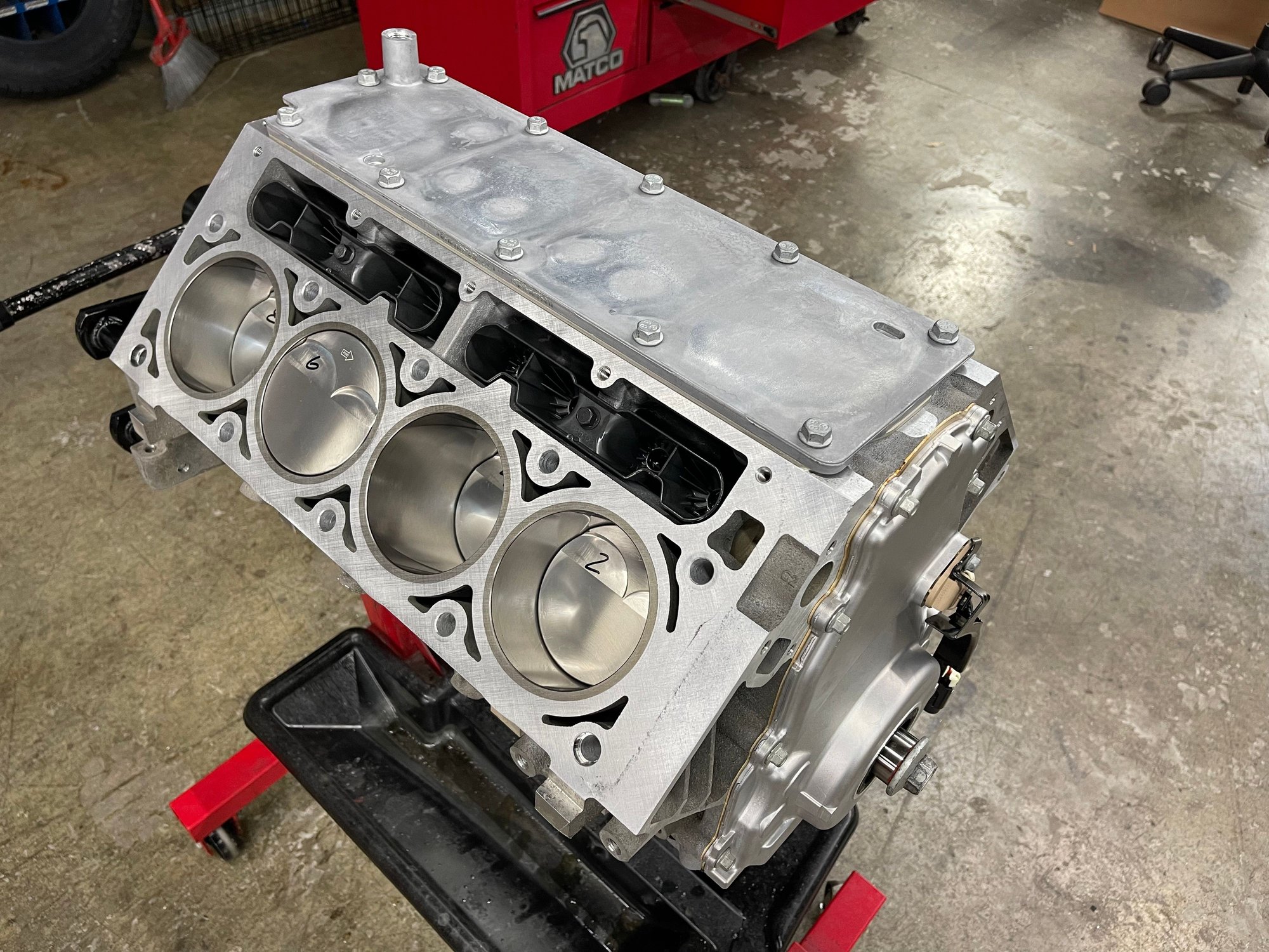

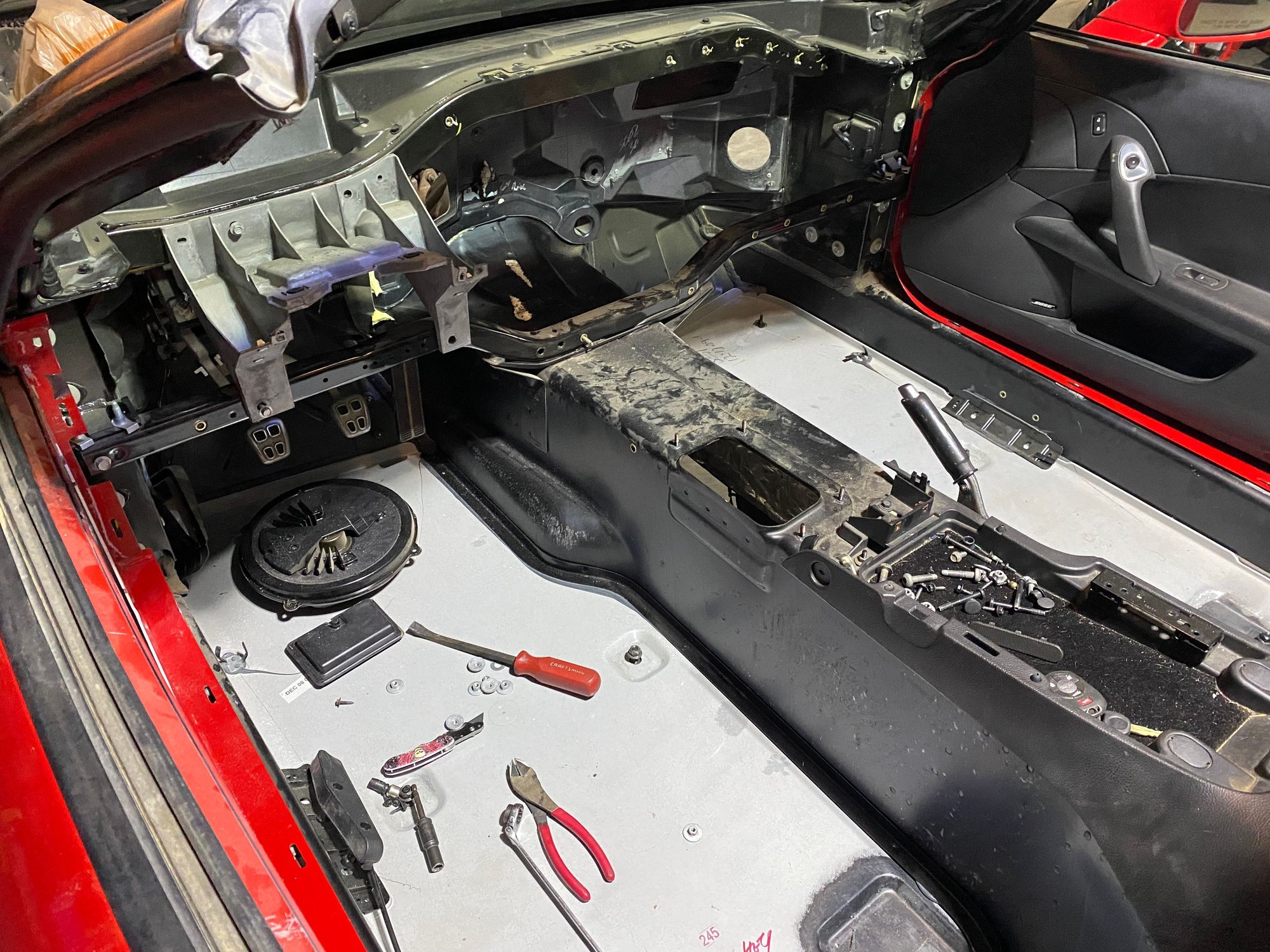

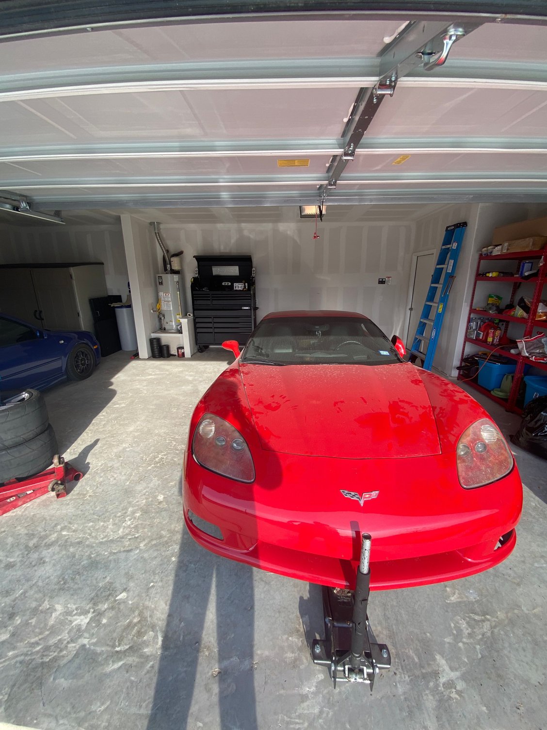

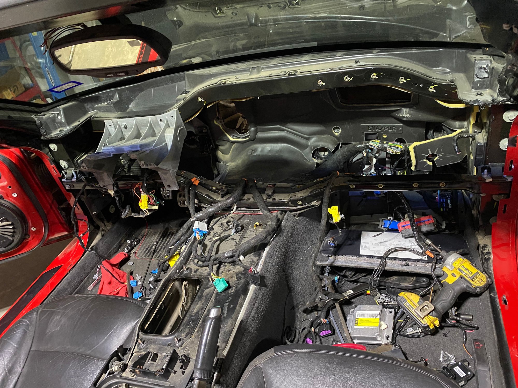

Just a few pics of what I have so far and how the car currently sits.
What is the reason to tear the interior out???

Probably to cut the tunnel for front transmission install. Cant wait to see that. lol

No worries. After having data on Garrett, Bell, CSF, and china cores makes for a difficult decision where to spend the money. I had a shearer previously before the frozen boost units.
Weight I would assume, I lost a TON of weight out of the interior. Plus the 9" swap dropped another 200+lbs.
To do it again I may have used an air hammer more vs cutting as much, I probably over trimmed for mine. NIce part is now I can fill trans and connect trans cooler lines from the passenger footwell. Drivers side made adjusting the shifter super and hooking up trans brake super easy.
Most definitely because of weight. Trying to get it as light as possible.
