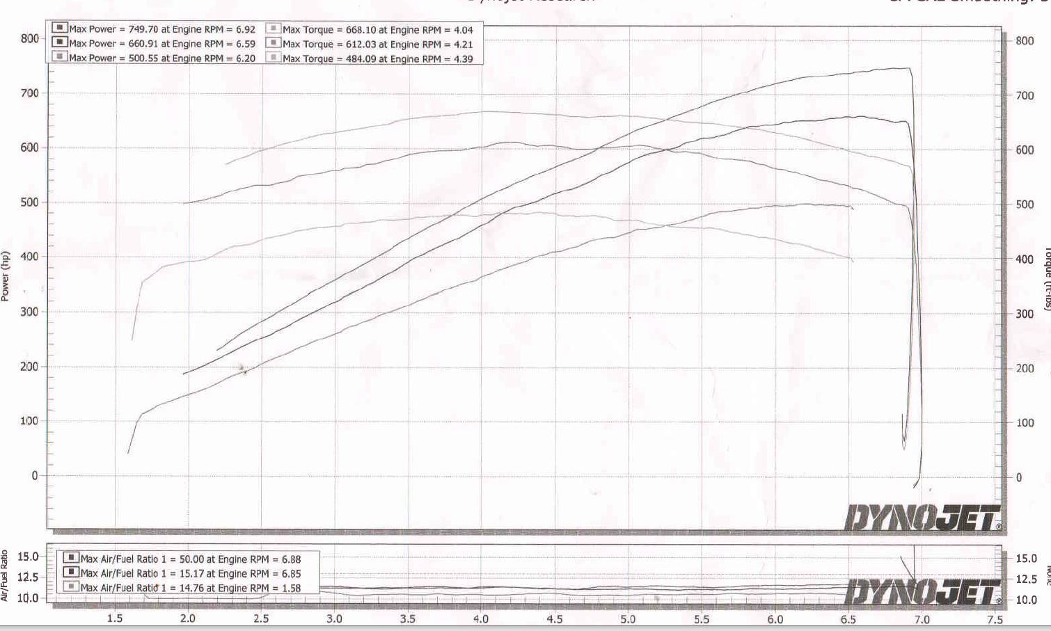

I wish people would post dyno sheets for the cam they installed to quantify the size vs reward aspect of various cams. When we see that the difference in power between the biggest cam vs low overlap cam is only 8hp, few would buy into the bigger split is better camp.

Originally Posted by Chiselchst
Damn wimpy Vette right there. Only 600'lbs of tark at 2500 rpm. And stays at or above that through 6500 rpm. Damn wimpy Vette right there....
It looks like the pull ended before it made peak HP
Nice results! What compression ratio are you running?
Yeah, that's a lot of camshaft for sure. I don't think Mitch used the word stealth anywhere on Pat G's order form for that one. If memory serves, I don't think he saw more than 10psi either. Top to bottom, that's pretty impressive power on very mild boost.
Actually, I did! I had Pat G do 2-cams. One stealthy'ish, and one not. I picked the one not. With no cats and 2" headers and 3" exhaust, I like the way it sounds...
Instant gobs of torque. I've Learned how to roll in to in 2nd and minimize wheel spin. Ramping it up, and by ~5,000 RPM's I'm WOT wheel spin minimal when running R888R.
Yep - 10 lbs boost max. 8-rib I replace the stock tensioner maybe every 10-15k miles just cuz..
Rodney - in your neck of the woods, I hear any less 1,000 WHP ain't squat. Here in Ca I'm hot ****, LOL
Stock LS3 (they are rebuilt Texas speed ported heads, so they likely shaved them to straighten them up, so maybe a tad higher than stock?
They set the limiter at 7,000. I'm good with that, and even try to not bump the limiter (1st second and 2nd are quickly done, I do bump it more than I should [even while using Rodney's *family relative* theory])
