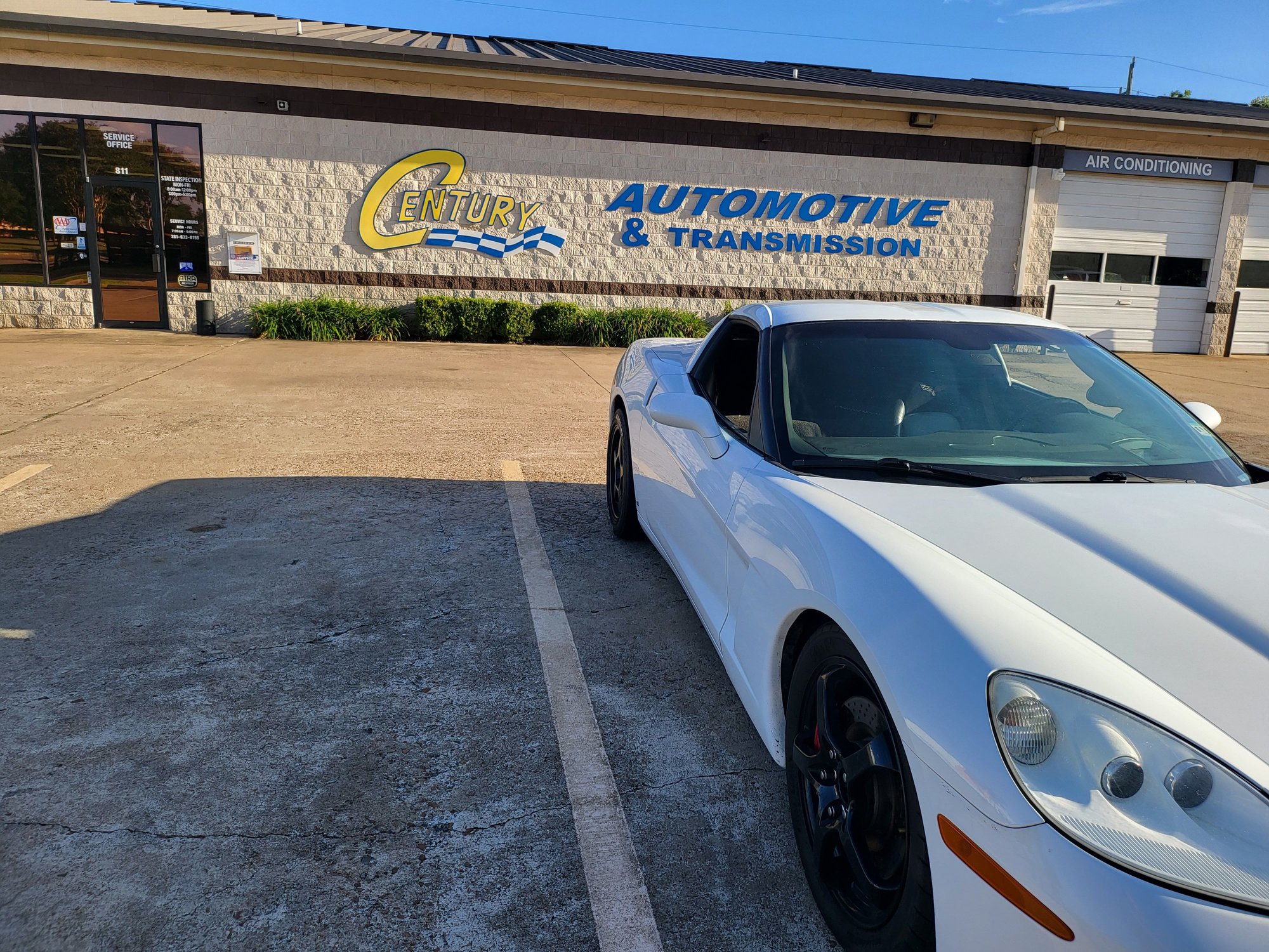

Update: sending the car to Century transmission for a level 2 6L80E. They are rated at 1100rwhp with a 6 month warranty.
Will also be pully down.
stay tuned
