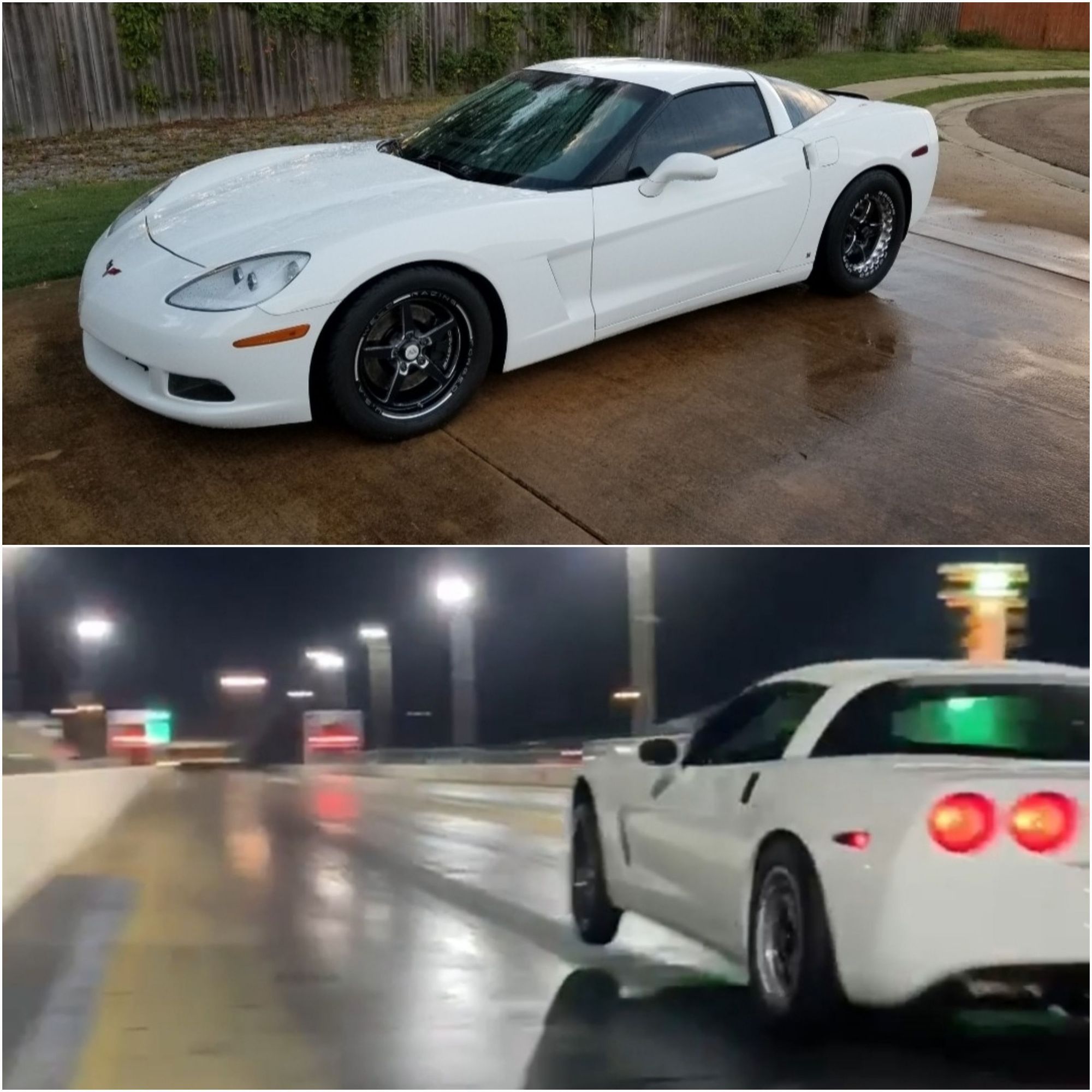

Finally getting my supercharger setup I have always wanted. Talked with Matt over at @21STCENTURYMUSCLECAR and they have my car under the knife. Really excited about this project as I've been chasing 9's for some time now. I think we may have a shot at an 8.99 or better with this project if the transmission holds and a negative DA. But maybe not, my transmission is a big limiting factor. Regardless she's gonna fly!
-Looking forward, I'll most likely have to address the rear differential and axles I'd imagine as well as the 6L80E at some point. (Edit, "at some point" ended up meaning... the day I got the car back lol)
A&A SUPERCHARGER KIT (D1X HEAD UNIT,
50MM RACE BOV, SECONDARY 8-RIB DRIVE
SYSTEM)
INJECTOR DYNAMICS ID1300X ID1700X**
Advice, comments and questions are appreciated.
