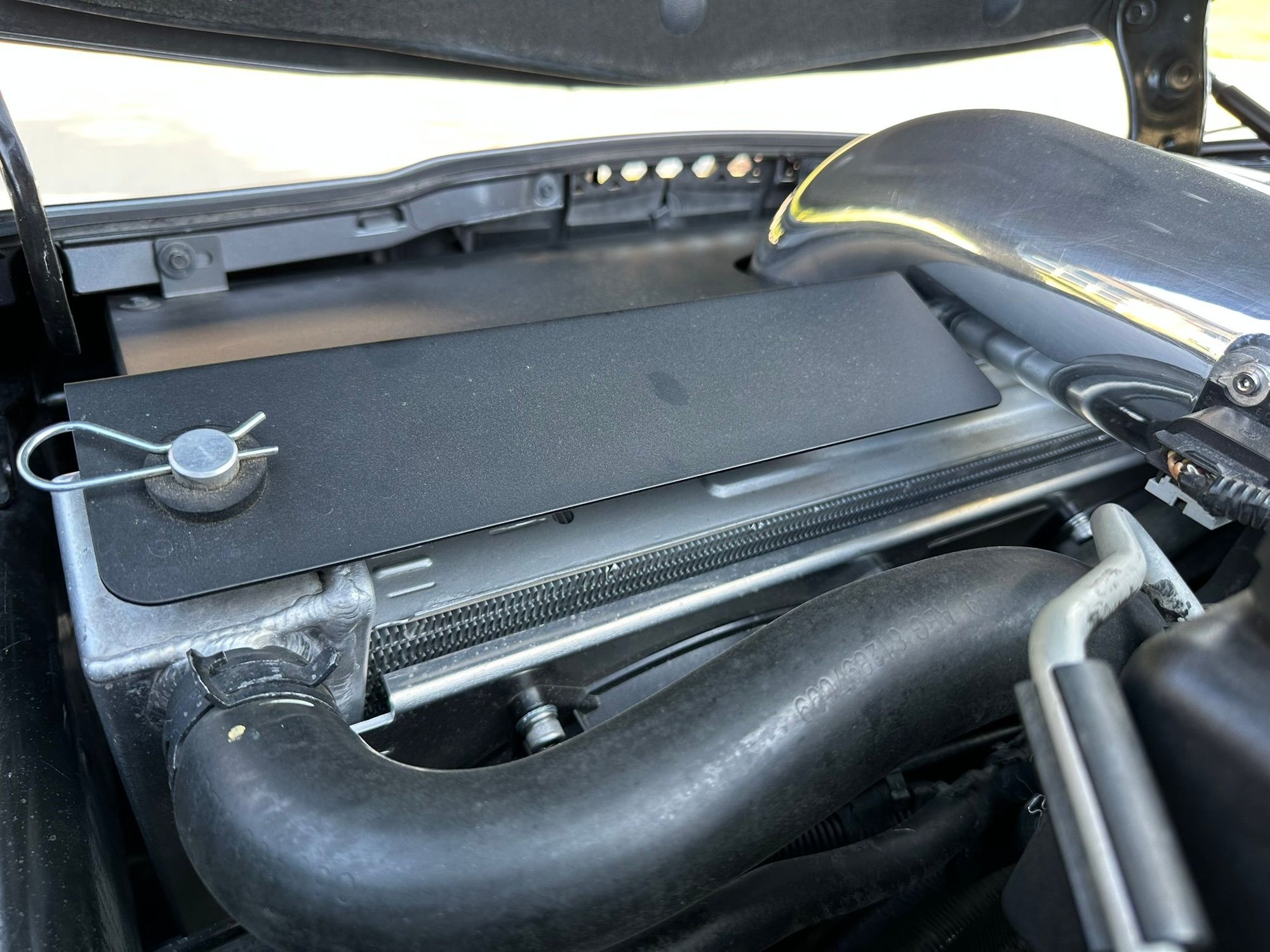

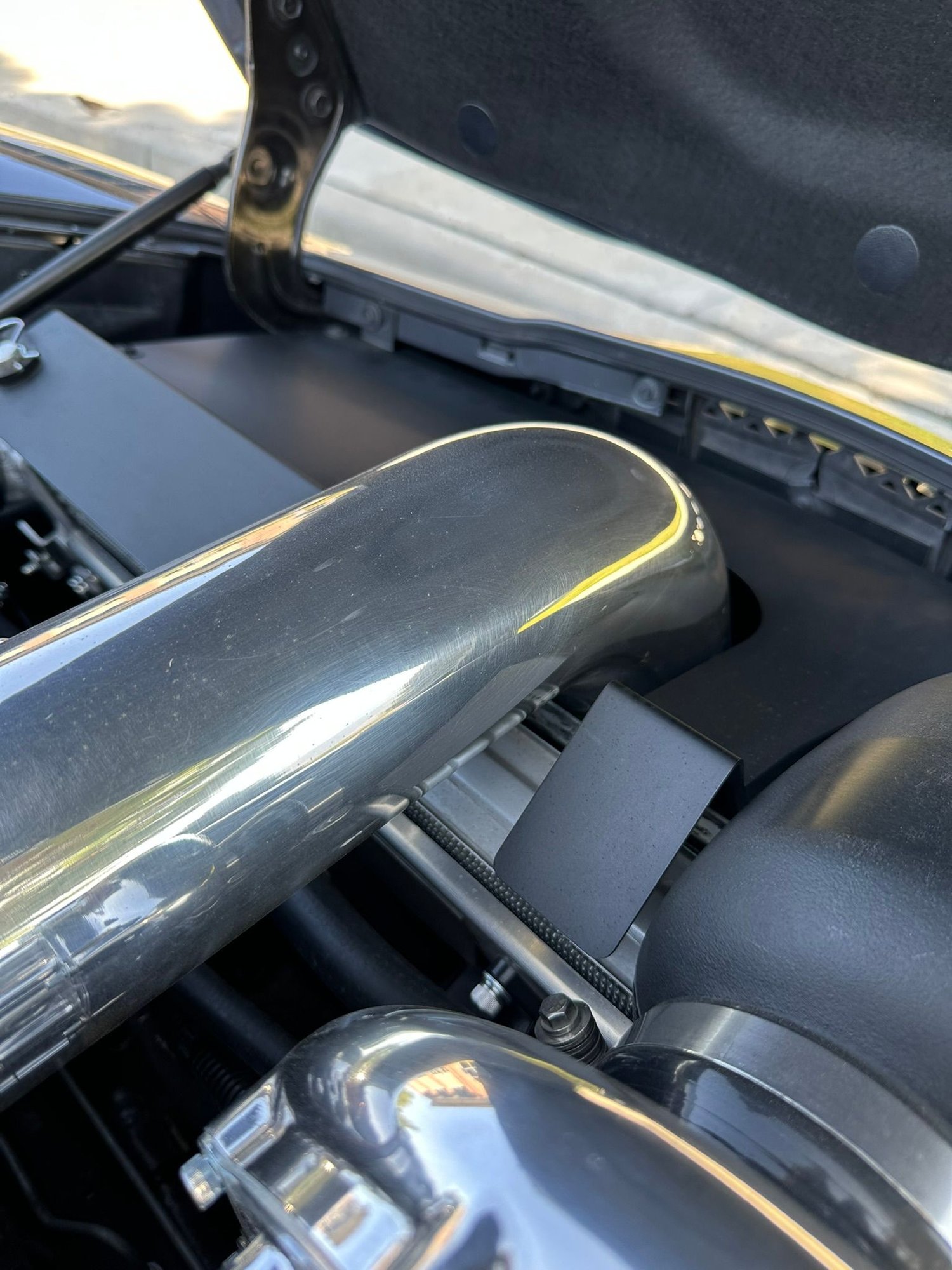

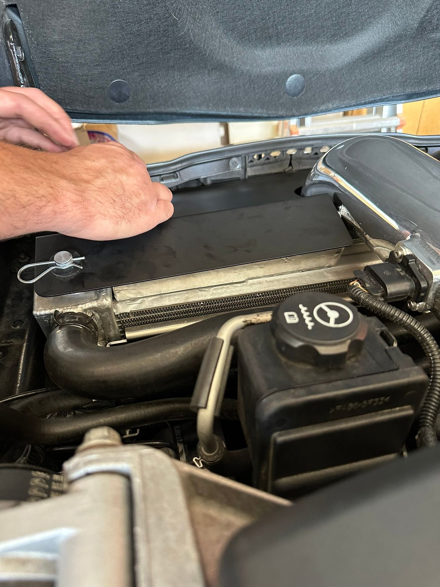

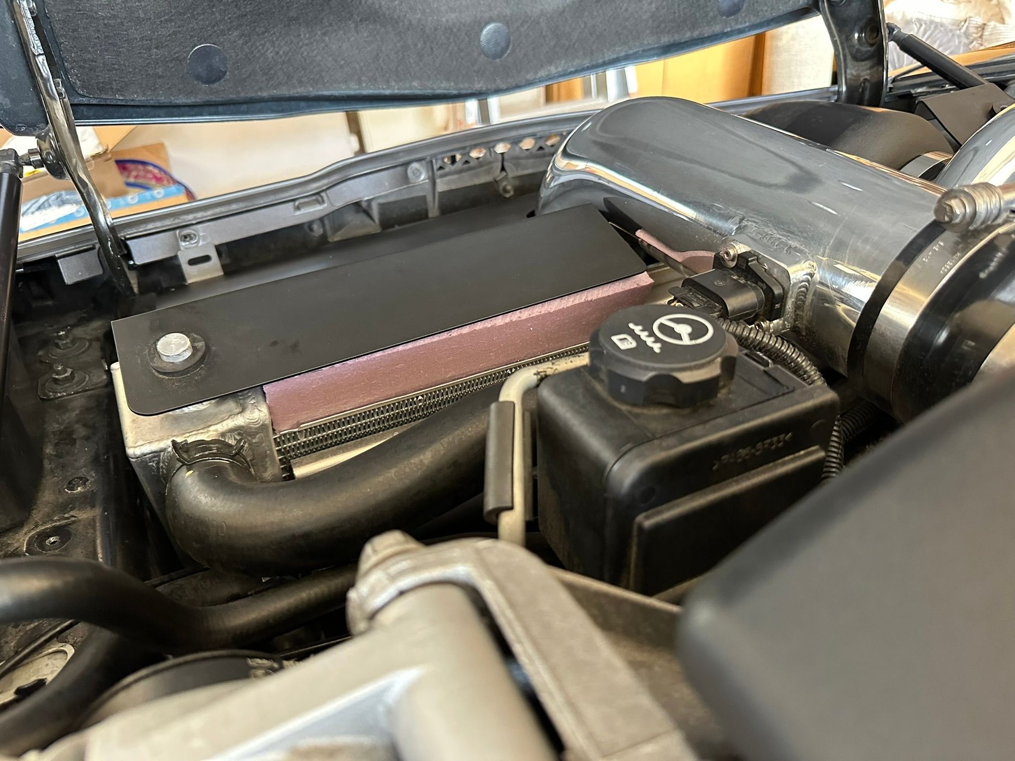

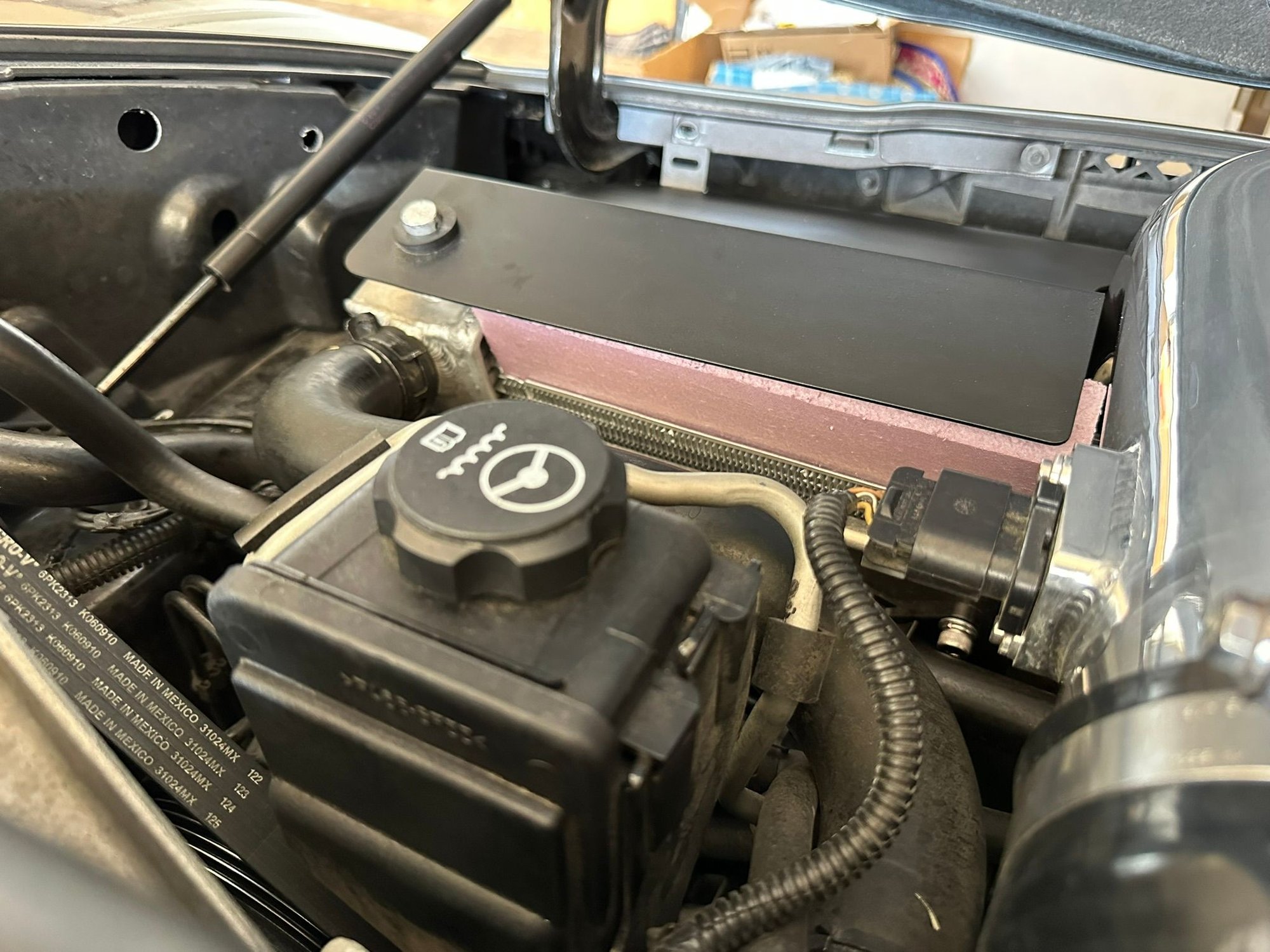

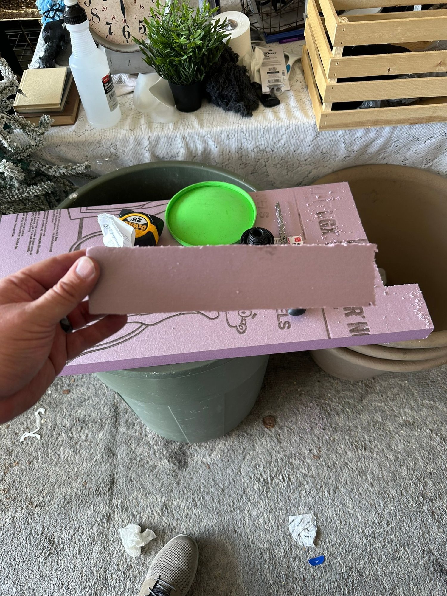

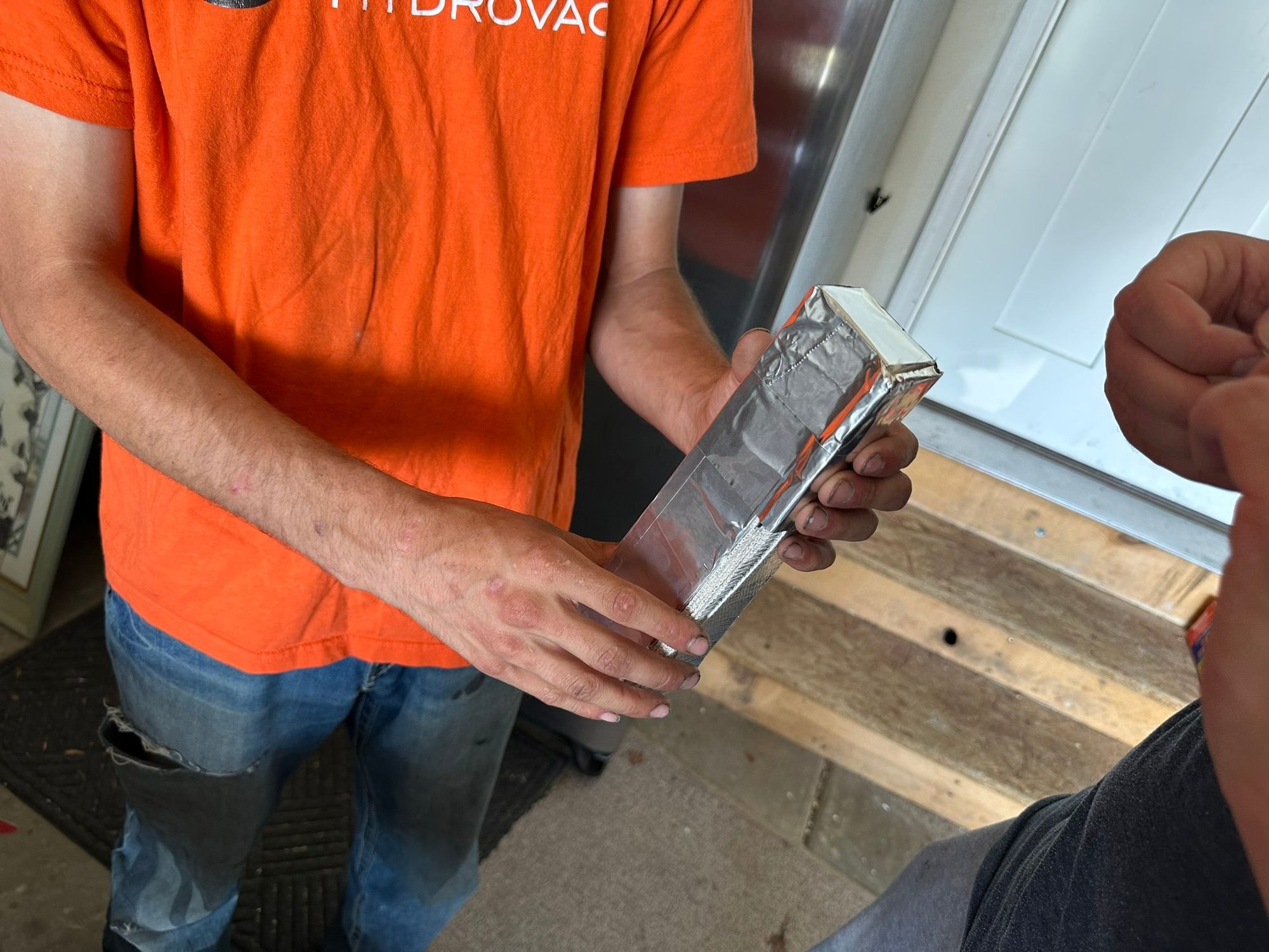

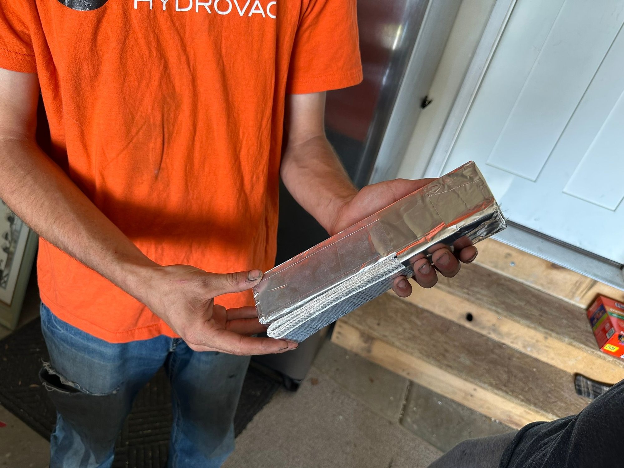

So after doing some research on this topic through all the forums I had yet to find a solution for the airflow escaping over the top of the shortened radiator with the A&A kit installed. So after thinking about ways I could approach this to block the air off I came up with this solution. I wanted to post in this thread for others who might have this issue. I went to Home Depot and picked up some 2 inch rigid insulation, high heat foil tape, some heat shield for wiring from O'Reillys and some double sided 3M tape and went to work. I measured the length between the inner edge of the radiator to the edge of the intake pipe and cut it to be about 2 1/4 inches high and it was 2 inches thick. I took off the metal shroud and wrapped the rigid insulation putting the heat shield on the bottom creating the barrier between the radiator and the insulation and then wrapped the whole thing in about three layers of high heat foil tape (basically the same tape you use for dryer vents). Once I had it wrapped I now had a shiny block and placed it on top of the radiator and then put the shroud back on and just admired how well it sealed up that 2 inch gap. I put some double sided 3M tape on top and then put the shroud back over it and it sealed it right up. So now I'm driving around and the temps have come WAY down because air is now being forced to go through the radiator instead of taking the path of least resistance which was over the top of the radiator. Again, this was the fix I found running a shortened CSF Radiator (same as the DeWitts Shortend radiator) with the Prospeed dual fans and the A&A kit. If your running one of these radiators then you might want to try something like this to keep that air from escaping into the engine bay. If DeWitts or CSF is in this thread they should manufacture something like this that can seal up the gap for customers.
You can see the 2 inch gap

Area between the air filter housing and the intake

rigid foam insulation
cut to fit
cut to fit
wrapped with foil tape
notice the heat shield on the bottom. That was the barrier between the radiator and the insulation brick
The finished product. Completely sealed up the gap. No more air flow loss

Have you noticed any type of melting of the foam even with the foil? That radiator will get to 210 or so degrees and usually foam starts to melt around 170-180
I've been running it now for 3 weeks in 95+ degree heat and they've been holding strong. I put lots of heat shield on the bottom piece between the insulation and the radiator so I imagine thats been helping. So yeah, so far they've been holding up pretty good.

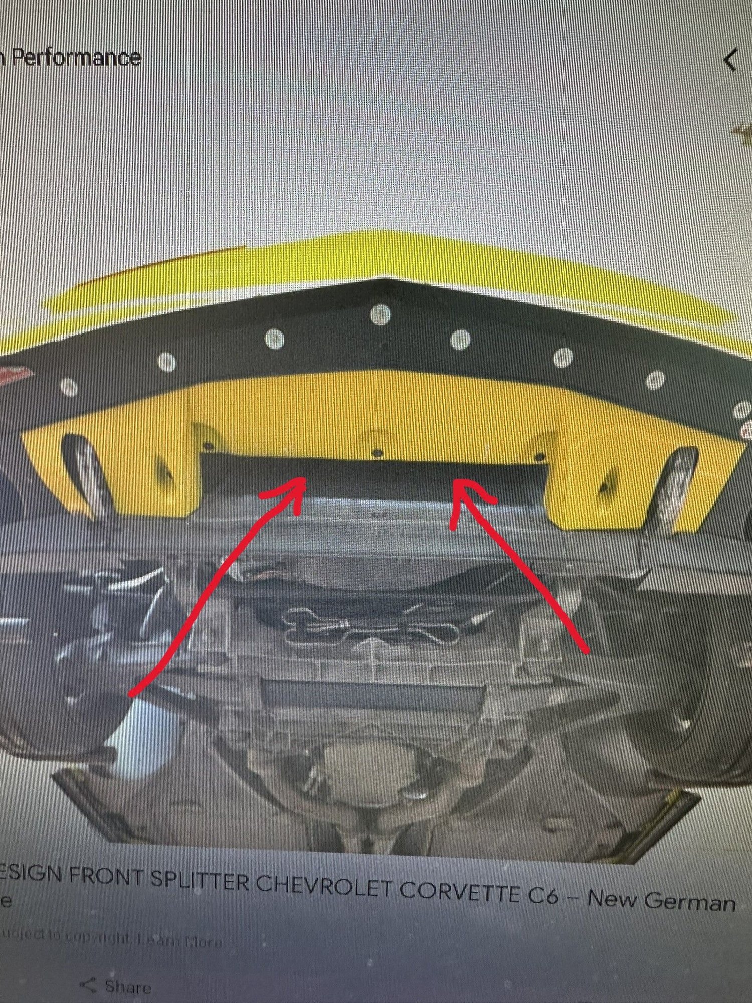

It's lowered it quite a bit. During the days when it's 95+ degrees I'm running between 207 and 210. However, I also removed a bottom flap from underneath the front fascia that the air dam uses to force air up to the radiator. I don't know why GM closed that off but opening up that duct way forces even more air from the bottom of the car which comes in handy since my intercooler block so much air coming from the front of the fascia. Opening that up while closing off the gaps has decreased my road temps to be around 205 on average. Doing those two things has helped force so much air into the radiator.
