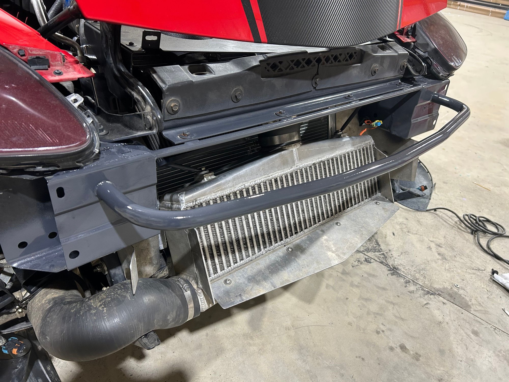

Old Jul 18, 2023 | 04:42 PM
JIMS SVT's Avatar
JIMS SVT
Joined: Jun 2012
Posts: 534
Likes: 8
From: Fayetteville Ohio
This helps get everything cooler
Old Jul 18, 2023 | 04:46 PM
PSSSSSHC6's Avatar
PSSSSSHC6
Joined: Oct 2018
Posts: 465
Likes: 156
From: ATX

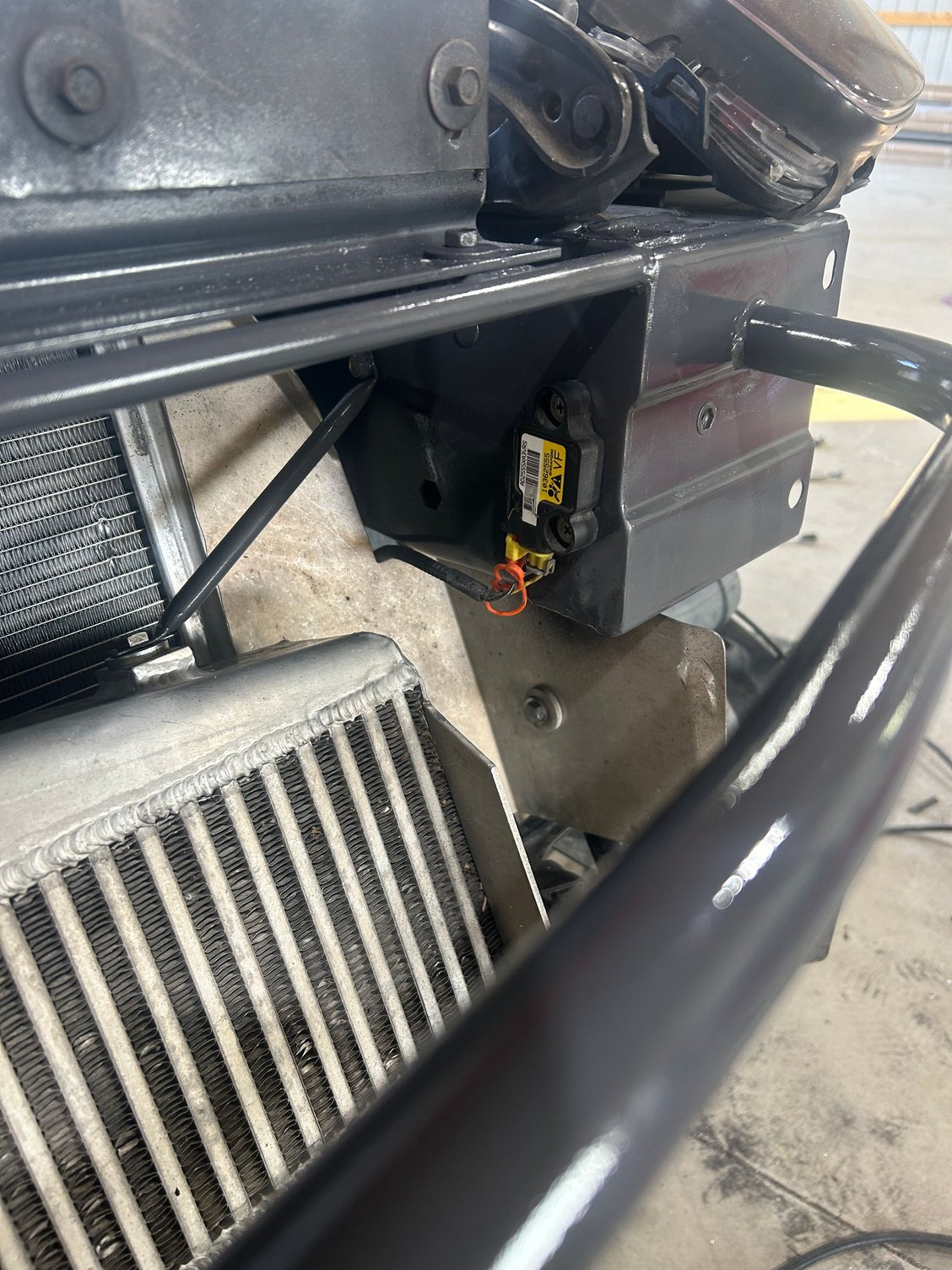

Room for a larger IC for sure!!! Where did you mount the impact sensors?
Old Jul 18, 2023 | 04:49 PM
JIMS SVT's Avatar
JIMS SVT
Joined: Jun 2012
Posts: 534
Likes: 8
Old Jul 18, 2023 | 05:38 PM
PSSSSSHC6's Avatar
PSSSSSHC6
Joined: Oct 2018
Posts: 465
Likes: 156
From: ATX
Super clean!!!

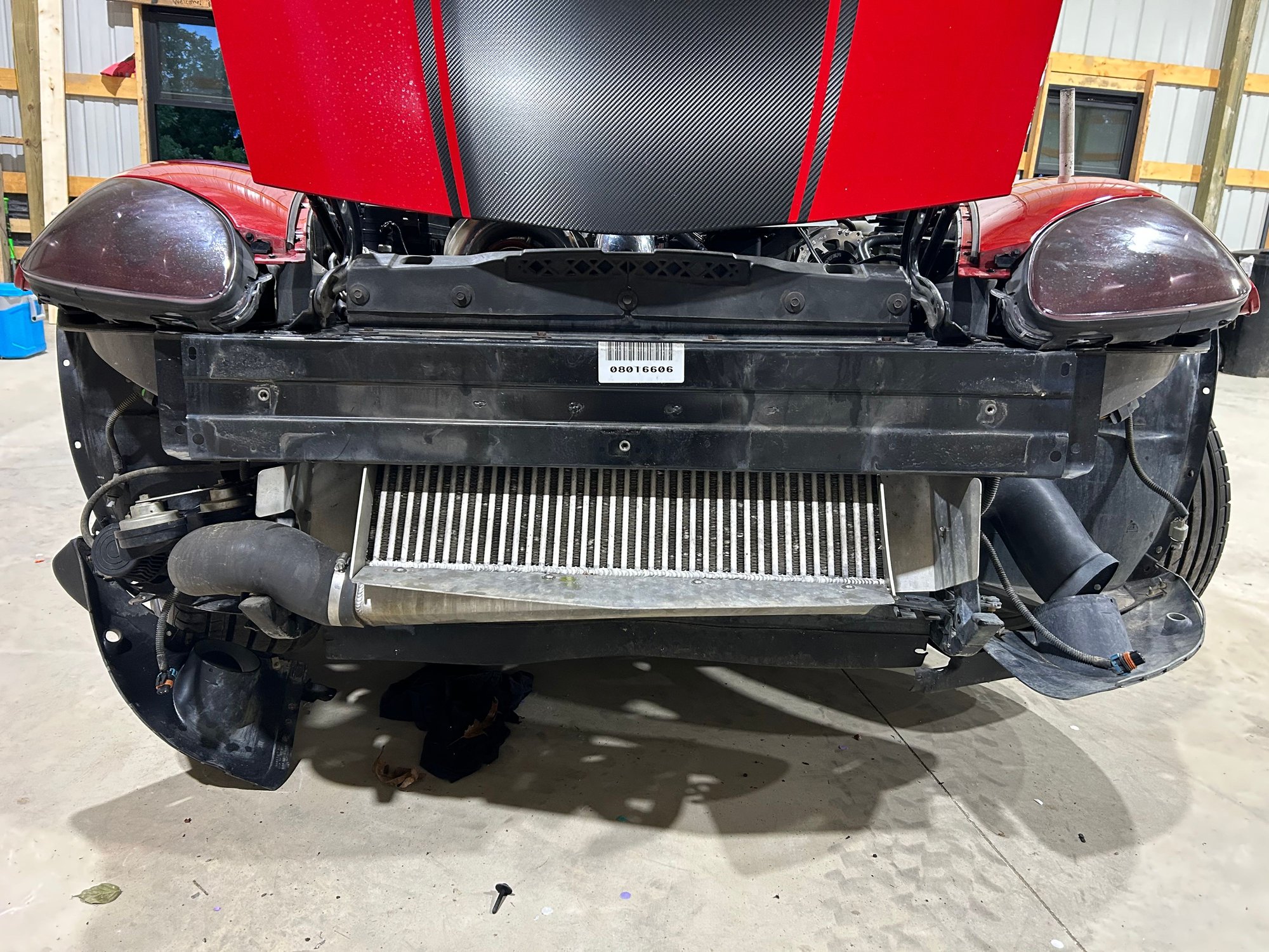

Old Jul 27, 2023 | 07:41 AM
grocerygetter's Avatar
grocerygetter
Joined: Apr 2010
Posts: 1,131
Likes: 126
From: Conway, AR
That crash bar is magic.
imo from my last ecs car experience. I’d suggest a full size Dewitt’s and stock fan set up then that magic of water, Dexcool, water wetter cocktail above. Start there and yes, you want all of the air to go through radiator. A&A flows into the radiator a bit more controlled than ecs kit from my personal comparisons but man I love the ecs kit. Maybe just build shrouds as needed for ecs kit and side/bottom shroud FMIC like A&A does.
