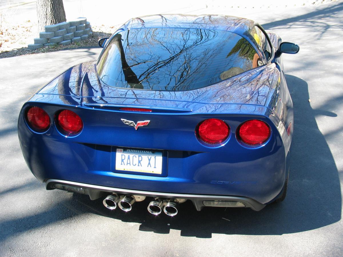

Here's a pic of my C6 with its one piece tint job.
No glues were used...my guy was just very skilled and used a heat source to shape the tint on the outside of the glass before placing the tint on the inside for the final fitting.
Took him 3 attempts and about 2 hours to get right! but it sure looks good.
This was done March 2006 and has not lifted or peeled anywhere.
