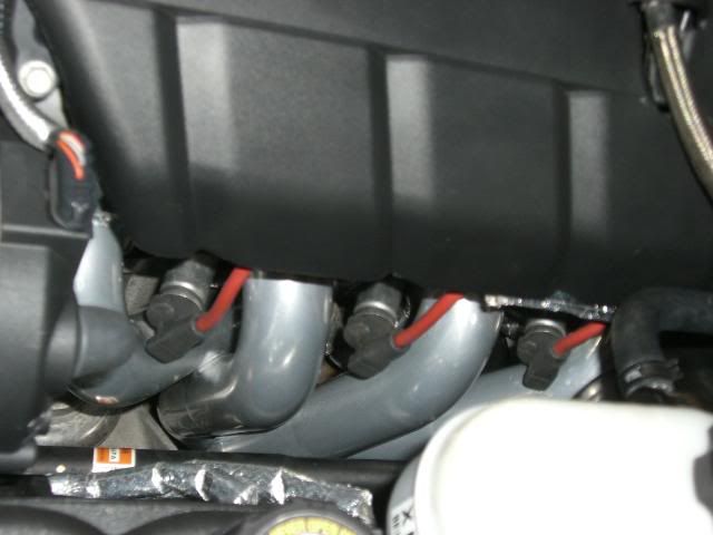

Branden is totally right on this, I opted for the free jet hot coating, which he handled on his end. If I were to do it on my end, it would have been very costly due to shipping. MarylandSpeed took care of all that for me and I got a set of very purdy headers. My friend has uncoated LGs and they are discolored from the heat.
Here is a picture of my Kooks Jet Hot Coated headers installed.
