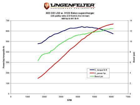

I don't think the 122 blower can support enough airflow to make 600 rwhp on a street car (pump gas etc.). Even if you could run full spark timing and leaner AFR with race gas to get a better engine efficiency, it would be hard to make that kind of rwhp with a 122.
Here is an engine dyno graph of a 403 CID LS2 engine that we ran an H122 blower on:
This engine had lower compression than a stock LS2 in order to run the higher boost on pump gas (around the same CR as the new LS9). We were spinning the H122 to its maximum rpm. We were also running into belt slip issues and ended up building a cogged rear belt drive for the supercharger (with a tensioner) and running a 8 rib front drive belt system.
We and others have run engine dyno tests on 122 equipped engines that have made enough power to make roughly 600 rwhp but those engines have been running open exhausts, stock or close to stock compression ratio, good fuel, close to maximum power timing and lean air-fuel mixtures (by supercharger/turbocharger standards). Even then you have to spin the 122 fairly quickly.

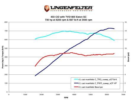

To make that power level you really want a TVS1900 or TVS2300 (the new four lobe, higher efficiency, higher flow output Eaton superchargers). They flow more air and can be spun to a higher rpm along with being more efficient (lower outlet temperature and less power consumption for the same airflow/pressure).
We built a 403 CID engine and ran a TVS1900 that made around 730 hp on pump gas with the stock truck exhaust manifolds. It has similar compression to the 403 LS2 described above (again so we could run pump gas at these boost levels). Here is a graph of that engine:
To get 600 rwhp you would want to run lower compression than a stock LS2 and then run more boost. Forged pistons would be recommended. Ported heads would help some as well. We have had very good durability of the production crankshafts at this power level but we would recommend forged pistons and probably new rods as well. You would also need larger injectors and a different fuel pump system than we use in our normal C6 supercharger packages.
