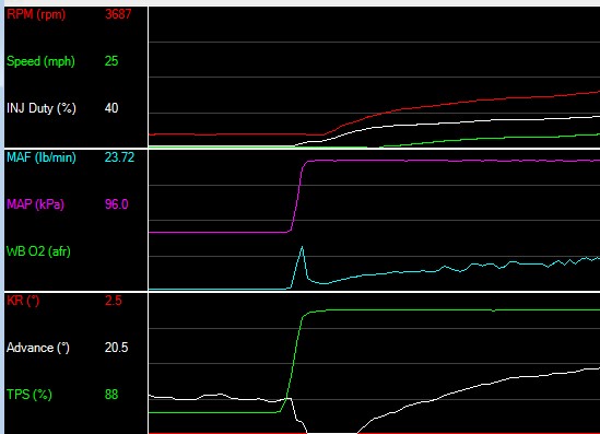

Several observations:
  1. If you look at the ET Fast list you’ll see that running a 13.2 with a trap speed of only 110 is not really out of line.
  2. The DA from Irwindale (elevation 250 ft) was 736ft whereas the DA from Auto Club (elevation 1110 ft) was 1839 so this alone cost you a little less than two tenths. If you had made that 13.213 pass but with the Irwindale DA it would have equated to a 13.038 run (which is where I came up with the 2/10ths number)
  3. Although it doesn’t look like you’re getting any wheelspin when you launch the car you do however seem to be losing lots of spark advance (which is the white line at the bottom that disappears from the graph briefly). This is what several people call “launch TM” but I can assure you there’s no such thing and it can be tuned out as shown below in a screenshot of one of my launches. Although my timing does still drop a little it not nearly as much as yours does.
But think you mean lots of spark RETARD. That would only hurt the launch (from what we can see) and he should still be able to trap, way better than 110.
Nope, I got it right the first time. What his scan shows is a drop in timing advance, not an increase in spark retard. In HP Tuners even though they're related (i.e. an increase in knock will cause a subsequent decrease in spark advance) they're recorded separately.
I'm also curious as to whether he still has TM turned on since the scan doesn't show enough detail. That single factor alone will slow you down by up to a full tenth for each shift (I've run with it both on and off at the track).
