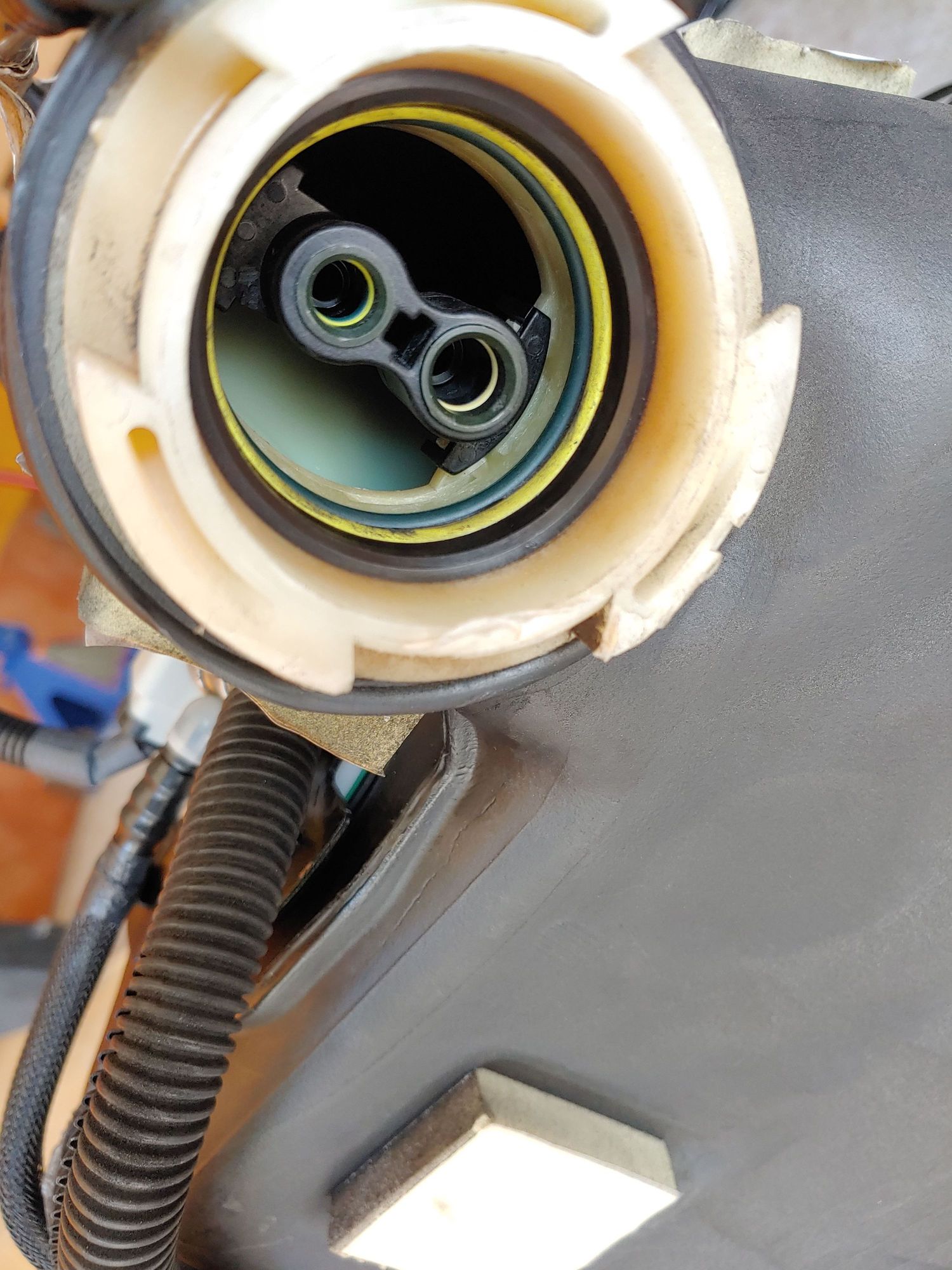

Default Installed new pump but won’t start
What happens or could happen if you don’t disconnect the negative terminal to the battery? I’ve installed a new fuel pump assembly but now it won’t start. Just tries to turn over. Every 10 turns it sounds like it’s barely starting to get fuel. I’m wondering if I fried the pump, have it installed wrong or what. I installed the upgraded fuel pump assembly part # 19149687 Model # M10059 that I guess is what’s in a Z06. Mine is just a standard 3LT. Any help would be appreciated. Oh, and I did put about a little less than a gallon of bad gas in after the install...I had in a gas can that was a little old. But I’ve added 4 more gallons of fresh gas. or could my o-rings be bad?

gfox - if you installed the cross over tube the way the pic in ur last thread looks... you have no fuel pressure... You left out the sleeve on the bottom tube. The top tube has it installed but the bottom doesn't. Sometimes it stays on the cross over tube side when taken apart, other time it blows apart and rolls across the garage floor. When you don't have the o'rings and sleeves installed properly all it does is fill up the passenger side tank but the entire system doesn't have pressure to the injectors.

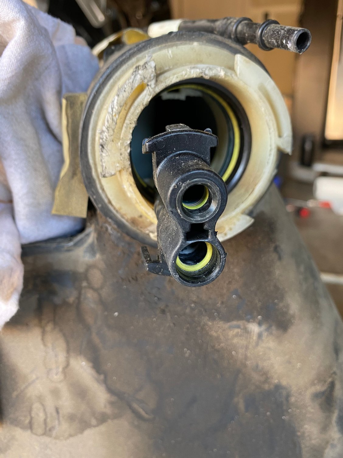

You wouldn't happen to have or know where I can quickly get the O-rings for the two inner fuel lines inside the driver side fuel tank?
I tried replacing my O-rings with non-OEM fuel rated types but apparently they were just a hair too small for the upper pressurized line.
Hard start after reassembly...won't hold pressure between startups. :-/

I found all the bits you pointed out...put it all back together. But I tried replacing the O-rings with non-OEM type that must have been a hair too small for that upper pressurized line so it won't hold pressure in between startups...hard start. Know where I can get replacement O-rings? There was a green and yellow on the upper and a larger yellow on the bottom from what I swept up off my garage floor.

I figured it out....it was the O-rings in the two fuel lines inside the tank...they got flung out, I found them and reinstalled...except the yellow ones were damage on my attempts of removal or reinstallation...
Do you have a part number for the O-rings or the fuel lines that go inside the tank? Thats what I need....new o-rings.

oh man you scared the crap out of me.... luckily enough i took some pictures... see what you mean now.... just hope that the passenger side still had both of em... only got a good pic of drivers....

Uncertain if you can just purchase the oem o-rings separately. If so, a search on here should net you the part #'s as I recall reading others asking in past threads.
I'm getting ready to drop both tanks..purchased new plastic lines and they both came with the black ferrels and o-rings.

Seems like I ran across a thread awhile back that someone purchased the o-rings. They do come with the cross over tube though (even though they install on the tank side). Theirs threads that say the crossover can only be taken apart once and after that you have to replace. I've found that not to be true as I've had them out multiple times and as long as you don't kink/bend (main tube) or break the lines inside and retain all the parts their fine.
Drew yes, If you pulled it apart and all stayed together like your pic, your one of the lucky ones. Both tubes require the sleeve. Sometimes they blow across the floor, stay on the cross over side, or blow across the garage. Also, the top line has a small spacer along with the 3 rings and the sleeve.
