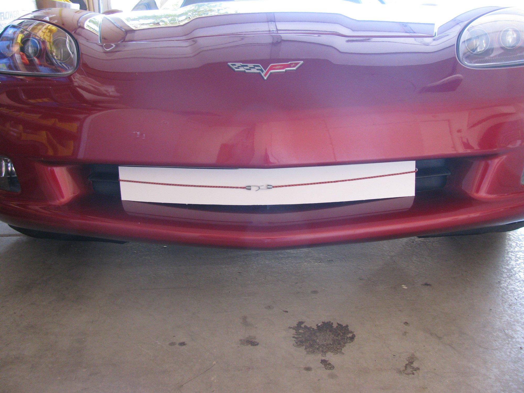

You guys apparently don't know this is a 5 year old thread that got dredged up by a newbee.
But anyway, this is what I keep in the hatch if I ever have a concern and have no other alternative. It's just a piece of 1/8" foamboard held in place with a bungie. Assuming the water is not deeper than the lower part of your bumper (and you shouldn't be driving if it is), this'll keep the wave created by oncoming vehicles from entering through the grille.
Without something to block waves, your other option is to shut off the engine before the wave arrives.
BTW, I use a paper filter in my Vararam. It not only filters more dirt, but it's a lot less likely to be hit with enough water that could force it's way farther up the intake.
