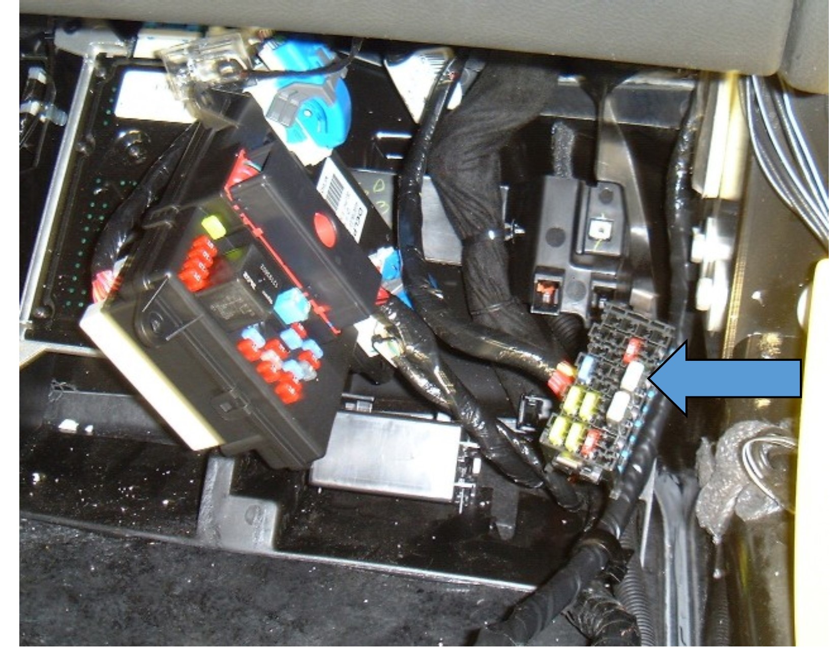

Congratulations, what a pain and I'm sorry you went through so much trouble for a simple fix. I'll look at my fuse box when I get home tonight if no one has posted a picture by then.
Enjoy your car now
They appear to be right next to each other in this pic from kawal's site: so I will definitely be checking mine now to see if something has changed.
Enjoy your car now
By looking at this pic, I have the top fuse in the wrong position. The top fuse is for the power seats.
My power seats are working, but I went ahead and dropped the top fuse to match your pic and it didn't make any difference. The seats worked with the top fuse in either location.
