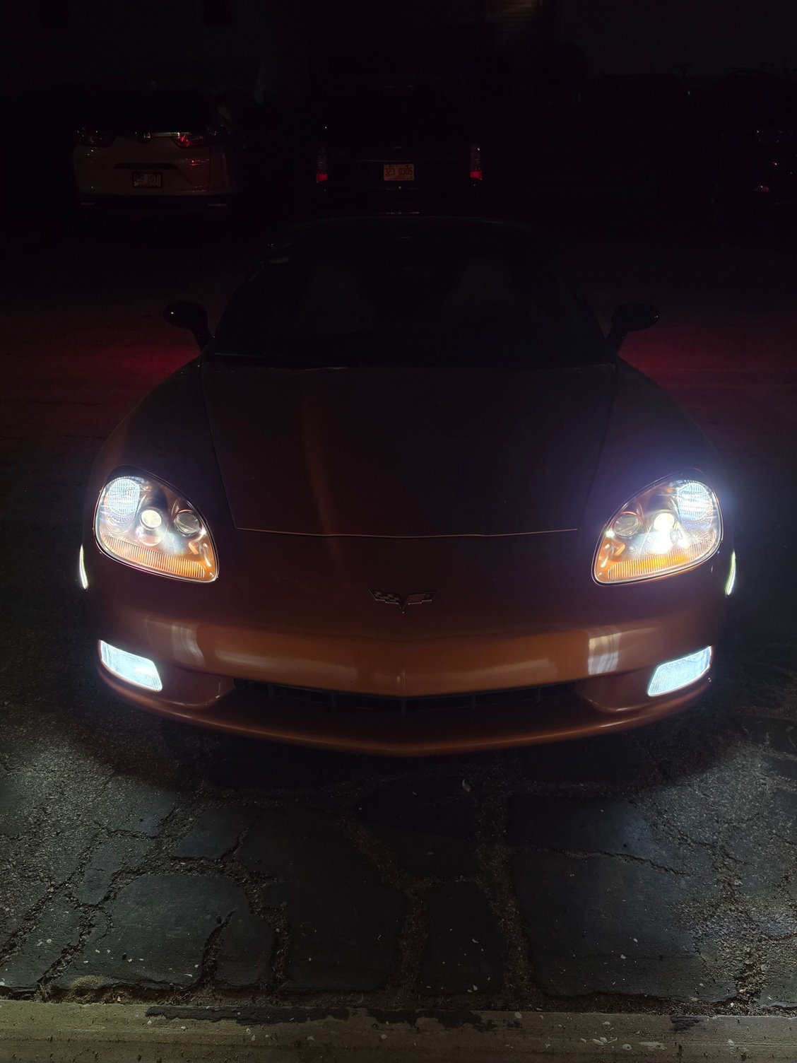

Just finished up a lighting refresh. The goals were:
1) Increase useable light on the road (rather than simply glare in oncoming driver's eyes) as much as possible.
2) Have all front lights the same color.
The factory hi and lo beam projectors were replaced with Sharp Light Innovations' new "Lux King" LED projectors. New LED bulbs were installed in the DRL/turn signals and the fog lights. Then new lenses from RL Sebring finished it off.
I'm pleased with the results. Lots of useable light in a nice 5500K pure white.

Those look pretty good. When we are no longer in a social distancing situation, I'd like to see those in person if possible. Maybe we could even get our cars out to the same place at night and take some pictures of stock light output vs the new ones you have.

In the meantime, contact Sharp Light Innovations for some data on light output of different headlights. They did a series of tests with light meters measuring the light received at different distances, elevations, and angles off center comparing stock headlights vs the Lux Kings vs an aftermarket replacement headlight.
