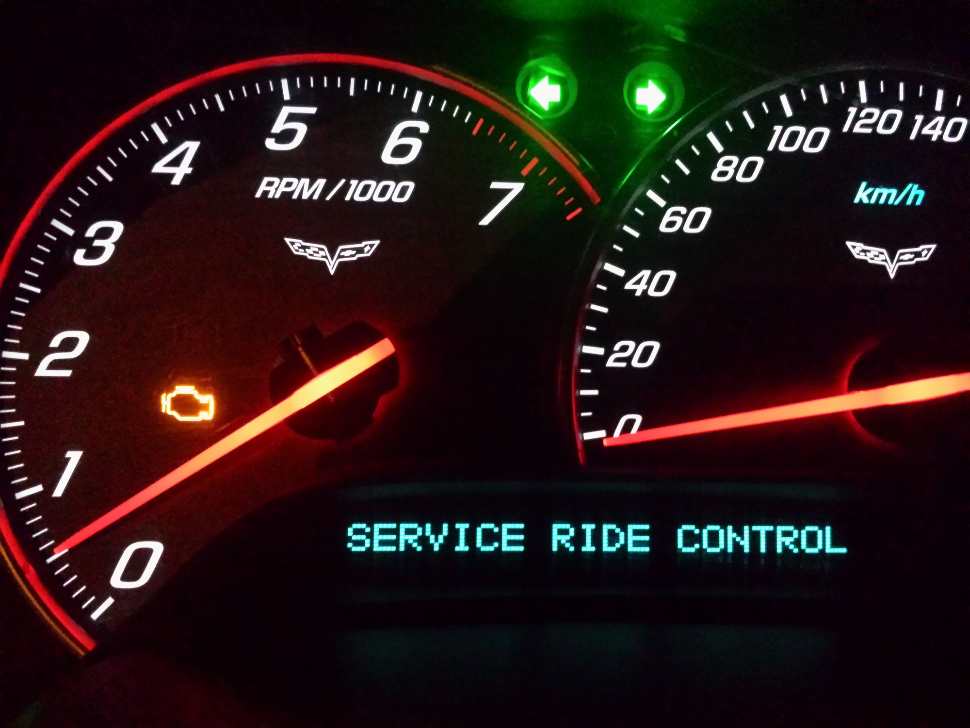

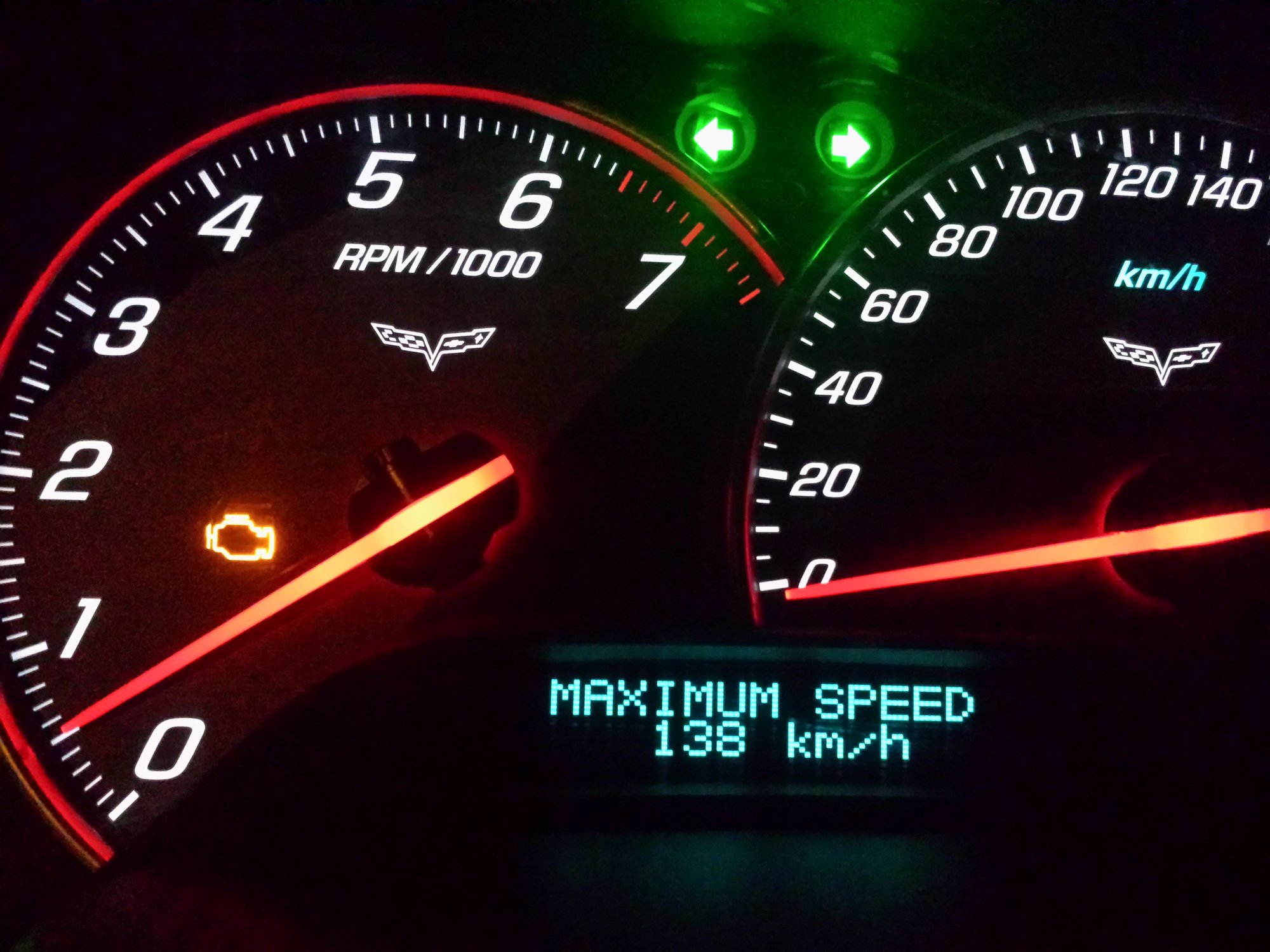

Hi,
Yesterday I have received a set of front and rear shocks Bilstein Z51 for my Corvette C6 -2005.
Today I have install all 4 front and rear shocks ( it was not done by me personally, it was done in the service), but after the installation of the shocks we see on the dashboard 3 messages: 1 "service ride control" , 2 - "shocks inoperative" 3 - "Maximum speed 138 km/h". I can send you pictures
I assume that this is because the shocks do not have place that we can plug in the sensor and because of that the car computer is not indicating that the car have shocks.
The other problem is that the car can not go with more than 138 km/h
Can you please help me out with advice?
My e-mail is : sandonov@abv.bg
I will realy appreciate your answer and help.
Thank you in advance!

Your assumption regarding the cause of the problem is correct. I believe the only way to fix it is to either re-install the F55 shocks or have your Body Control Module (BCM) reprogrammed.
Unfortunately, this is one of the drawbacks of the F55 system. There really is no easy way to use anything other than the stock F55 shocks without experiencing the problems you've described. Good luck.

I assume that your car has the magnetic selective ride option - correct ? The computer is trying to find the shocks and can't make the adjustments it wants to. It thinks that there is a major problem and is limiting the cars speed to compensate. You either need to get a correct set of shocks which are very expensive or get the bypass sims that plug into the wiring. Do a search in the Tech section for other threads on this topic. Other people have had the same problem and it can be fixed.
