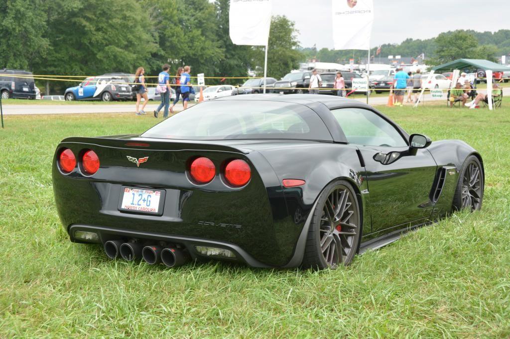

You must have really wailed something to bend the radiator support. If you didn't feel that hit it was done prior to you owning it, or they did it during Supercharger install. I believe that if you go 20's on the rear and 18's on the front you will most likely throw a traction control Code, ABS Code, or both.
LFZ, a Forum Member, has a Z06 on coilovers that is literally slammed on the ground. He swears he never scrapes anything other than the air dam.
His Corvette:
