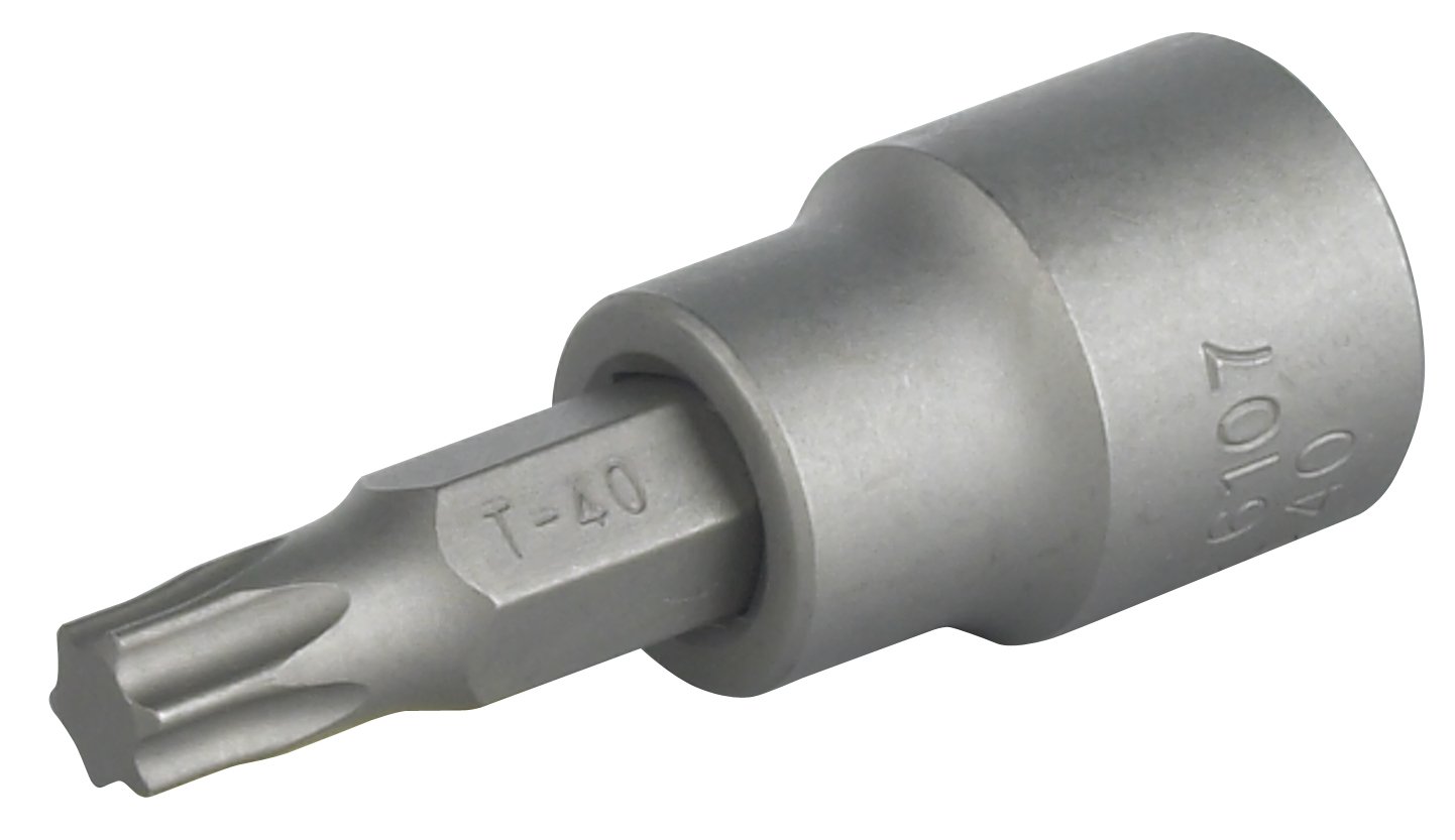

This morning I installed new OEM Z51 sway bars (front/rear). When removing/installing the fronts, I removed the front tires. While it was a bit easier to get at the end links, it isn't a whole lot easier. What is a PITA (and I am still trying to figure out) is keeping the end link stud from moving while tightening the nut. Yes, there is a very thin (almost like a washer) "nut" welded in place next to the bushing that, when properly held in place, allows you to tighten the nut. My box wrench is pretty thick and I could not get a good hold on this "washer nut". Whether it was the angle, how thick my wrench was or whatever it was a PITA. I am going to buy a thin-style box wrench to help in the future, but that is my least favorite part of the car to work on. Something that should be so simple kicked my a$$. Pathetic.
Old May 3, 2015 | 09:10 AM
Dano523's Avatar
Dano523
Joined: Dec 2013
Posts: 12,502
Likes: 3,629
Did you not notice the T-40 receiver socket on the end of the threaded rod sections?
This allows you to hold the threaded rod section in place as you tighten and remove the bolts.
So the one on the left, you use a T40 to back up the thread rod section from turning,
while the one of the right, a box end wrench instead.
Old May 3, 2015 | 10:31 AM
MKUMLT's Avatar
MKUMLT
Joined: Dec 2014
Posts: 87
Yes.
I did leverage that when initially tightening a few of the nuts. While that was helpful, it wasn't useful when it came time to use a torque wrench.
The lower bolts are very easy to get at; its the upper bolt that is more difficult. In the rear, both upper/lower bolts are easy to get at.
I ended up buying this type of wrench:
Amazon.com: Var Professional Cone Wrench (18mm): Sports & Outdoors Amazon.com: Var Professional Cone Wrench (18mm): Sports & Outdoors
I think this will be the solution to being able to hold the washer nut in place.
