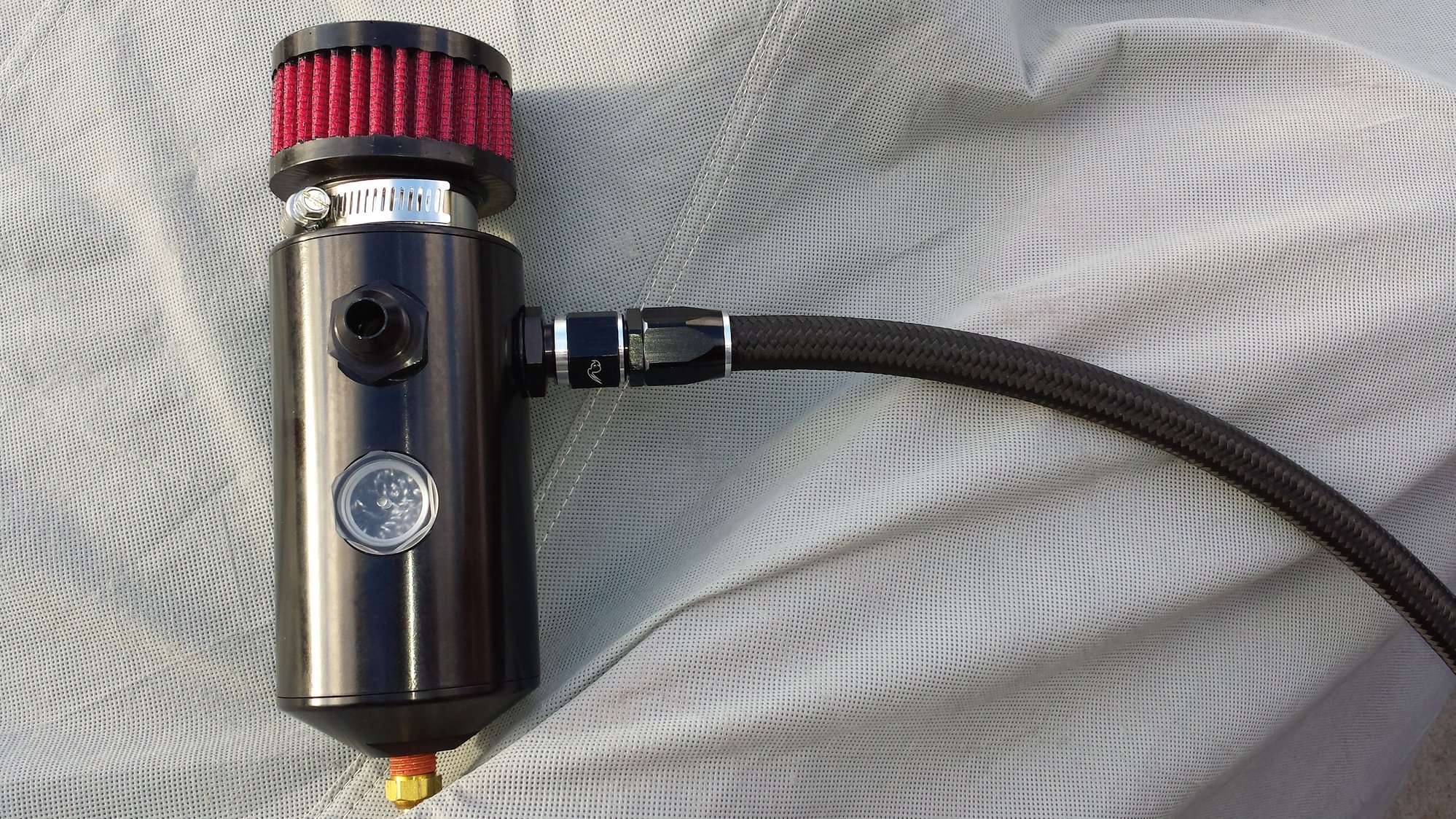

here you go.MM Gen.4 can.his newest can that just came out.Ill be using it as a draft can with a 8 an line when I install my SC.A work of art IMO.
I ran a Moroso catch can with a breather on it for a while, thus venting my crankcase to atmosphere. My oil got black in 1000 miles and the inside of the car smelled like the inside of my engine as the crankcase vapors were being drawn into the cabin. Those are ok for race cars but not for street cars IMHO. A modern engine needs to have a functioning PCV system to evacuate combustion byproducts from the crankcase.

I ran one of those once. My oil got black in 1000 miles and the inside of the car smelled like the inside of my engine as the crankcase vapors were being drawn into the cabin. Those are ok for race cars but not for street cars IMHO. A modern engine needs to have a functioning PCV system to evacuate combustion byproducts from the crankcase.
Dano523 excellent posts in this thread.
The MM can as in the picture is available with a full PCV valve. The vent on top only allows venting at high boost and is closed in normal driving. I run 2 of these and they are the best solution of what I have tried.
I must be more specific, I used a Moroso can with no internal PCV valve - it was just open to atmosphere. I will edit my post to be more specific, but I believe my comment is valid - a modern engine needs a PCV system not only for emissions but for the longevity we now all enjoy with our engines compared to the days of the circa 1930 road draft system (which is what you are doing when you open your crankcase to atmosphere all the time).
Agree.. the cheap cans with just an open breather are no good. They just smell and make a mess all over.
