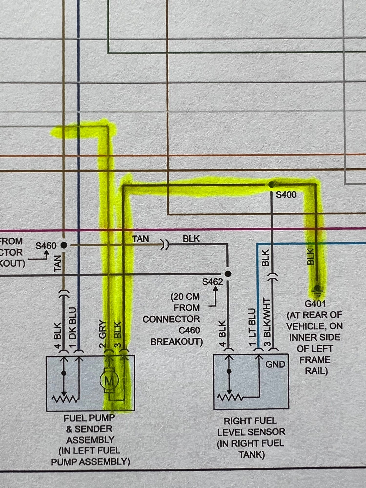

Hi guys,
I ran into the same problem with my 2007 LS2 base model. Until now I did the following :
Installed new Ignition Switch in the Dashboard
Cleaned BCM connections in the passenger footwell
Installed a new fuel pump relay (twice)
Got the whole fusebox out, cleaned it inside and checked every connection of the copper cables top and down
Re-seated the cable pin in the harness connection that goes into the underside of the fusebox that is the "hot" side to the fuel pump (little discoloration on the pastic)
Still no luck. The problem is very intermittent, had it within a couple of miles 3 times, then over 150 miles without problems.
I have now installed a permanent fuel pressure gauge to see if I have fuel pressure next time it happens. And I have a fuel pump relay with a switch on top, so next time I can trigger the relay by hand.
Codes in the GM Tech2 :
P0446 - EVAP Vent Valve - Intend to swap the vent valve next, can that thing shut off the engine ?
This is not stored as an error in the Tech2, but it says : Fuel Pump Relay Circuit : Incomplete. This turns up every time, wether the engine is running or not, new relay or not. Could that be a hint ?
I´m really out of ideas soon - Do you have any ? Will check the cables to the starter tomorrow. I don´t think I can check the crank sensor myself, would there be anything in the GM Tech2 ?
Thanks a lot in advance and greetings from Germany
Oliver

Good evening guys,
I think I am onto something. Did a testdrive with fuel pressure gauge installed. Motor cuts out.NO fuel pressure at all. Tried to start it. It cranks, but does not fire - NO fuel pressure. I then put in a rigged FP relais with shorted pins on the hot side, so FP relais is constantly on, no matter what the signal side to this relay says. Ignition on - Fuel pressure at about 50 psi, motor cranks and fires, fuel pressure at about 56 psi. I drive a few hundred meters and it cuts out again - NO fuel pressure.
Now I need to know, if my deductions are right :
1. It´s a fuel problem (obvious)
2. It´s not a faulty relay as my rigged one also did not help. - Which means the signal way to the FP relay is also not the problem
3. It´s an intermittent failure of the fuel pump itself. May it be the cables going to it or the pump itself.
Is that the right interpretation or do I get something wrong ?
I appreciate any input of you experts !
Thanks in advance and greetings
Oliver

Well, if you are willing to include the possibility of the wiring going to the fuel pump then you need to consider the entire circuit, which includes passage through the fuse block. It’s unlikely, but the same type of problem with the low beam failure could occurring elsewhere in the block and a heat related open could be happening. You could check to see if the power side of the relay socket has voltage when the fuel pressure is 0.

Actually, I'm not quite sure what you did here. If you jumpered the pins on the relay so that it was triggered all of the time, then that's not the same as bypassing the relay altogether with a jumper wire. The relay could still have a problem where it won't stay closed even though it's triggered, if that's possible. I can't imagine the fuel pump relay is that expensive, to you might consider replacing it to eliminate it as the problem source.

Thanks for all your answers. I tried 3 different relays, all new, that didn´t help. What I did now is the following : Removed left wheel and inner fender lining and spliced in 2 wires that provide power to the fuel pump. The plug leading to the fuel pump was not at all corroded or loose. Routed this wires inside the car and attached a voltmeter. Now I wait for the problem to happen again. If the car stops and has no fuel pressure but it has the 12 Volts directly at the fuel pump I am inclined to say, that it´s a faulty fuel pump. Problem is, now the car drives perfectly for the last 150 miles, no problem at all. It drives me crazy, sometimes it appears after 400 meters, then it takes ages to surface again. Meanwhile I can not use the car for any serious purpose, as it tends to die in the most uncomfortable spots like onramps or big crossings.....
