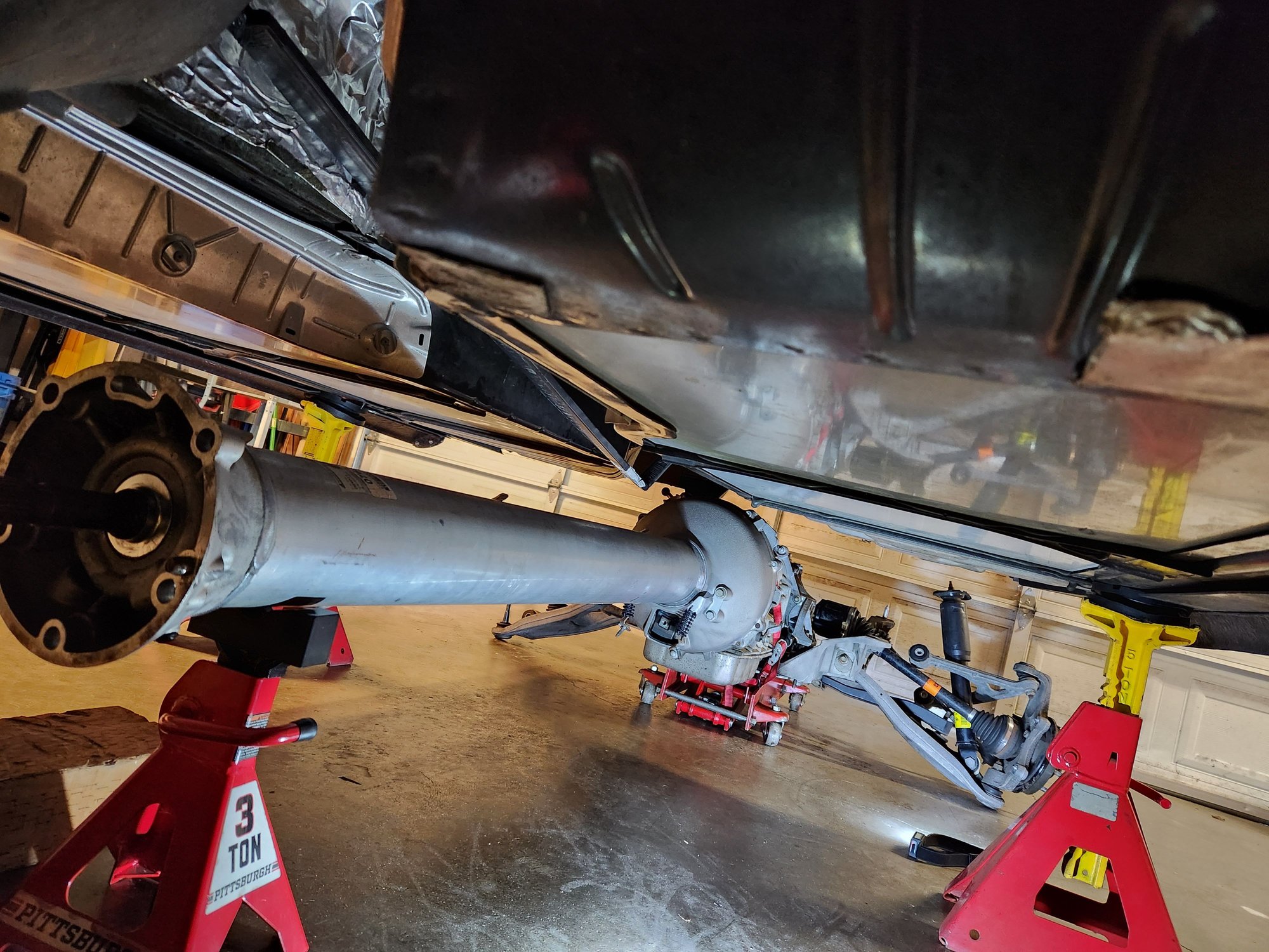

For anyone that lands here like I did with an Automatic Transmission in a C7, assuming to just pull harder (I hooked up a hydraulic puller and decided it was under too much stress to be right). If you take off the rubber inspection boot at the bottom of the bell housing, you have access to a 10mm hex head bolt you have to remove from the drive shaft inside the housing where it connects to the flex plate. Once you back that completely out, you will be able to easily slide the torque tube out of the engine bell housing.

Default It's not that hard, but you need a trans jack
