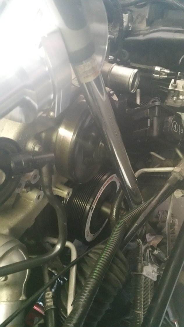

Video below (if I've linked correctly) of my crank damper at idle (and tensioner). It obviously has some movement, but no belt squeak. Looks to me like both front and back pulleys are vibrating. Car is 2007 Z51 auto coupe w/ apx. 75K, recently purchased.
Questions now... Does this appear to be within "normal" enough movement parameters to just leave it alone until I start to hear some belt noise? If it looks like possibly loose crank bolt movement rather than damper separation, should I try to tighten crank bolt (original, AFAIK)...& what torque, if so? Should I take this as an opportunity to just replace with something like the Summit C2501 damper and 910209 bolt?
I could probably do the work myself (I've pulled and rebuilt a couple of engines, and this is not my DD, so no rush...maybe get a proper puller and installer from Summit), but I'm hesitant to lay a wrench on this car after reading one thread about breaking off a crank bolt in attempted removal (rare?). There's a good Corvette mechanic nearby (north of Atlanta), but I haven't checked with him yet on price.
All comments or advice would be welcome.

as it sits now...I wouldn't touch it. but keep an eye on it just in case.

Well I'm not sure I agree to be honest. At higher rpm that hub must really wobble and that can't be good for the engine to be thrown off balance like that.
The job is a bit of a pain but not hard to do. The bolt breaking off would be very rare in my opinion. I've done about 5 or 6 of them.

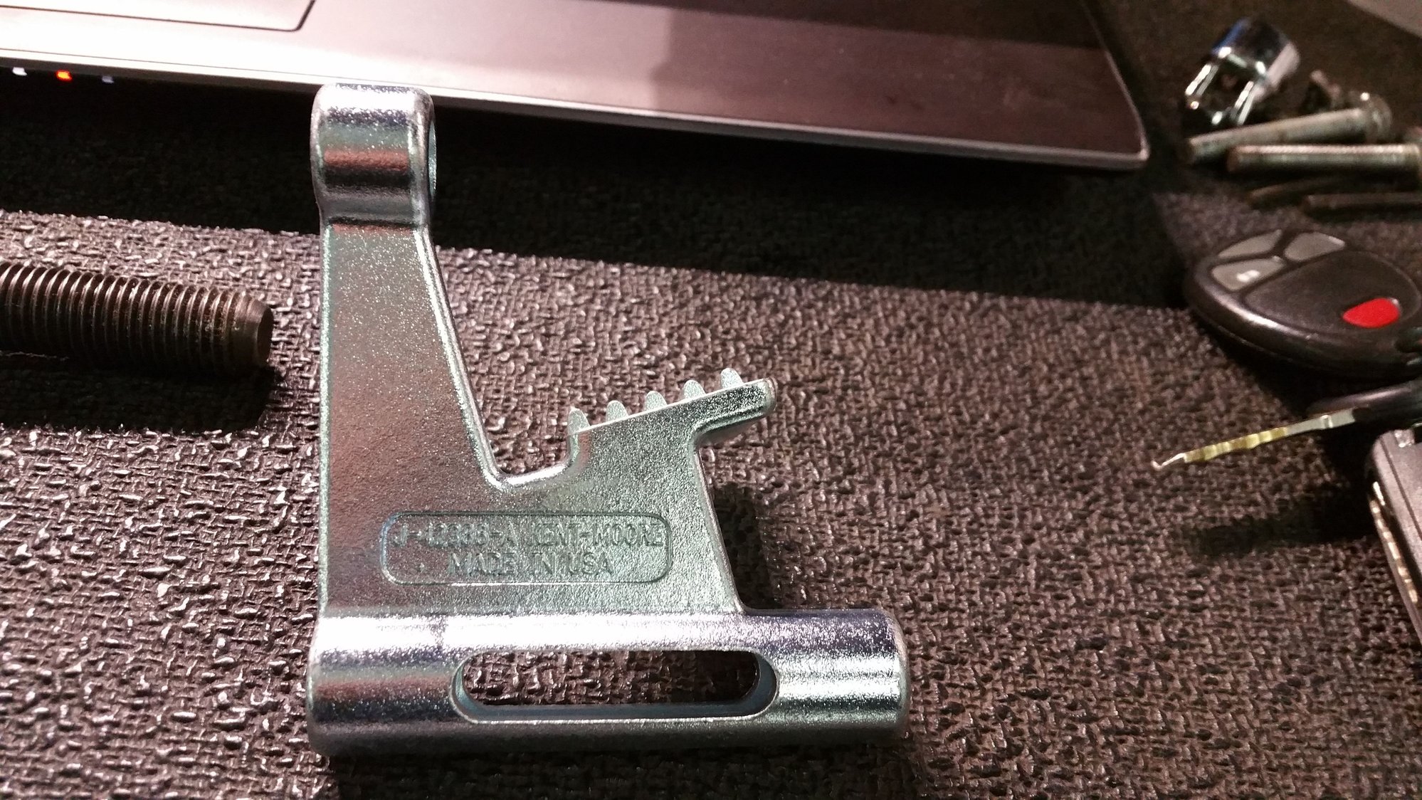

You'd need the following;
-a puller (mine is a blue-point)
-install tool (hawk has a great one)
-Flywheel lock tool (kent-moore) *some just put the trans in gear i didn't like that.
-Torque wrench that can also do angles
-and a new oem bolt

Looks like that flywheel locking tool goes in place of the starter? Is starter removal a hassle?

As for the locktool. Yes it goes in place of the starter. Starter is 2 bolts and it's out. You just need to move it back enough to install the tool using the starter's bolts. leave the starter wire up if you can.

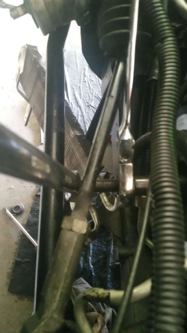

I just did a C5 balancer and tried something different and I cut labour time by quite a bit. I removed both wheels, both outer tierods. Then i removed the boot on the passenger side of the rack and removed the inner tierod. I removed both rack and pinion mounting bolts, then the steering joint bolt and removed it (lock steering so it doesn't turn) I was then able to move the rack up and work it up and away to have full access to the balancer and left all lines in place leaking not a drop of fluid. I think there is a good chance that may work on a C6. removing the inner makes the rack much shorter and gives you clearance. took me about 1.5 to 2hrs max for the complete job out the door instead of the 3.5hr book time.
On mine I removed both outer tierods, mounting bolts, steering lines, cooler, and steering shaft. I twisted the rack and worked it all the way to the driver side to clear the tierod on the opposite side(passenger) and then lifted it up. I'd try to first C5 method because they skip the line work. worst case I'd do both inners if it doesn't work then i'd have plenty of room.
oh when I say removed outer tierods I mean just from the spindle.

If you only unscrew the inner leaving the outer untouched, then screw it back in (use loctite) you can get away from an alignment in my opinion.
I have the z06 so I have that big cooler as well. I didn't do it that method, it was an afterthought that I later tried on the C5. If I ever do another c6 I'd certainly try. Unless someone else does and says nope. Lol. Then I'd try removing both inner. Not having the oil lines touched was a high bonus and saved me the 1.5hr worth of book time.

Mine did the exact same thing. It was fine to over 130K miles while NA
HOWEVER, as soon as I added a supercharger, it came apart (literally within minutes of starting it after the install). It took out the connector on the AC compressor clutch when it went, and luckily I was just idling in the driveway when it happened. It started wearing into the front timing cover as well, but didn't do any real damage because I turned it off so quick. If I had been driving when it happened I imagine the results would have been worse.
If you do decide to replace it, Trick Flow makes one for < $200 that has been working well for me. The part number is C2501.

My oem HB had half the amount of wobble that your video shows. I had the belt chirp at cold start up that progressively worsened. My HB wobble increased slightly after S/C install which is when the belt chirp started. Installed an ATI HB and all has been quiet and wobble free.
Your video clearly shows that the seal between the inner and outer HB ring has failed, it's only a matter of time before further damage occurs. Replace it!

I'm leaning toward that...Not having a lot of success in convincing myself there's much upside to letting it slide, just a bit of trepidation in committing to it

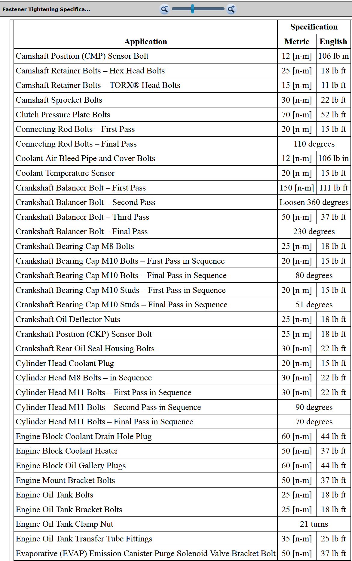

No don't torque the hawk tool. Grease the thread on the tool and it will go on like magic. you will know when its tight than back it out.
On your oem crank bolt. Apply a bit of grease to the threads, under washer, and between bolt head and top of washer. no loctite
1st step torque to 111ft
2nd step Back off bolt 180 degrees
3rd step torque to 37ft
final step tighten 230 degrees
here's the torque list for your cam job, and here is a link to the heads and cam swap i did on mine. it will have good info even though your not touching the heads
