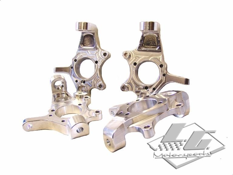

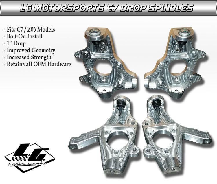

Brake mounting points are different so the brakes do not transfer over, at least not without some sort of bracket, which I don't know if there is room for.
The spindles might transfer over but the C7 uses a completely different wheel speed sensor setup than what the C5/6 cars do, also the rear tie rod linkage is completely different. I don't know about upper and lower arm mounting locations if that would transfer over but doing a spindle swap would not be easy to do.
I'll use our drop spindles to show the difference as I don't have stock ones pictured on my computer.
C5/6
C7
