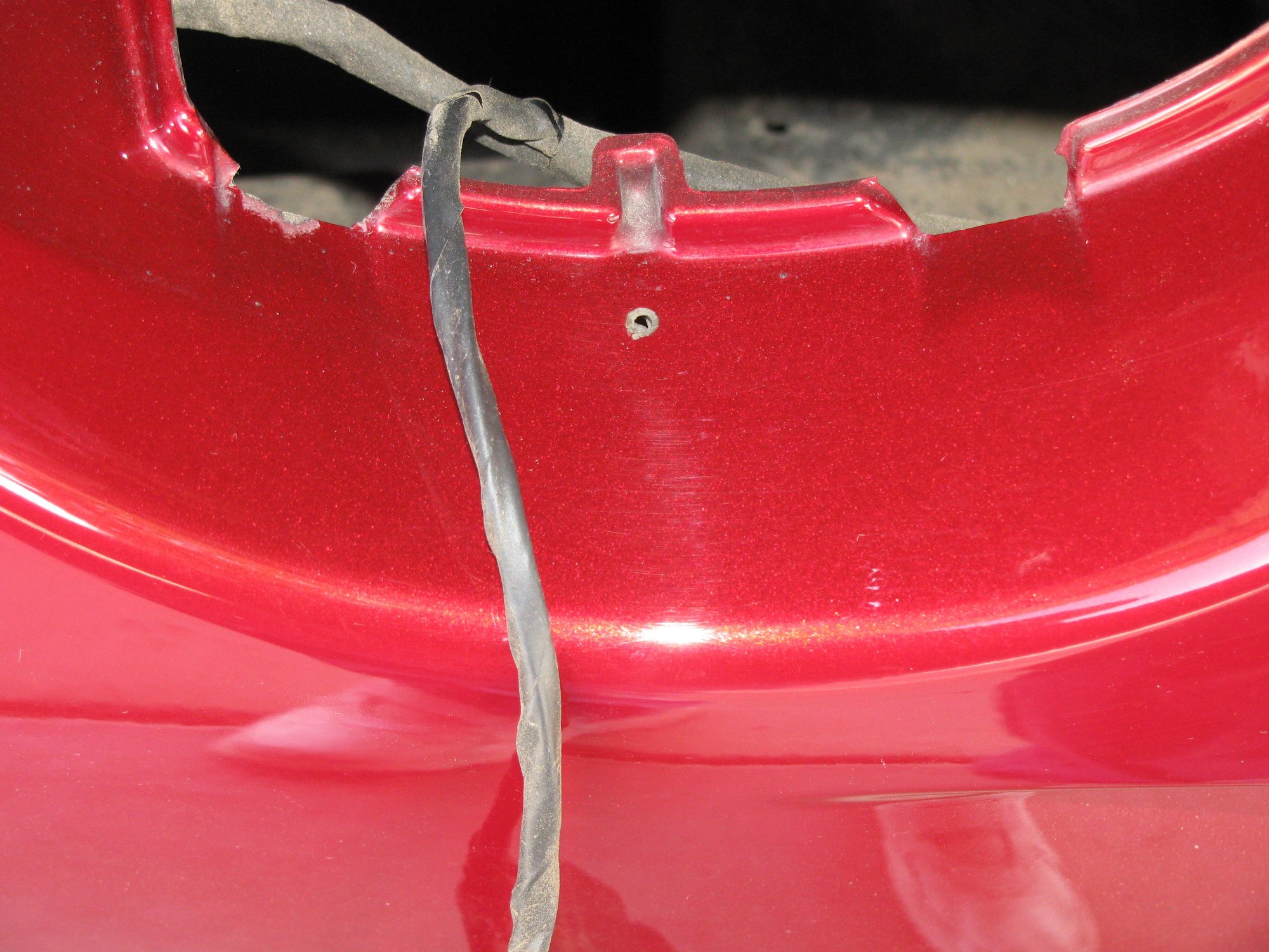

When you take out the lights, you'll see a dirt spot where water has pooled. Drill a 1/8" or larger hole at the center of the dirt spot to let water drain out. You'll never have drips down the rear bumper cover again.
