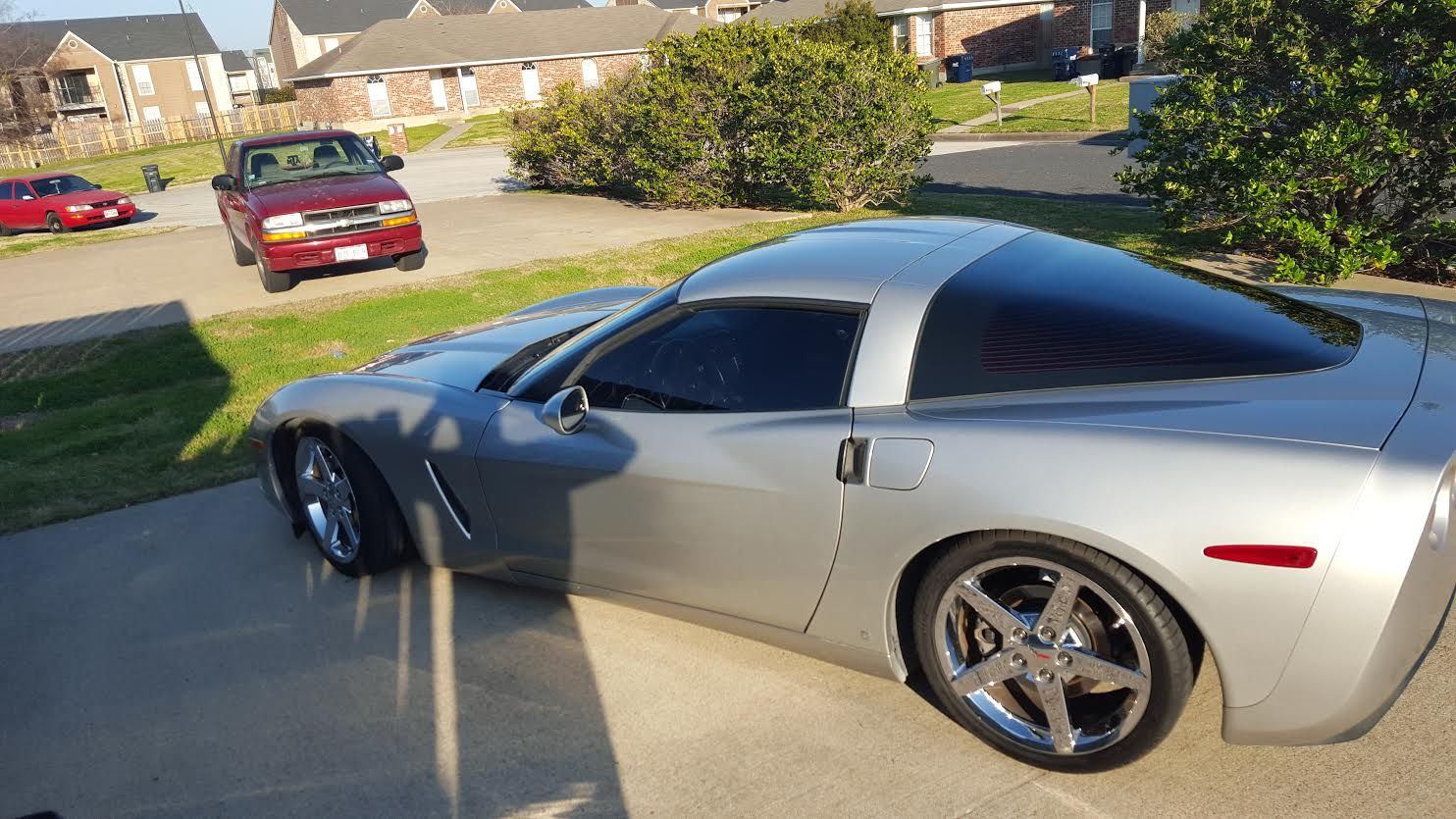

Alright, I've been trying to figure this out, and my friend google has been giving me strange and contradictory answers. It's two parts.
1. Car is obviously not level. its at least 2 inches low on the drivers side.
2. I hear a kind of squeaking noise coming off of that side of the vehicle. It sounds like... what I would call a rusty spring when it hits a bump in the road.
I don't have a garage, so I've got the car, my daily driver, under a cover. I can get it onto my buddies lift after hours, but I have to set up a time, and I'm also new to vette's.
Any help would be great.
Oh, and from my searches I have heard everything from bad shocks (wouldn't make sense to me, as shocks are there to keep it from moving, as opposed to actually holding it up), a ride height adjustment bolt, bad bushing, and a transmission mount.
Those are a LOT of things to track down in one night. Anyone have a similar issue?

I will take a look at the leaf springs. I've had the tire off while changing the brakes and didn't notice anything wrong with them. If they were severely damaged wouldn't it be a lot more pronounced? IE tire at a bad angle, a lot more clunking around as the shock hits the end of the tube, etc?
Tire in question

Yup, looks just like this one:
https://www.corvetteforum.com/forums...ing-today.html
And 3 more just for info:
https://www.corvetteforum.com/forums...nt-spring.html
https://www.corvetteforum.com/forums...plintered.html
https://www.corvetteforum.com/forums...af-spring.html

You guys were right. Cracked leaf spring. I don't know what magic the dealership used, but I've put in 8k in part replacement in 4 months.
Transmission, torque converter, battery, rotors, shocks, now this. Where's the throwing a wrench emote?

As an update, the rear monospring itself was just fine. The problem was the bolt that holds the bushings or whatever you want to call them. It had sheared off. I actually picked up the whole monospring and the replacement bolts thinking I would just replace them all. Once I got it up and got the upper a arms and shock detached, I saw there weren't any of the leveling pads (?) on the drivers side.
Long story short, threw the new bolts on, and it sits level and no more squeaking. Rides a lot better as well, because the shocks aren't maxed out. Anyway, wanted to say thanks for all the help.
