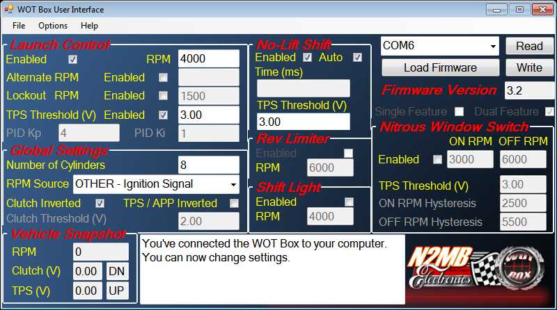

Once you have all the wiring correct you need to make sure box is programed for your car, mine wasn't but it was suppose to be and also I had to go in and make changes to tps voltage and other settings, it should come with a cable to hook to computer to bring up this screen so you can adjust settings
hopefully you will get it working I really like the no lift shift feature!
