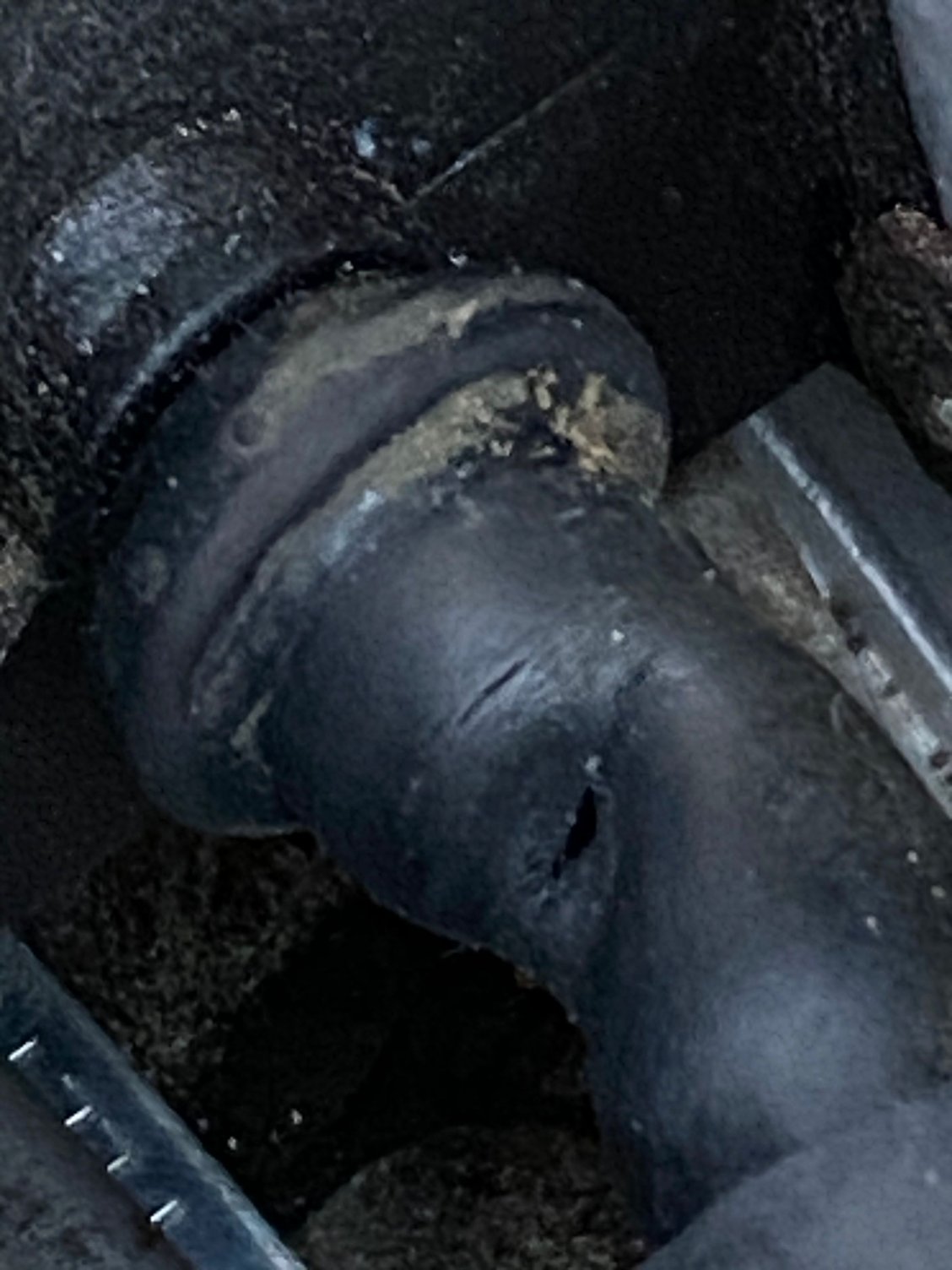

Originally Posted by Joe_G
That's a vacuum leak code most of the time. Retrace your steps installing the air filter...did you remove the air cleaner? Perhaps not get it fully reinstalled? Knocking a vacuum line off normally won't be enough of a leak to set the code, the code comes up when the car needs more than 25% of fuel added to maintain stoiometric.
Sometimes folks will get their air filters too oiled and the oil fouls the maf sensor. Any chance this happened? You should probably pull the maf and clean it with maf cleaner but be careful it's a sensitive device with thin wires down in there.
I was getting po171 code and every time I’d clear it would come back about 3 days later. I found a hole in the hose on my PCV valve on my 2001 base corvette. Replaced the hose and cleared the code....no more problem.
