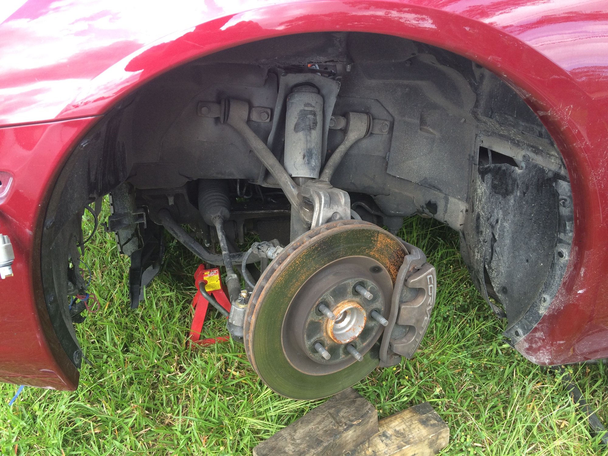

Uploading from my phone. Crossmember is bent right where it allows the lower suspension bushing to mount.<br ><br >

Hope I'm right and the crossmember took a direct hit at the bushing mount/alignment adjust point and that is the extent of the damage.

upper control arm to me looks bent/twisted, but might be a visual illusion.

Before I tore the car down to replace the cradle I would make very sure the cradle is the culprit. Its a very beefy component, especially compared to other front end components.
