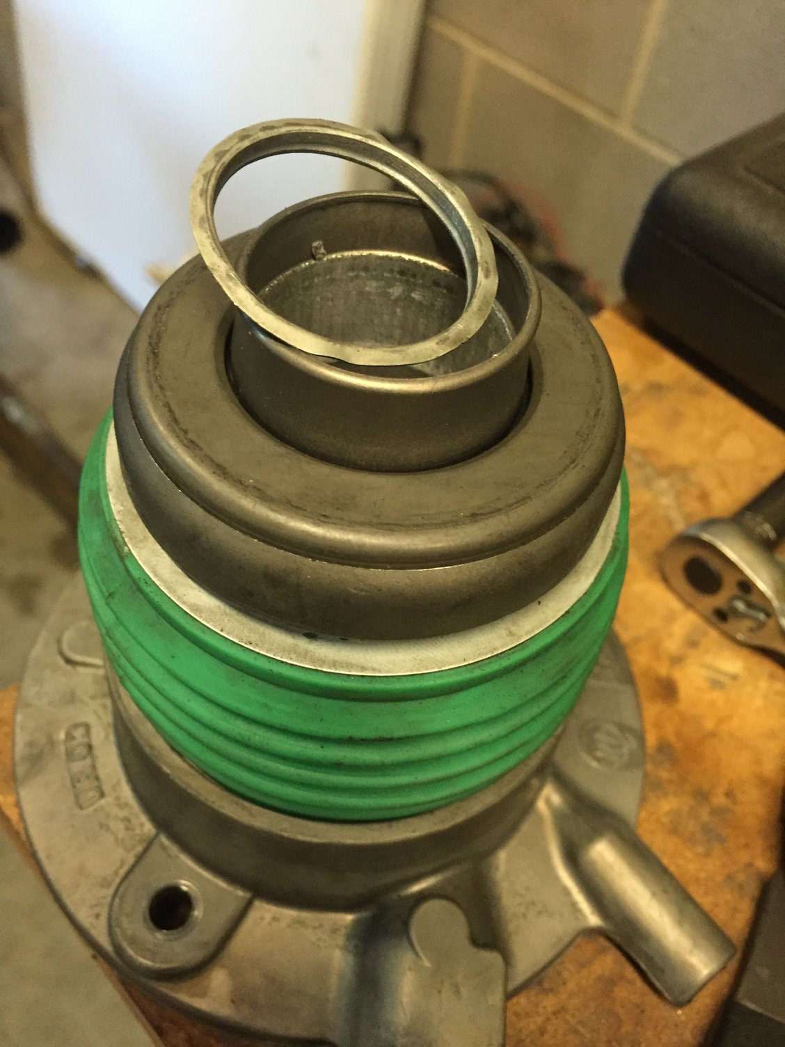

Old Jun 20, 2016 | 09:36 PM
  #55
GeneSch's Avatar
GeneSch
Joined: Aug 2014
Posts: 1,019
Likes: 30
From: Mentor Ohio
Originally Posted by Dano523
.126" has you in the correct clearance range.
So would dare to guess if everything else check out fine, it was just the heat range of the clutch and how you where using it, that caused the plastic race support melting failure instead (which the metal race support will solve that problem).
How do you get the small retainer ring off with out damaging it?
Old Jun 20, 2016 | 09:41 PM
  #56
curtisb23's Avatar
curtisb23
Joined: Sep 2014
Posts: 1,774
Likes: 38
A flathead screw driver just pry up it comes rite off
Old Jun 20, 2016 | 09:51 PM
  #57
schpenxel's Avatar
schpenxel
Joined: May 2004
Posts: 16,667
Likes: 1,209
From: Raleigh, NC
St. Jude Donor '15
Yep.
I put a tiny bit of JB weld on mine during re-assembly. Not necessary but made me feel better. Just don't get it on anything bearing wise.
Just be very careful getting it off. Can't get another one without buying another slave (though you could use the one off your old slave if you had to)
