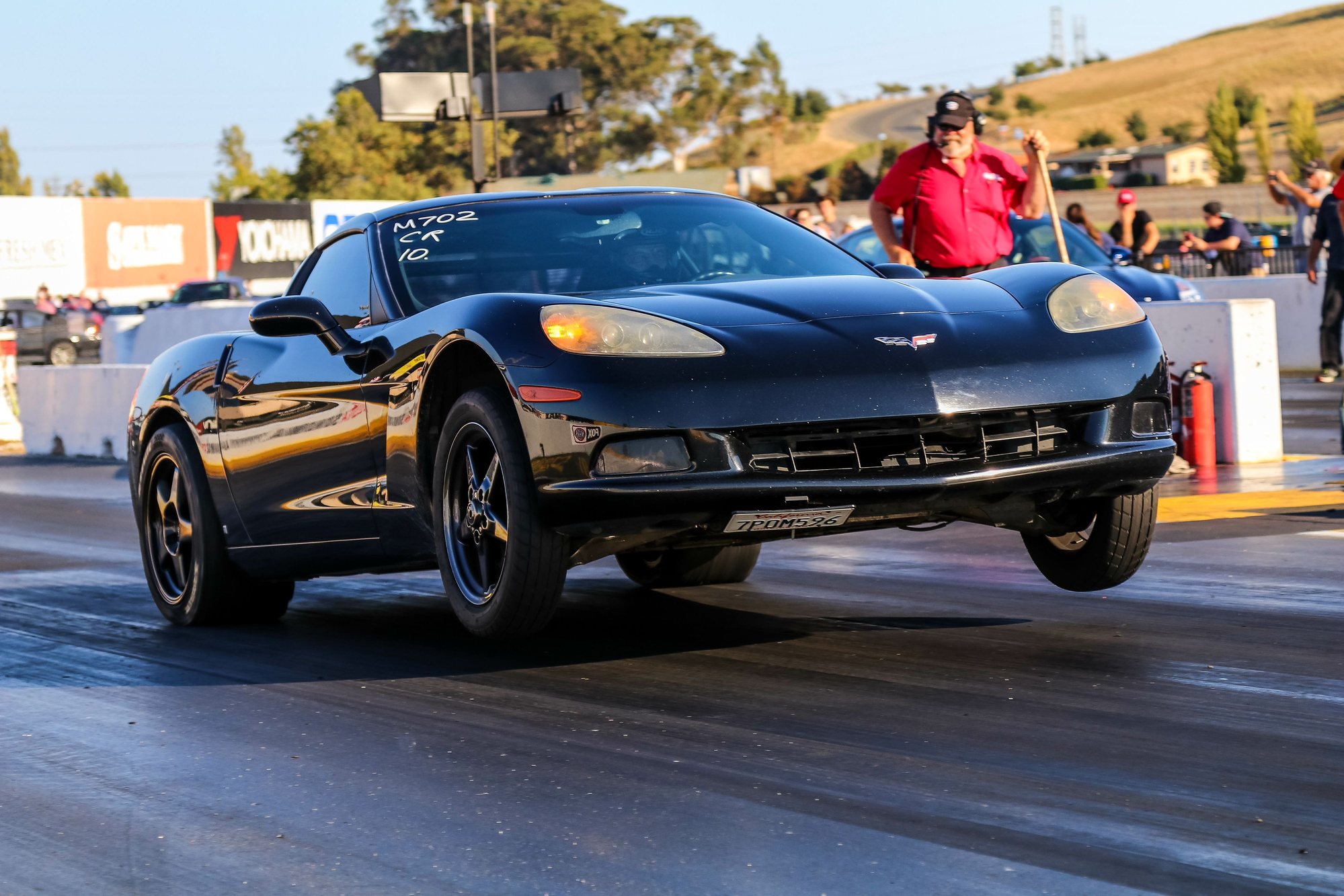

Default How much harder do you need to leave???
1.351 60ft, foot braking and launching at 1900RPM with an MSD 2Step:

While I'm all for innovation and stuff, as I stated two years ago I'm not sure the benefits are gonna be worth it. This was from last Sunday morning and as you can see my car launches just fine off nothing more than a 2-step (set to 1800RPM this time) and foot brake:

I hear you and would tend to agree that a transbrake will have limited utility on a 6L80, given the low first ratio.
Your car certainly looks and performs like it’s launching off a transbrake at much higher rpm. Wish I could get mine to leave half as good as that. I’m still trying to dial in the DA Viking coilovers on my car.
I’m very interested to know what gain you’ve seen with the 2 step, other than consistency?

Yeah, there were no gains to be had, it just helps me cut better lights.
I found that 100RPM up or down makes a difference of about .030 to my RT so if I'm redlighting or leaving late it's a simple adjustment to get back on track.
