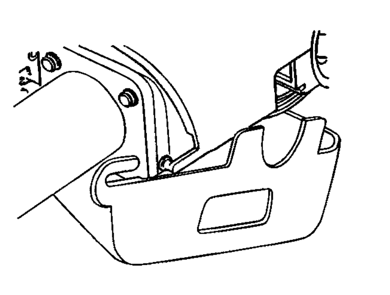

tried to upload a pdf. let me know if you can't see it
File Type: pdf

Yes, the uploaded pdf is accessible. Wondering if you have the instructions for removing the cowling for the tilt/telescoping column shown as a separate item in the procedure you uploaded? (hoping I don't have to remove the steering wheel as is shown in the pictures)
Thanks again. Very helpful.

Steering wheel is easy to remove, do not fear it.

yeah the oem r&r procedure says to remove the steering wheel. I think you can probably do so without. But if not its quite easy as mentioned above
