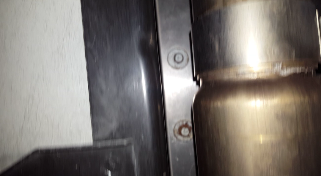

Sorry about the quality, got my phone under the car to try and get video. This shows x-pipe on bottom and mid-pipe on top. I assume this is what a 3" to 2.5" reduction looks like?
If this is a 2.5" reduction on the x-pipe, then I was quoted about $632 to get the x-pipe (2.5" reduction version) with cats plus about $60 shipping. The angle I'm leaning on here is trying to determine if there might be a market to sell my non-cat'd x-pipe after I get this in and recoupe some of the costs. I'd still need to get them on, and I presume they're all supposed to be bolt-on, but I also don't have the tools to do it. I'd hope / assume it shouldn't be difficult to do.
Otherwise, I'm looking at about $600 total for someone to put a couple high-flow magnaflow cats in the existing system and nothing to try and recoupe costs with. Thoughts?

Old Oct 13, 2016 | 03:59 PM
timd38's Avatar
timd38
Joined: Aug 2005
Posts: 13,592
Likes: 187
From: Hudson WI
Go to the sale section and see if you can find a used one for sale.
Worth a shot!
