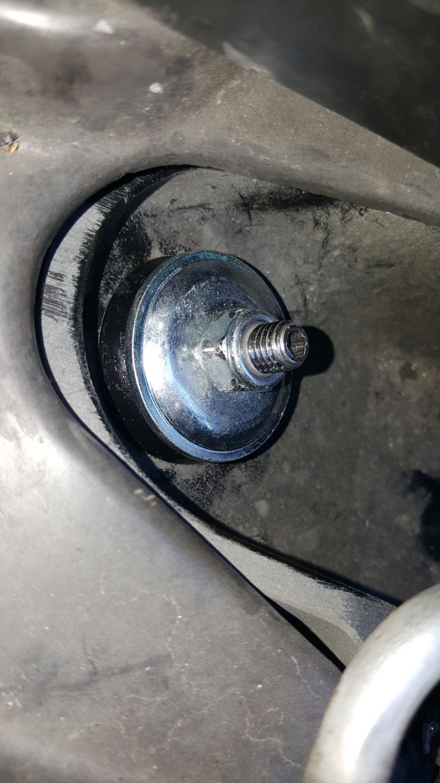

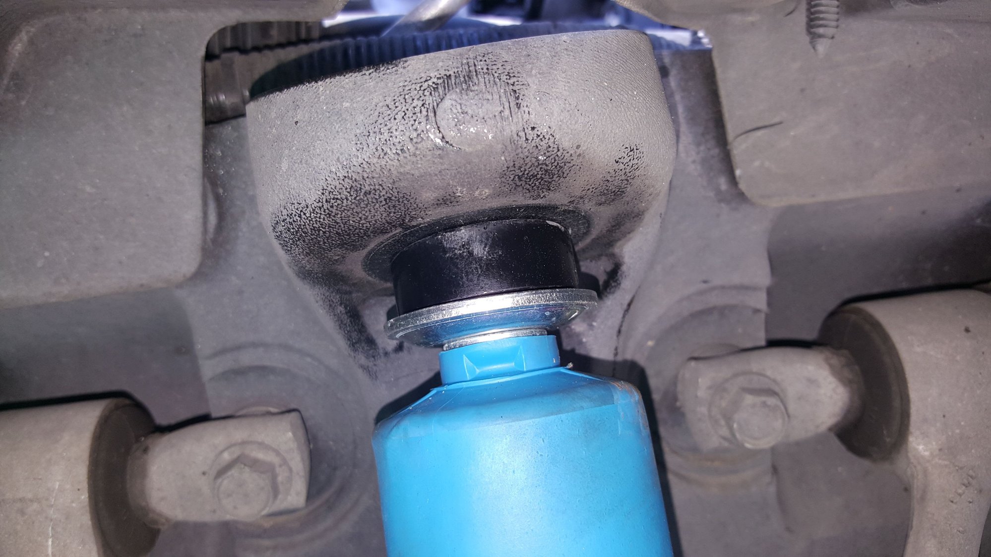

How much are the bushings supposed to pooch... this is what it looks like under its own load in the air

After re reading the thread, i backed them off and now this is what they look like with car on the ground

1st pic was over-tightened. Last pic looks good.

yeah i didnt like it, then i read the thread again. after i got one side looking right i counted threads and made them match
