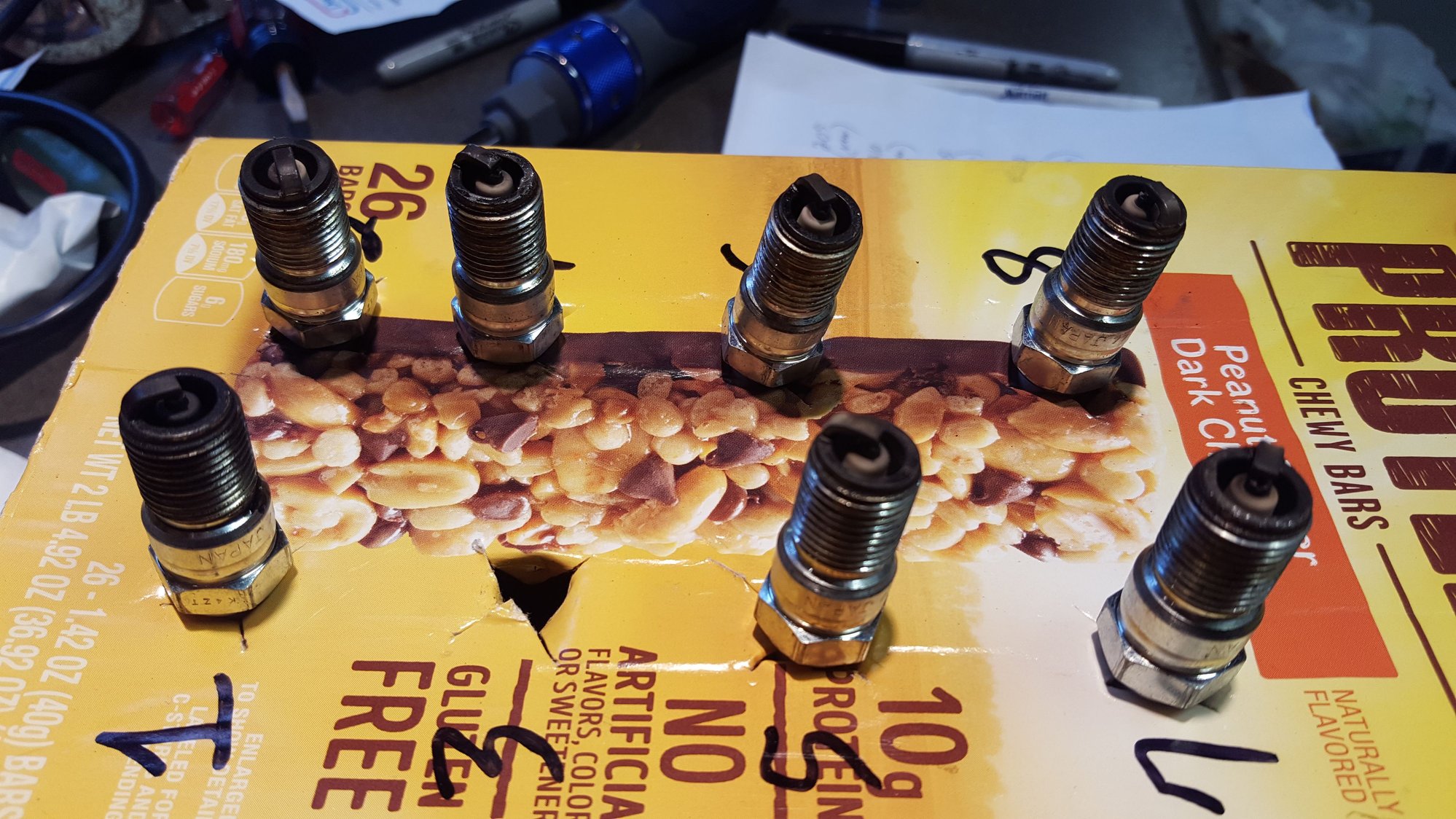

Originally Posted by timd38
I had a bad coil and got that look.
How do you test for that.....supercharged motor( fyi)
*Car was running great*

Compression test results...
Old Dec 2, 2016 | 09:55 AM
BlindSpot's Avatar
BlindSpot
Joined: May 2016
Posts: 6,982
Likes: 1,546
From: Florida
I don't see any big deal with these compression readings. You're 8% difference. My first impulse, I am thinking you might have a fuel injector sticking at #1.

Originally Posted by C U IN REARVEIW
Never heard of either....where do I find these?
I would have the injectors cleaned before buying special tools. Those tools can be found online.
