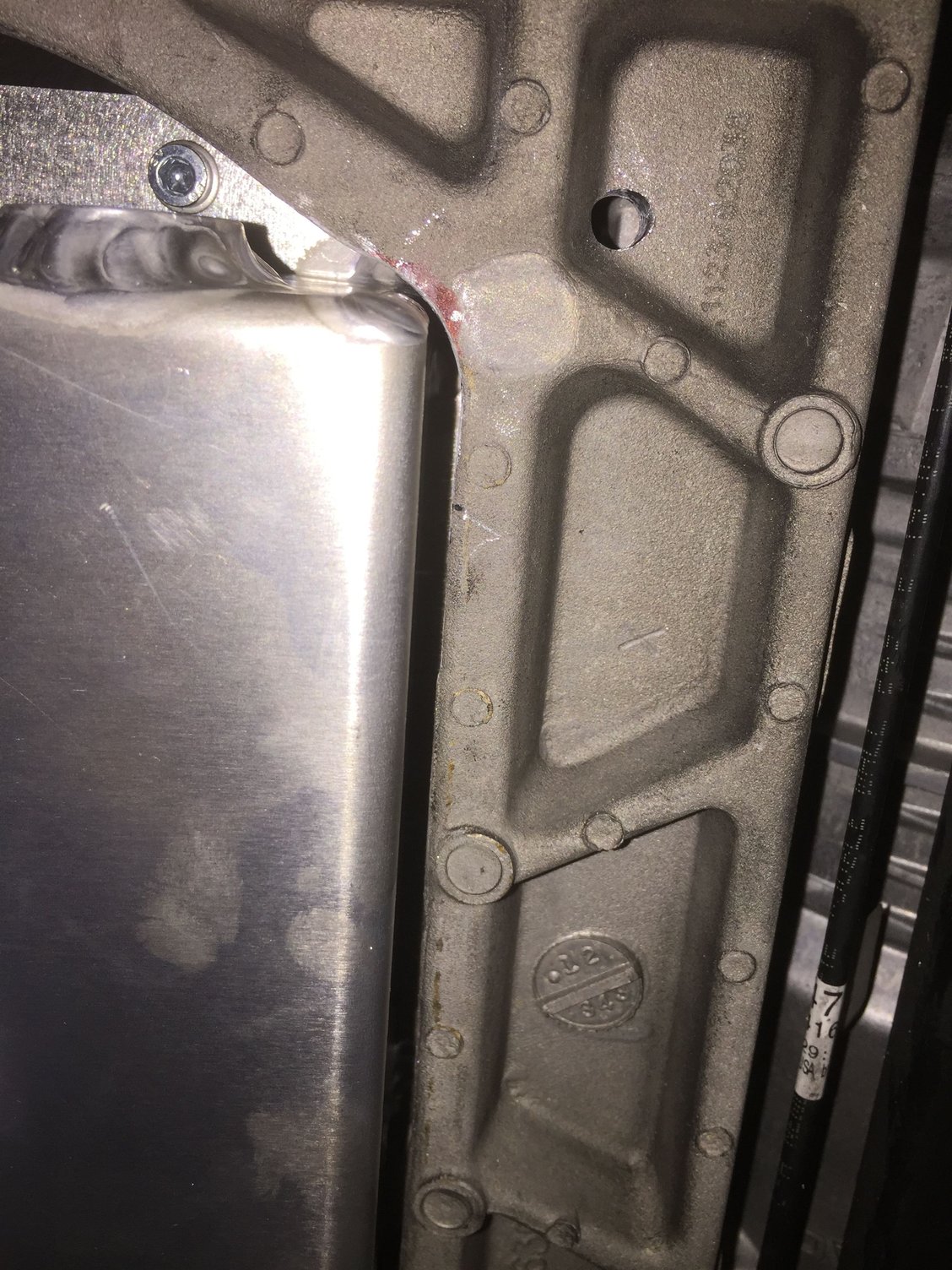

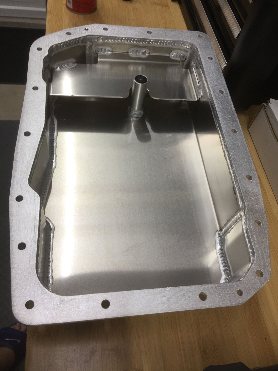

Yes, I still have the pan, and I’ve had zero issues with it after installing it.
It’s worth it, in my view, especially if you’re drag racing like I do, since the filter sits in the front of the pan on these transmissions, which means the fluid will tend to move away from the filter when you launch, which is why we typically have to overfill the sump if you’re drag racing with a high stall converter, since at the stock fill level, the filter will become uncovered when you launch and the pump will momentarily suck air, causing the car to lay down just after you launch.
This pan is full depth throughout and has a horizontal baffle in the back half to help retain fluid that would otherwise slash backwards and up out of the sump. Plus, it holds about an extra 1.25 quarts, which helps, in and of itself: not just fluid temperature, but the extra capacity in the baffled sump will help to keep the filter covered.
I don’t have any problems with it getting up to temperature, but it’s typically between 80-95* here all year round, so I can’t speak to what obtains in cold climates.
You can easily modify the pan itself to work by doing what I suspect they did with the LG pan, which is to cut the corner off and weld a small piece of aluminum on it to create a 45 degree corner. It’s not a lot of clearance that’s needed, so you could probably just build up enough welding inside that corner of the pan that you could grind the corner back a bit. I considered doing that, but was afraid to do so because of the fear that welding it might warp the pan. I suppose if it’s a competent machine shop, they could do the work easy and cheap.
Below are some pictures, including one that shows how much (how little, actually, I had to grind out of the corner of the cradle to get it to fit. Having polyurethane trans mounts made me confident enough to do this. If I had to use the soft rubber stock mounts, I would’ve probably taken some more material off it. But, I wouldn’t do this mod before changing those mounts anyhow.
This is the corner that hits the cradle
Anti-slosh baffle in the rear of pan
Here’s the amount of clearancing I had to do on the cradle.
