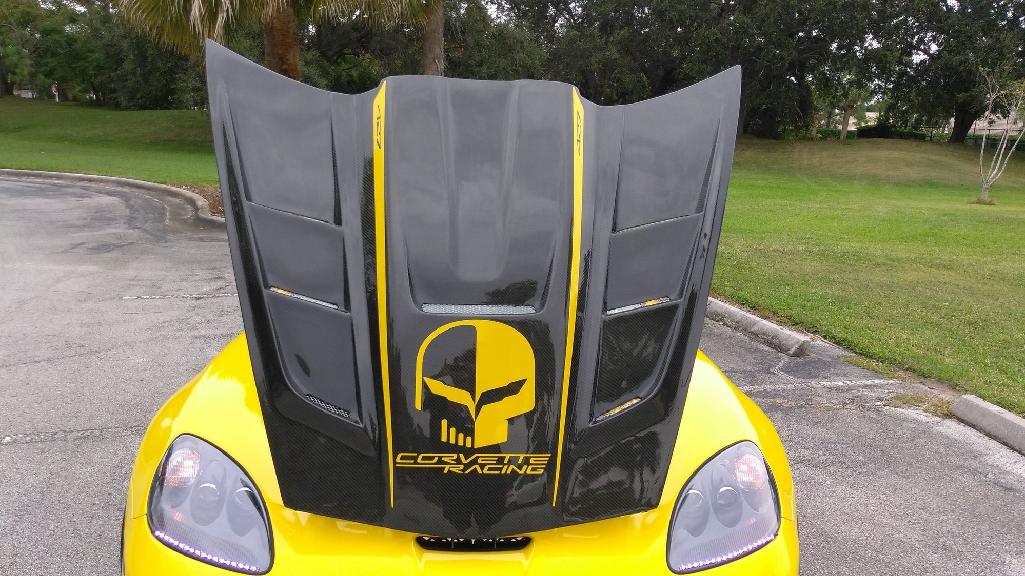

If you want to go the extra mile, buy the new Camaro SS hood vents. Put one on each side of your hood over the headers. That will go along way to reducing engine bay heat. They look good too.
