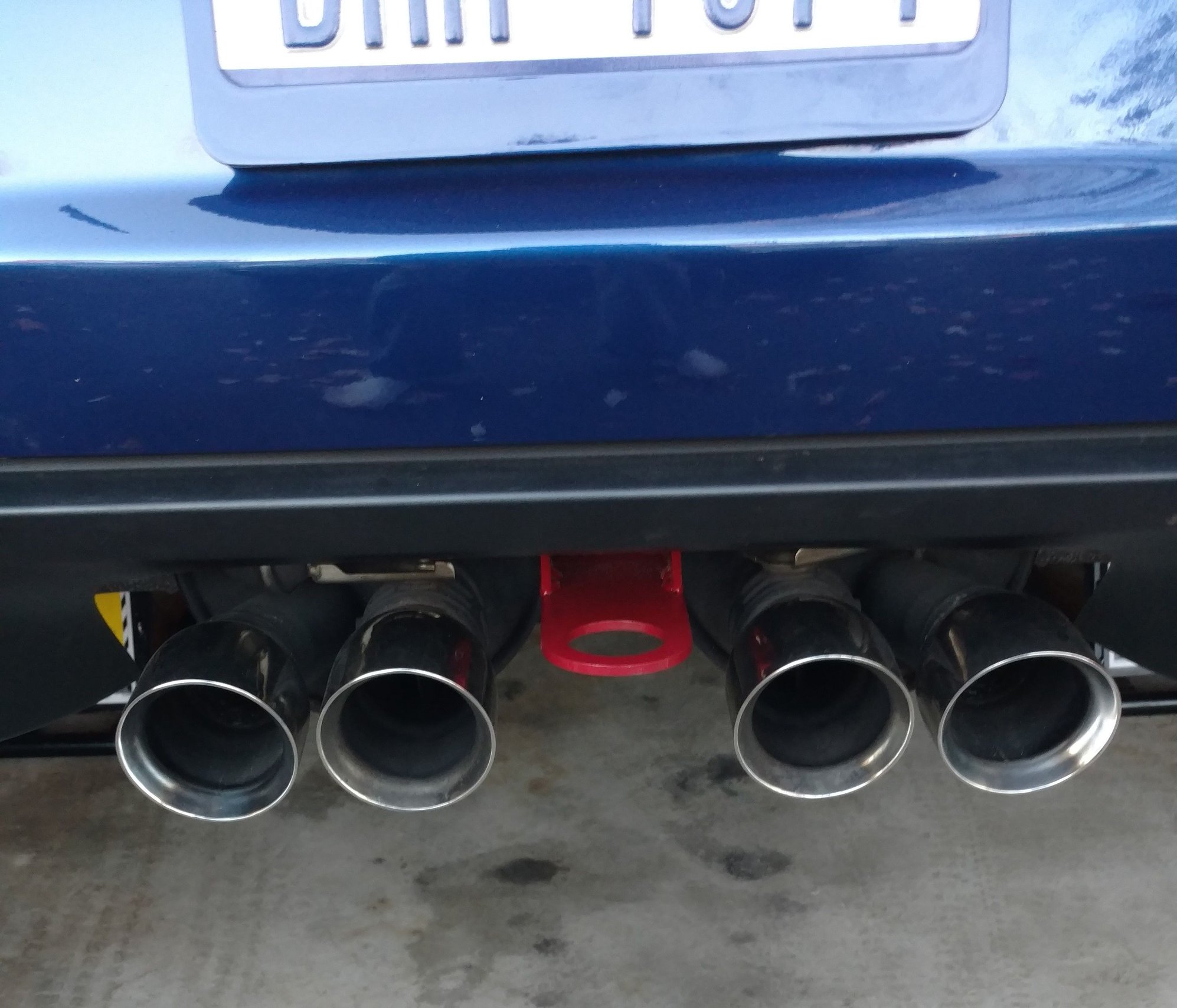

Rear is simple, it uses the muffler hanger bolts.
I looked for year for a simple front one and finally gave up and removed the bumper cover.

timd38's Avatar
timd38
Joined: Aug 2005
Posts: 13,592
Likes: 187
From: Hudson WI
Rear
Front

It is not easy to install either the front or the rear. I have done both personally on my Z06, which is similar to the GS. The problem with the rear is that there is only a SLIVER of room between the mufflers themselves and the spot that you bolt the tow hook to after dropping the hangars. The mufflers can only be pushed out of the way a little bit. So when you put the tow hook up there, the bracket takes up what little space you have to re-insert the bolt. After much swearing, I got it up on my lift and had to pry the mufflers apart and it still was a pain in the ***. Would have been easier to simply drop the exhaust I think.
