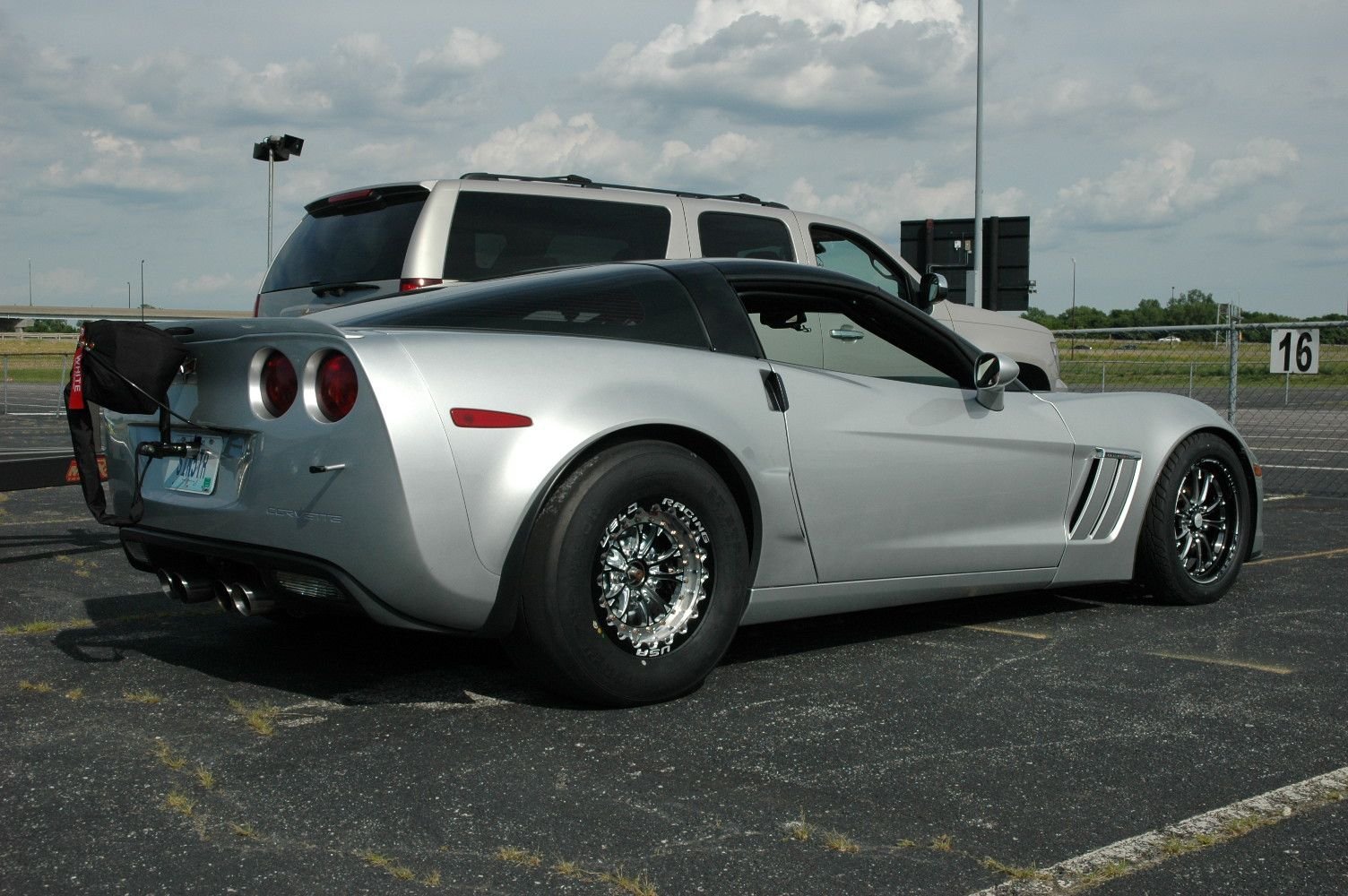

What rear suspension is on the silver base posted leaving pulling the wheels? It can't be stock stuff?

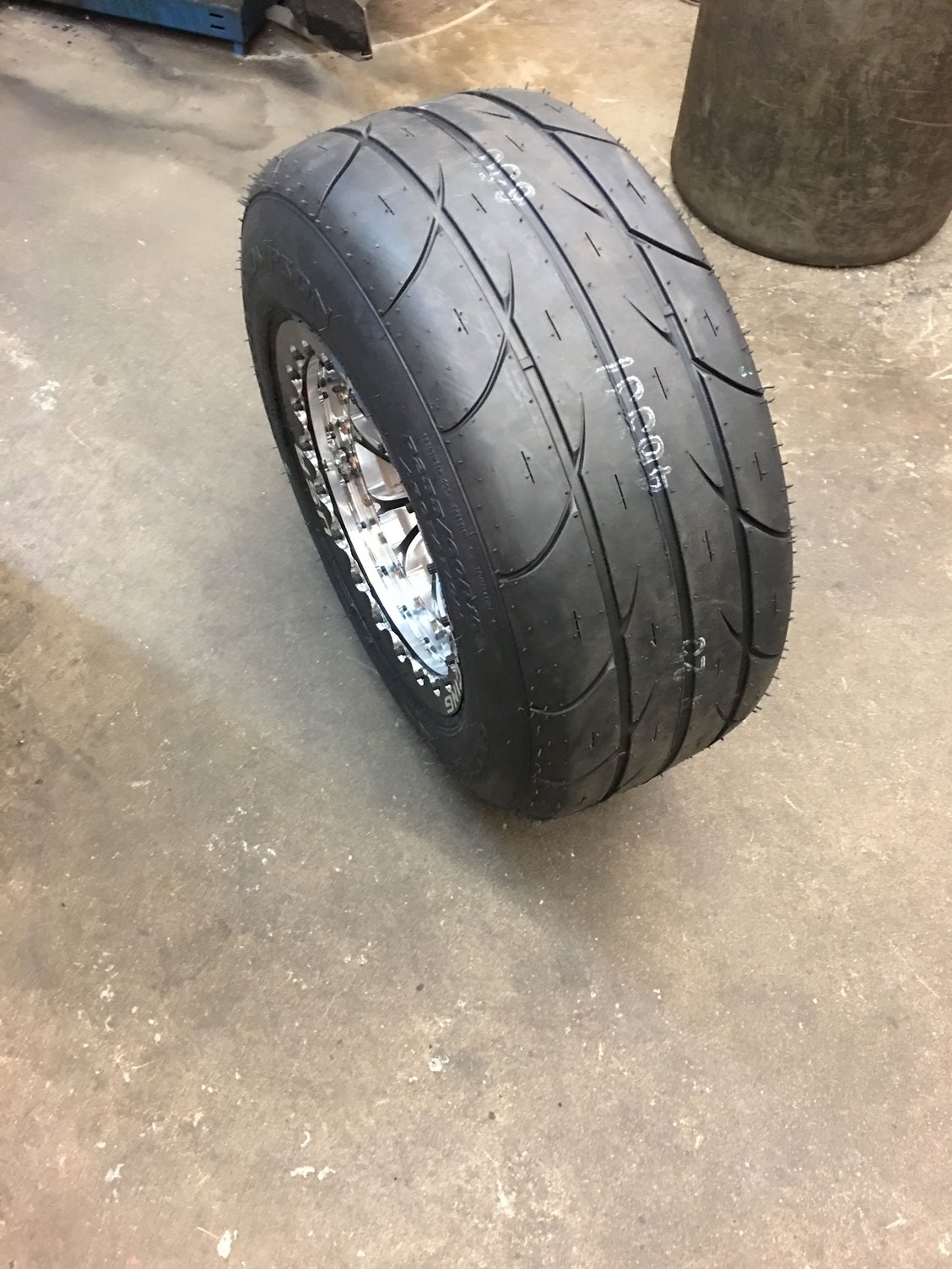

just picked up 255/60/15 from jegs and will have them mounted tonight, ill get pictures posted asap.

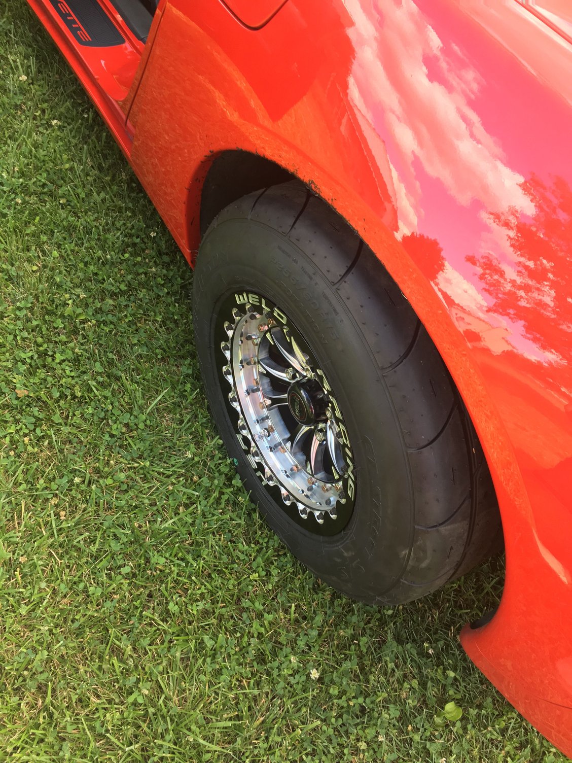

Here are the pics of the 255/60/15, I've got too busy yesterday to install with all the rain we got.

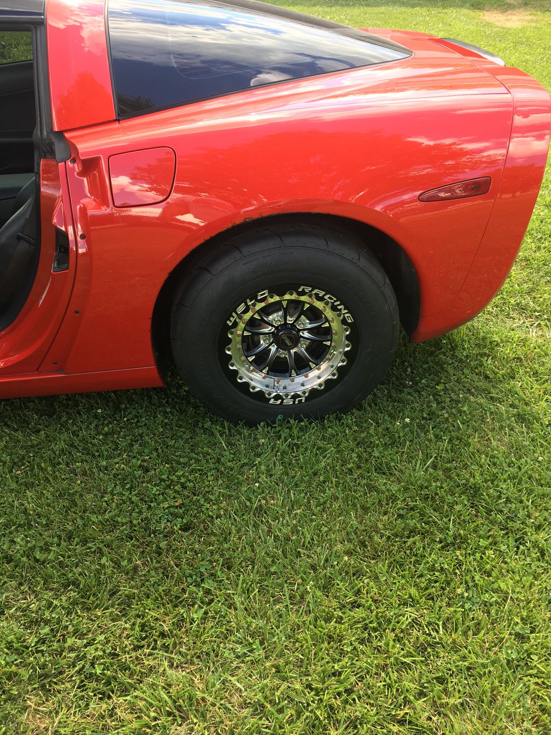

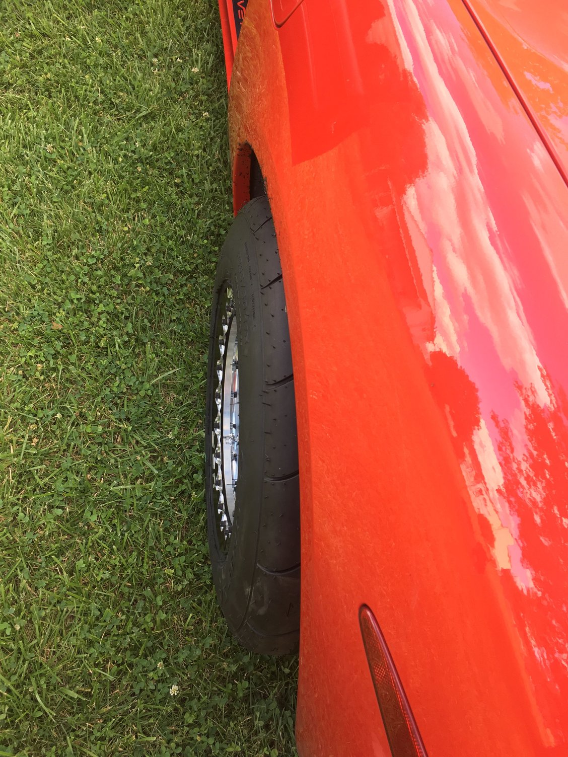

Installed my wheels on the car and It seemed to work great, no rubbing over bumps. I'm gonna have an alignment performed and will have them pull the wheels in a touch more. Ultimately, I feel that I will convert it to widebody over the winter. I want to run a 275/60/15 for maximum traction. I feel that I could have stayed with a 17inch wheel and would have better traction than a 255/60/15 can offer.

Sucks forsure, I'm getting an alignment today with the hopes of pulling the wheels in more. I'll post after pictures.

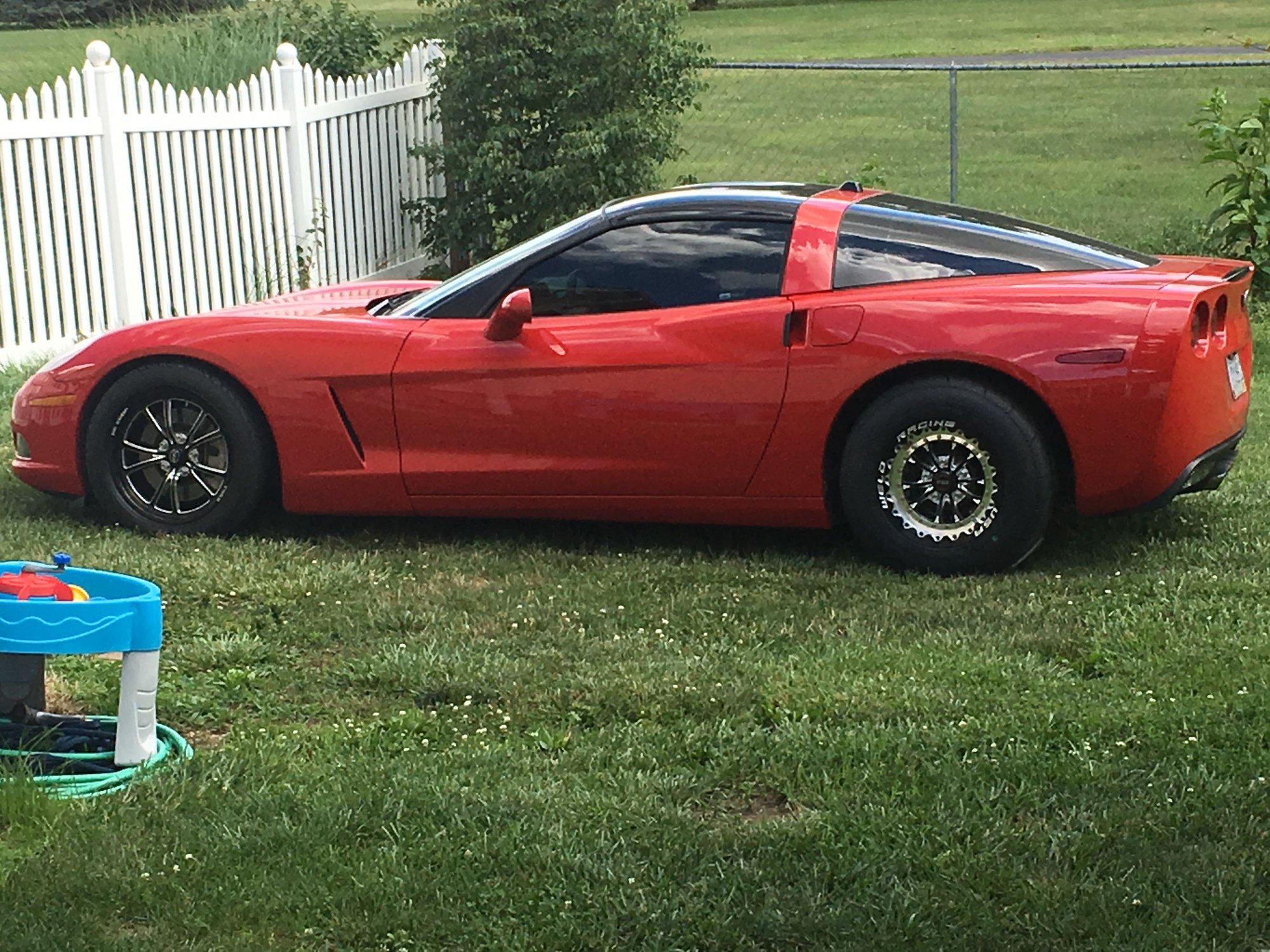

Yes or a shorter tire! We're still on the hunt for a 15x10 that will fit under the car. The tire height is what makes a big difference, my red vette has 27s. Most people with base quarters run 26 without any issues. I still have rubbing issues on hard bumps with my 27s, but I am stock suspension. I bet a coil over with a stiffer rate spring would do the trick.

it cant hurt! there's people running the 275 with base, but they haven't said how? My initial ride with 275 went terrible. see the pics on the first page. You cant narrow the rear suspension, it has to be stiffened up. The silver vette is leaving hard and will has roof. He's gotta have a coil over.
