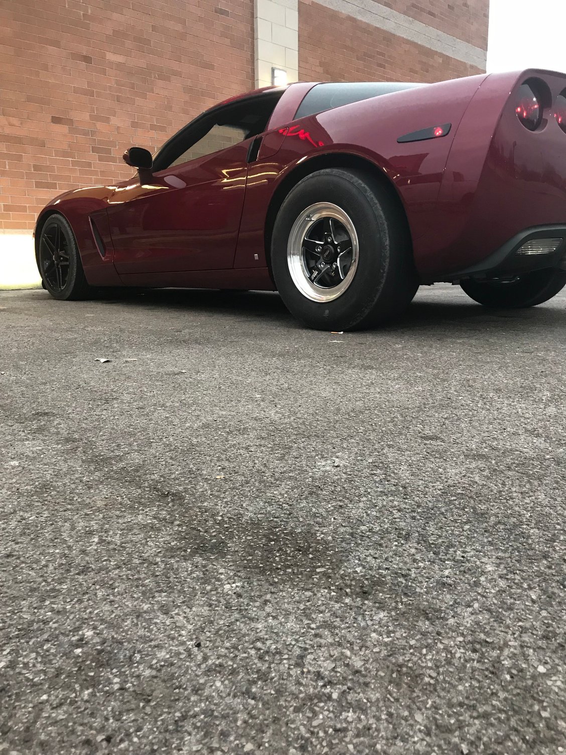

I didn’t lower it, I bought it with just an exhaust. It could ave been lowered before I got it? Here’s a side pic. I’m guessing it is lowered based on my front wheel gap.

if you raise it on the jack bolts a reasonably fitting wheel with 27" tire should not touch.what condition are your rear shocks in?you cant have it both ways.lowered car and tall tires

Who’s car is this? I know the silver zo6 is carter performance, but the two other base fender vettes had good size tires?

I have the 275/60/15 on my base car with zero rubbing issues, i would deff check your stock bolts to see if they ha e been lowered
