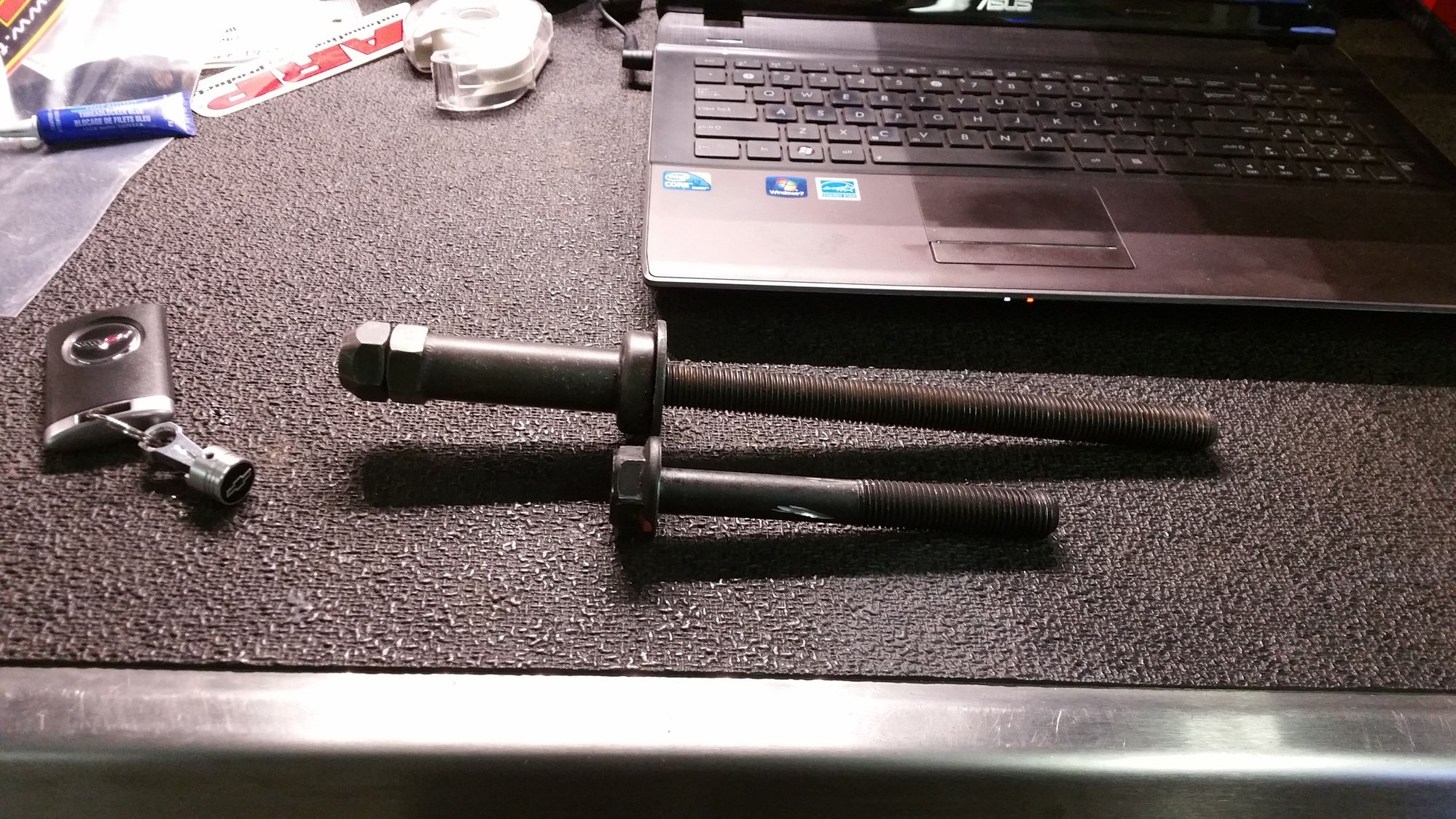

HB is easy to pull with a standard 3 jaw puller, but when you put the new one back on, do not use the HB bolt to draw it back on the shaft. the bolt will not enough thread engagement to the shaft threads, and you will strip the shaft threads.
You need to use a HB installer tool to seat the HB on the shaft, then you can isnstall the new OEM bolt with diamond washer and torque it to spec.

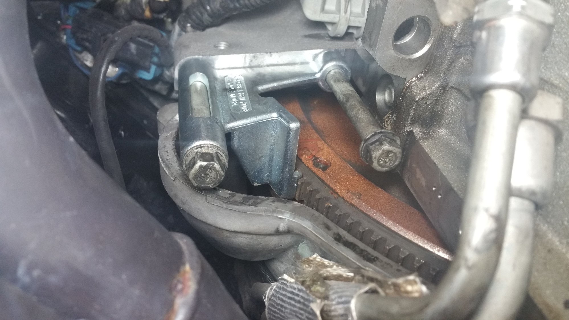

Also that comes in handy is a fly wheel lock.
