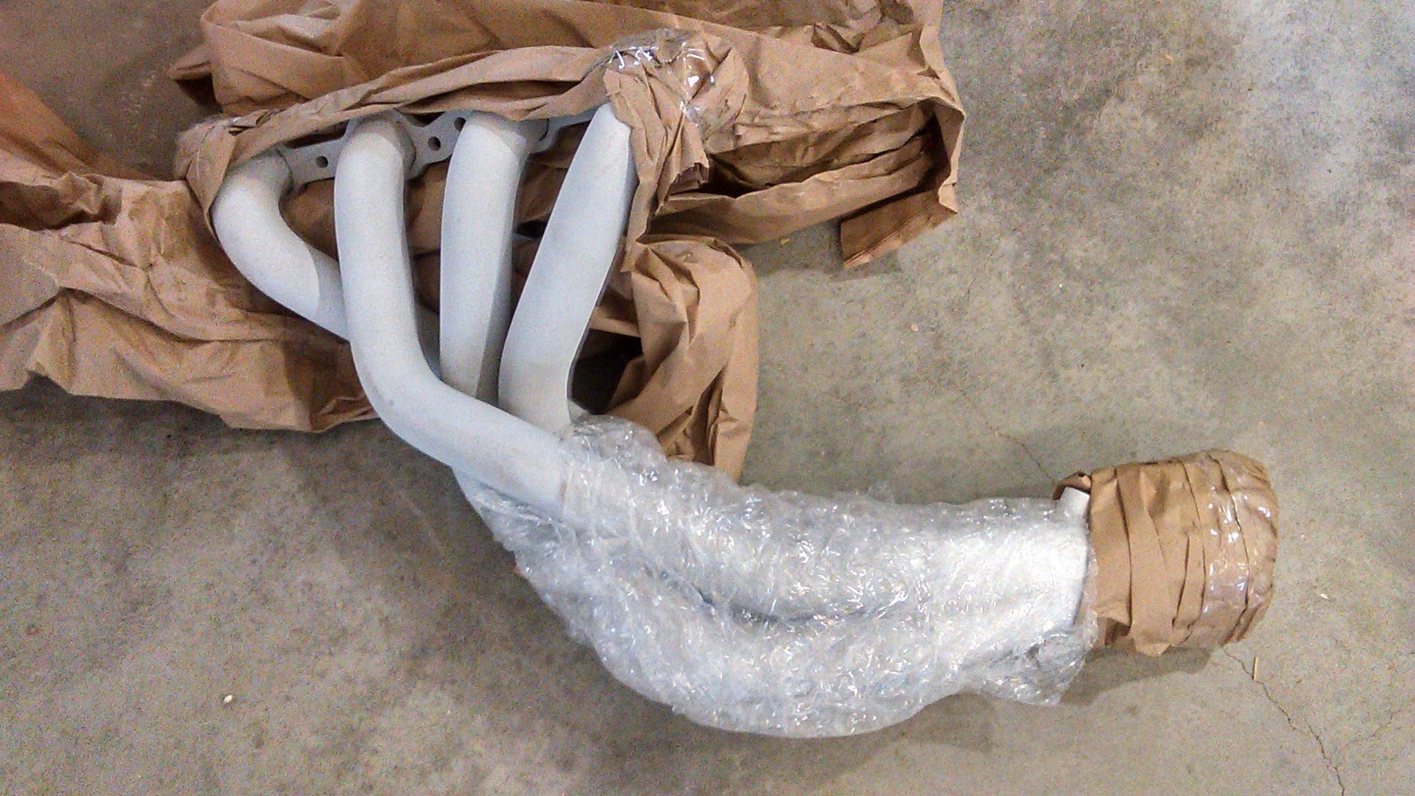

This is the only photo i have on this computor,but all eight are the same.I had these ARH installed at a perforance shop about six years ago which is a dealer for ARH, over the years they was sending me emails that they were making a new set for me.LOL..So much for their life time warannty Huh...ARH SUCKS if you get a bad set.

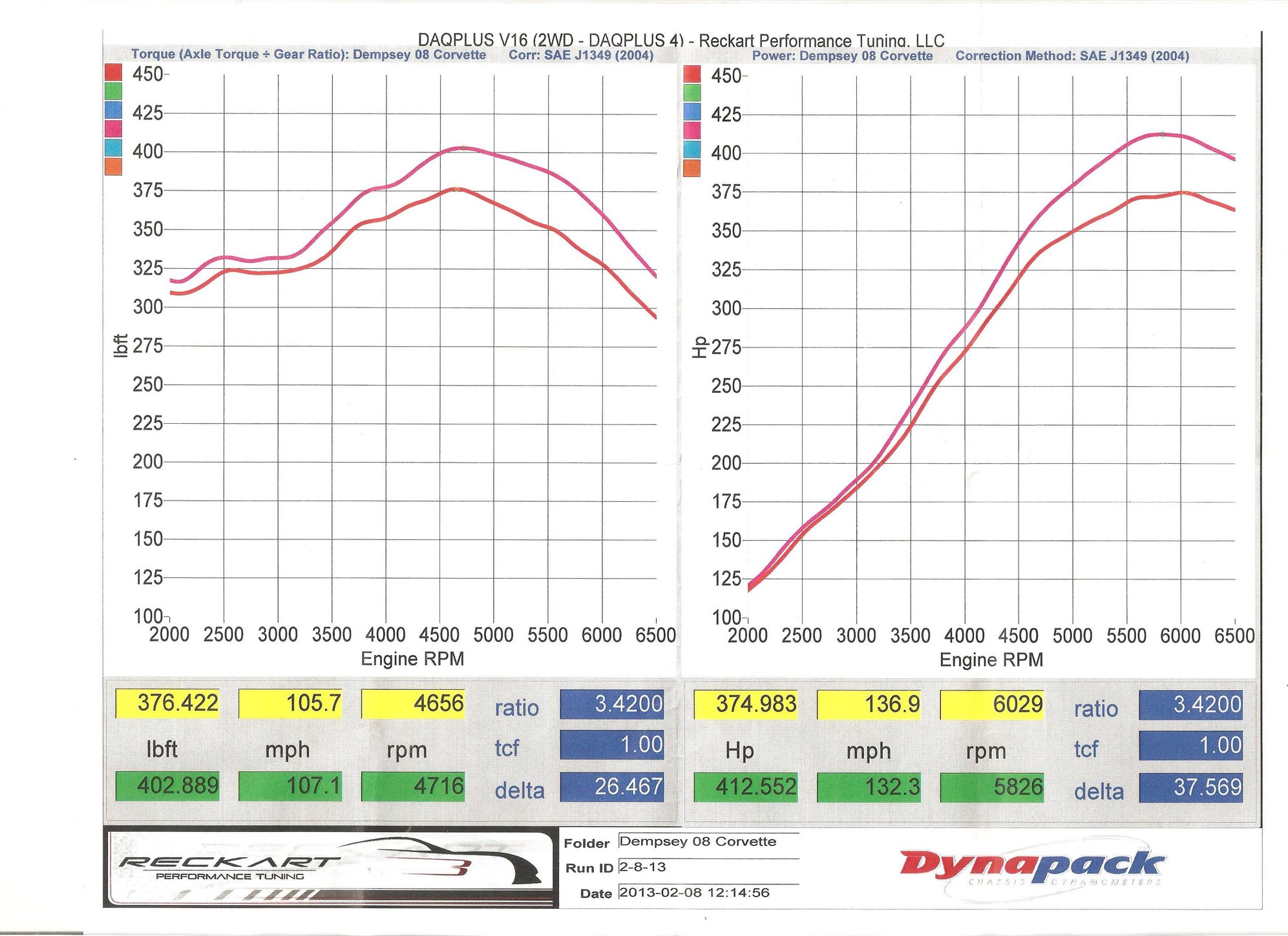

Sure thing... The '08 was on a Dyna Pack dyno. The wheels were removed from what I can remember & it was bolted up to the machine. I guess that it reads the output directly from the hubs...The '13 was on a roller type dyno (Dynocom Industries) ? I will include both sheets in this post.

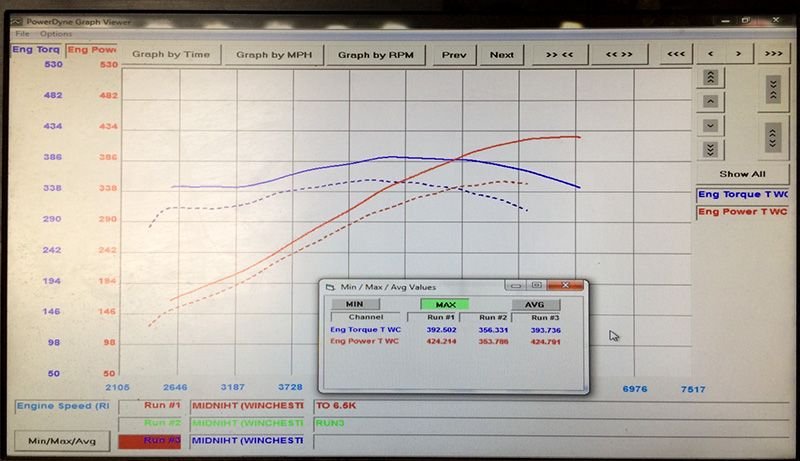

I'm almost hesitant to make this post. I finally made it to the dyno shop after the upgrade of a handful of items, most of which people have taken me to task on, suggesting I was wasting my money, as no power comes from such parts - missing the larger picture in my opinion. That plus a great set of headers, and 93 Octane gas, plus tuning via Diablo Lew, and we got some pretty great results. The tuning shop had no problem with the numbers once they heard what I had done, and were really interested to have me add a cam to the mix.
Numbers: Baseline peak torque 358, Baseline peak HP 354
Headers + tune peak torque 394, Headers + tune peak HP 424
Graph (dotted lines are baseline, solid are after headers and tune):
We talked about how stock HP for the car is 436 (at the crank, from GM) and he had an option where crank HP could be estimated and it turned out to be 564. Won't make much of this estimation.
Two things stood out to me. As soon as we did the first run, other guys in the shop came over to see what was making so much noise*. Second thing was that the C6 owner running the dyno was really interested in my CAI and the header system. (We knew the CAI had little impact in these numbers, but would out on the track, relative to other things we talked about.) This is a very established shop in our area, involved with autocross, road course stuff, and likely some drag racing work, too. We talked about their next trip down to Miller Motorsports Park, a place with a 4.5 mile road coarse that can be run several different ways. My wife and I were there to see the American Le Mans and it's supporting races run there, many years back.
I post this info for your info. Conclude what you want. I was content that the choices I have made to date are doing what I hoped, increased torque and horsepower, with more useable power at lower RPM. Based on the graph, we succeeded. My butt had already confirmed this, but it's nice to have some numbers to confirm it.
*Based on the sound and numbers, the tech assumed I was running some kind of after market exhaust, which I am not. I have the NPP setup. That means that we go from 3-inch pipe down to 2.5-inch to get into the stock mufflers. I had talked with LGM about this and it actually creates a bit of back pressure which can yield a bit more torque, while putting a bit of a limit on peak HP. I wanted to keep the NPP, so I could use the flaps to quiet things down, when needed. It's music to my ears, but not always for others.
Last edited by Midnight08; May 25, 2017 at 07:19 PM. Reason: Added bits about stock exhaust.

Nice numbers Midnight. Better than most with the same mods. Forgot, do you have an auto or manual?

It's the MN6.
FWIW, the tech I worked with shared my opinion that some of the other stuff, while not substantial, do address weaknesses that can show up at higher RPM.

Tickled pink for you Midnite, really am. I wished and hoped for your numbers or close anyways but it is what it is
I wish that some of the members lived close enough to one another to see just what a car that made what yours made do a side by side with one like mine that made dramatically lower numbers.
After much researching the subject of "Dynos" and the difference in the number they produce for almost identical car/mods it would be a great tool to maybe settle it somewhat.
Oh well good for you, you got the bragging rights bro Any video of the runs ???
