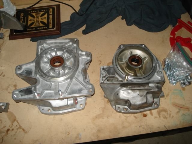

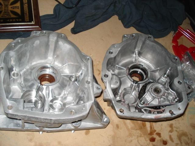

The bolt pattern or tail housing of the tranny. Totally different, along with the diff itself. The ribs/external structure is way different.
Old Sep 15, 2017 | 04:10 PM
RicK T's Avatar
RicK T
Joined: Sep 2005
Posts: 20,352
Likes: 568
From: Ventura County, Calif
'06 on left, '05 on right
Ooops, forgot to credit Walt White Coupe for the pics.
