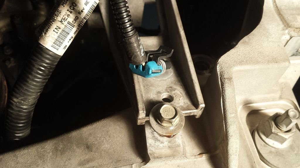

here is that pic. rack still in, did not loose a drop of oil. i actaully swap cams like this too, but then you need to remove the fan and rad for clearance but i still leave the rack in place.
